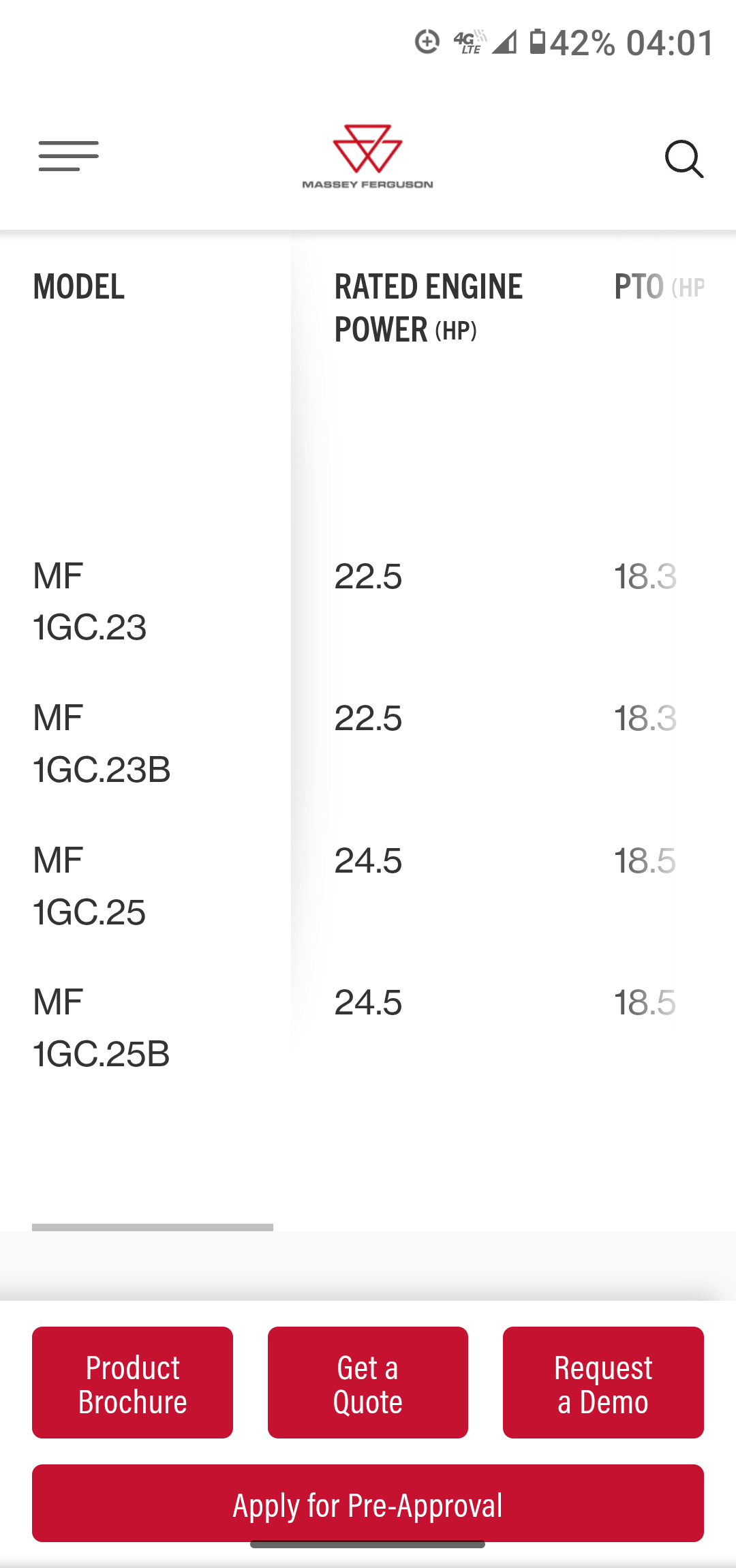

Massey Ferguson has changed the model numbering system though they are now a GC1.__ the 23 or 25 is the basic HP and the 25 is a more deluxe version, over the more basic 23 ...

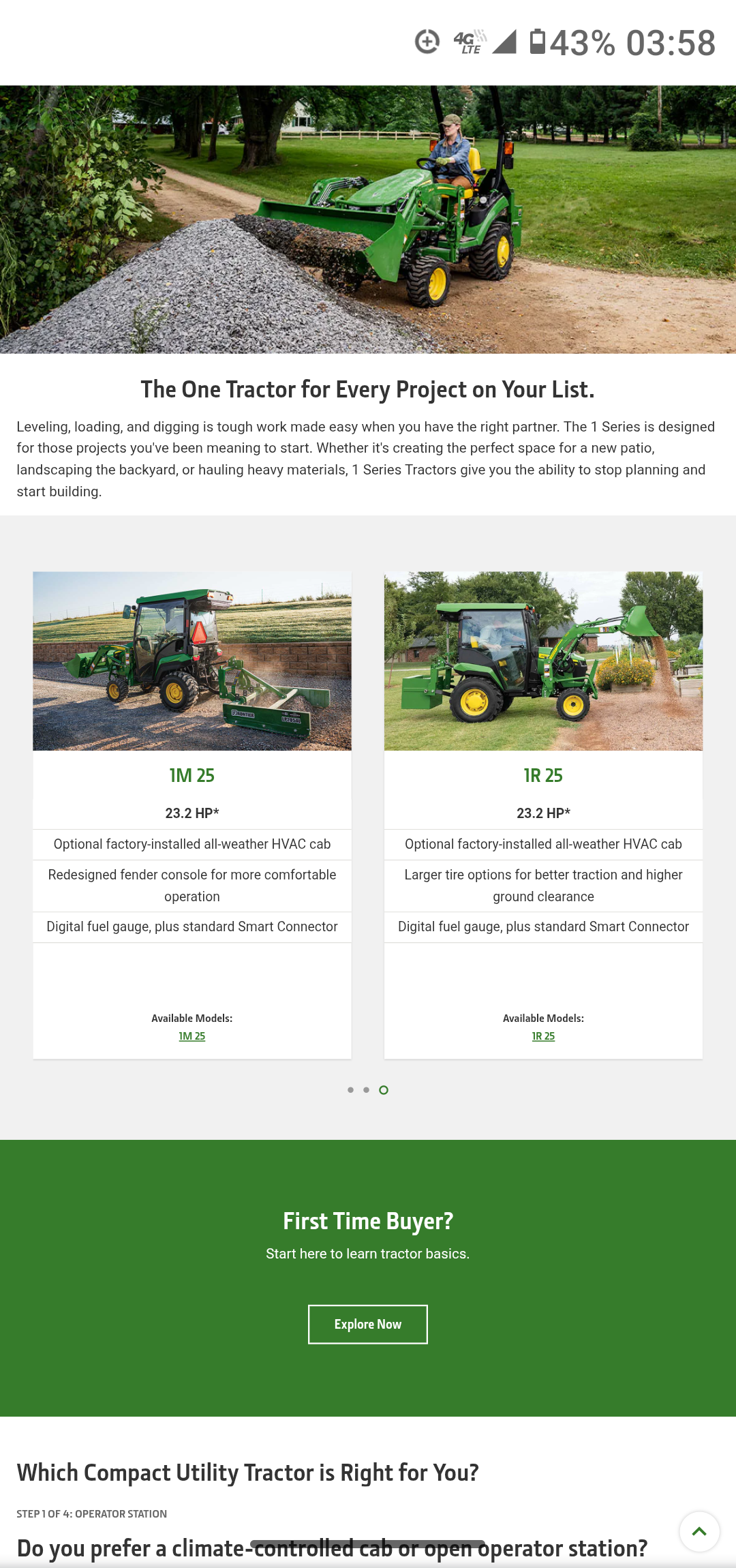

John Deere also has a similar new numbering system ... They also have the more basic economy model called the 1E 23 with a slightly smaller engine.
There 1M25 is the new 1025R ... The 1R25 is the new 2025R, which is closer in size to the Kubota B2601

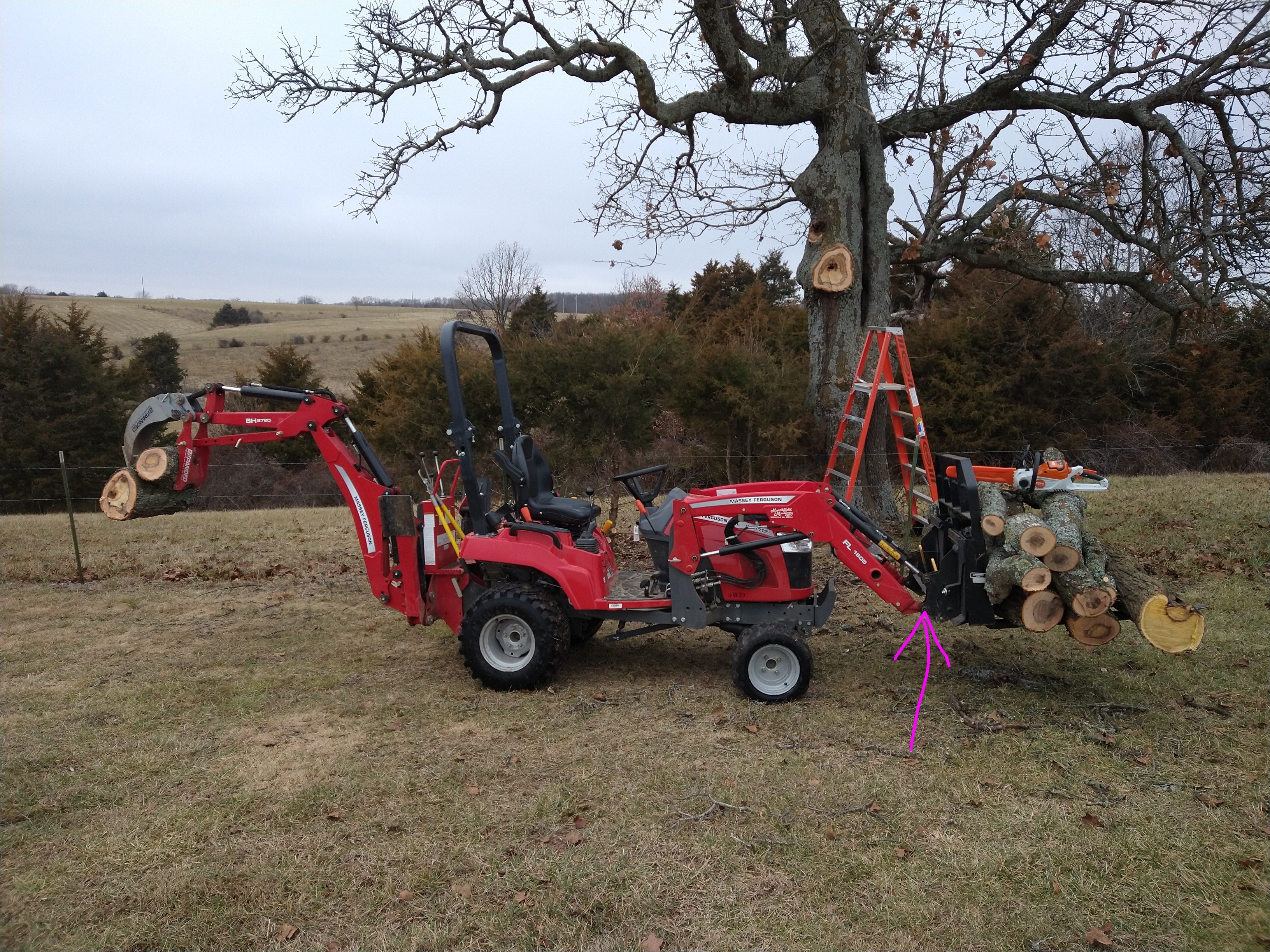

One thing to consider is what do you want to lift with the forks? And to recognize that the brochure numbers probably don't mean what you might think ... The "pins" is a way most all loaders are "measured" it does not include the weight of the bucket/forks/grapple in that number ... The purple arrow is the "pin"! Notice that the load of logs I have on below starts quite a bit forward of that!
Also be aware that the closer the load/weight is to the pins, the actual weight you can lift ...

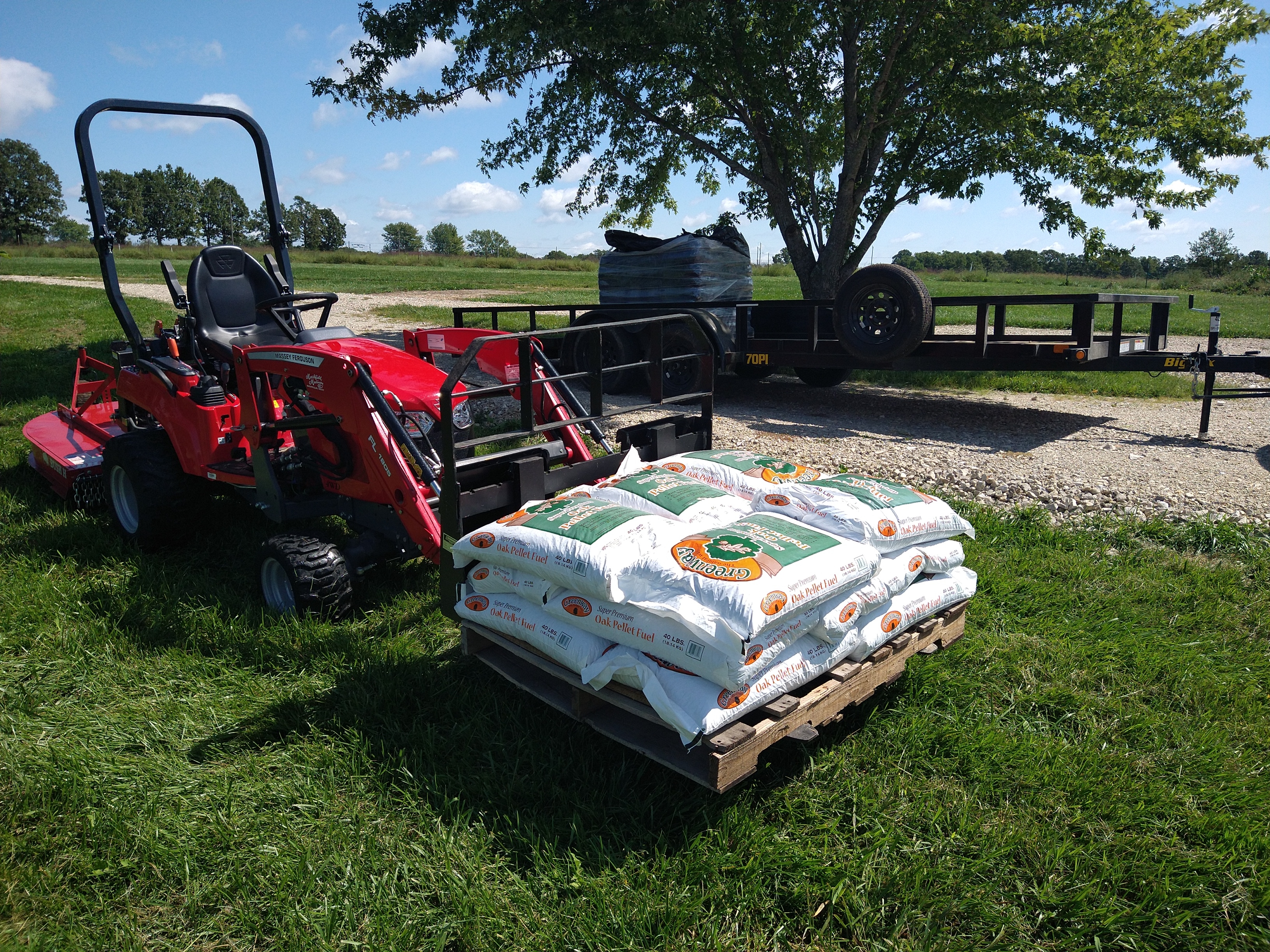

This is as high as I can lift the forks, pallet and 15 bags of wood heating pellets ...

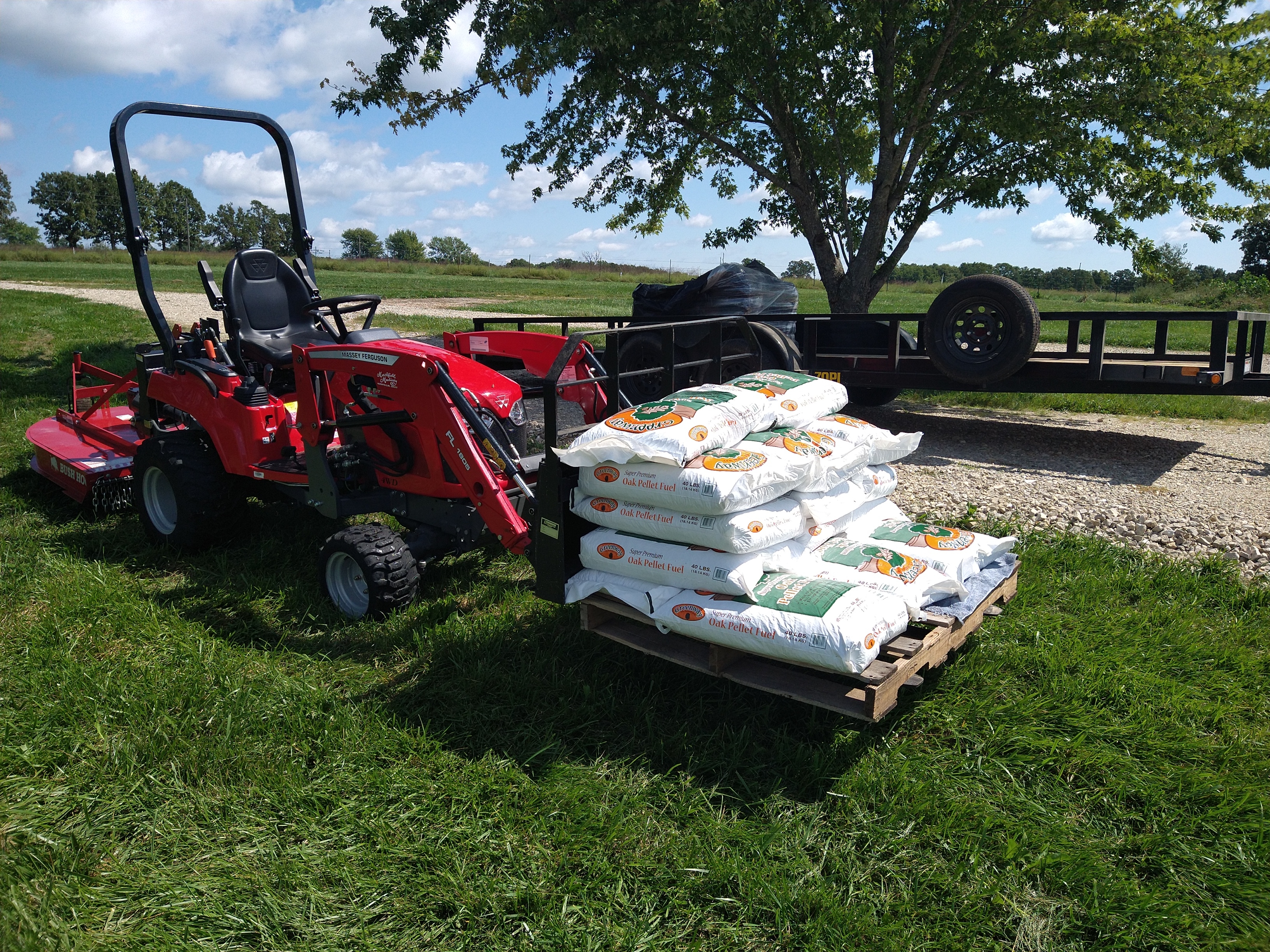

Notice that by stacking the bags closer to the "pins" I can now carry an extra bag!
Also notice that in all three of my pictures that I have some weight on the back on the 3pt hitch, this is critical to safe and effective front end loader (fel) use ... Read ... https://www.tractorbynet.com/forums/threads/how-much-ballast-do-you-need.659531/
