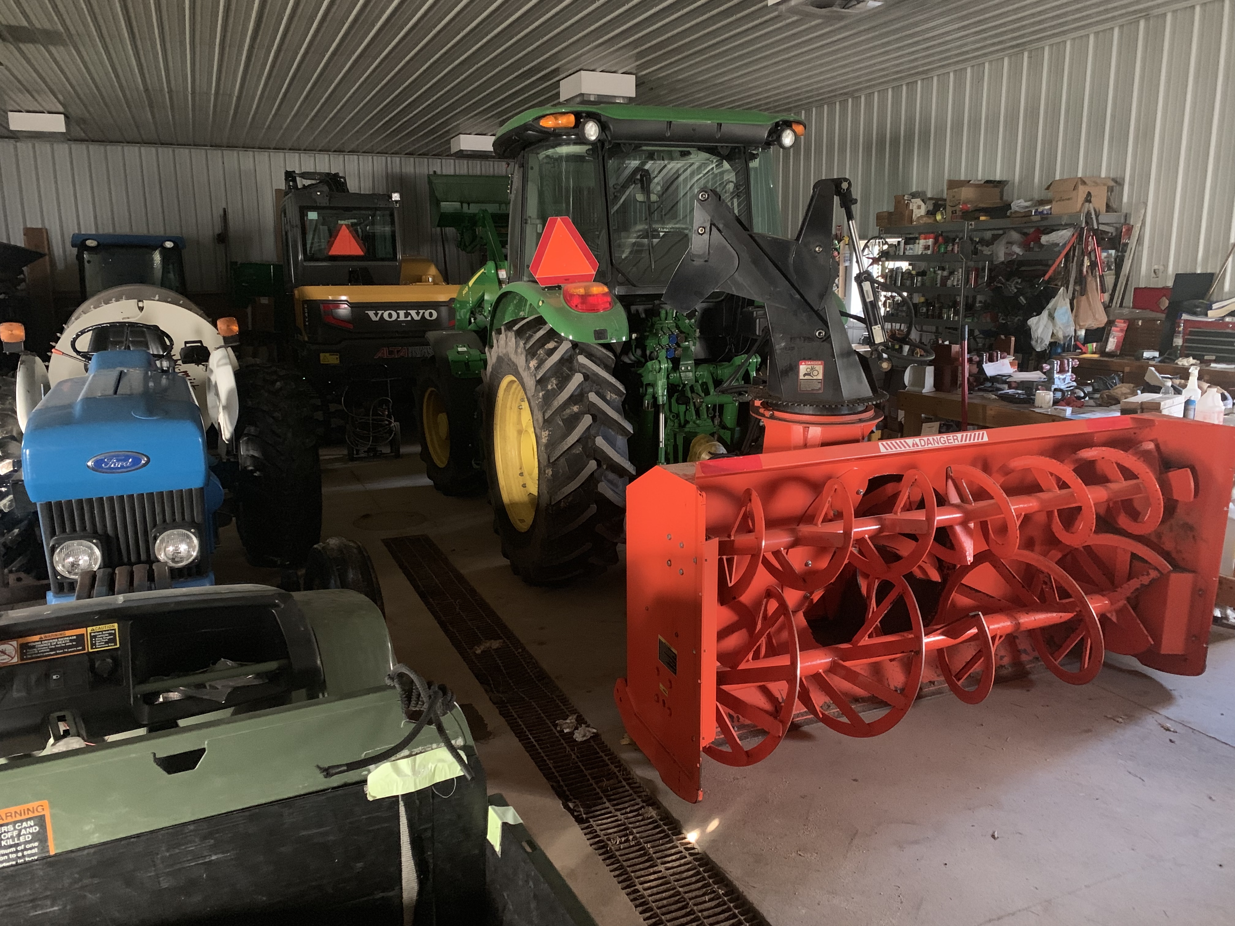

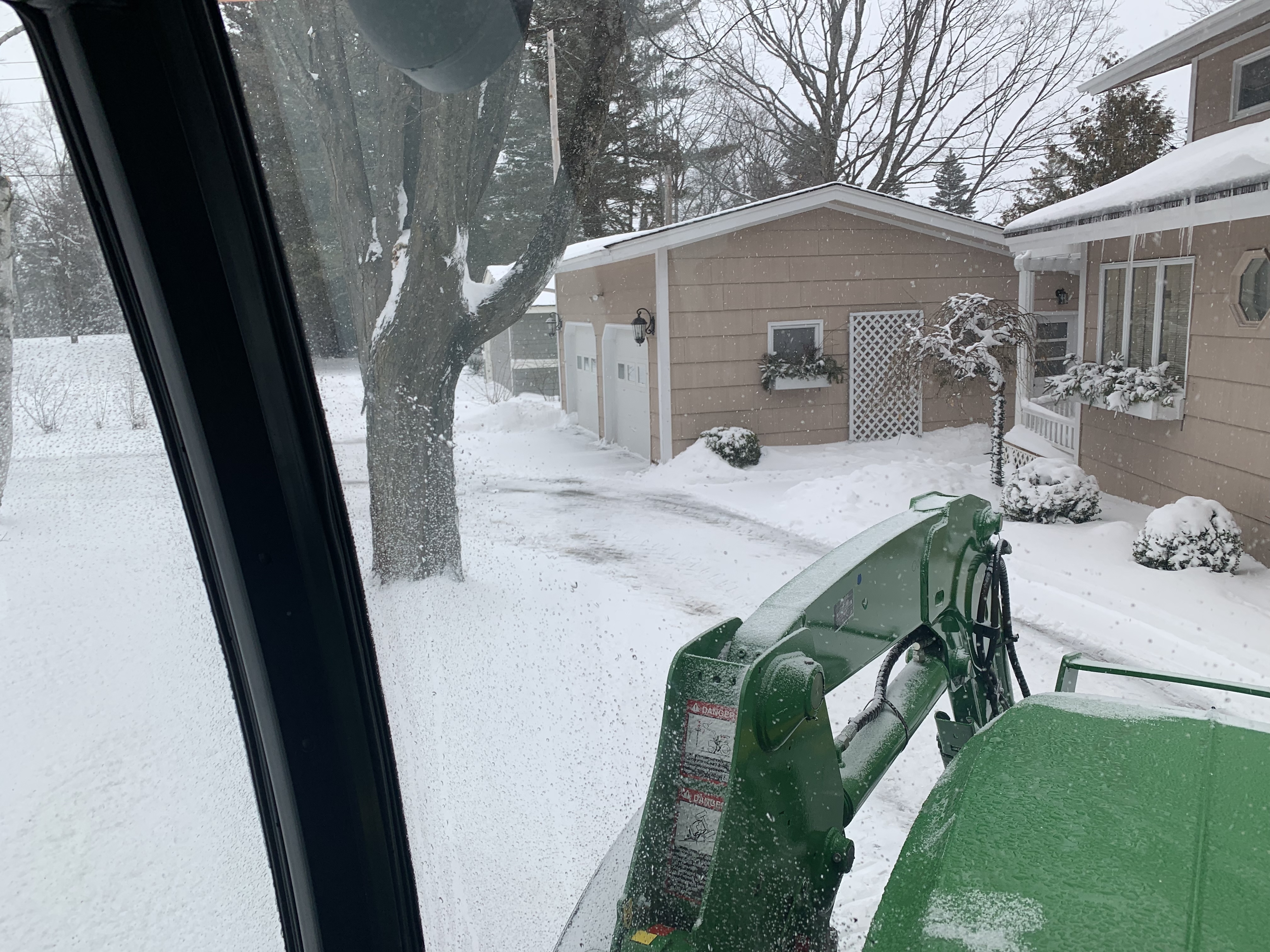

For ballast I use 16 100lb suitcase weights hung from a Heavyhitch brand weight holding frame, gives about 1700lbs total. I’ve got only 1 wheel weight per side and No liquid ballast (may add 1 more). I find it’s plenty adequate for my uses , liquid would definitely add much more stability but over the years I’ve come to not like dealing with liquid ballast although I do still have it in some of my tractors. Wheel weights and 3pt ballast is my preferred option.
I do some snow removal for hire in winter with the 5115M and that’s the primary reason I went with the 540R loader on it. I’ve got some driveways I blow that it would be very easy to take out the corner of clients garages as I’m doing there circular drives especially if I leave bucket on. I prefer a rear mount blower for it’s smaller turning radius on a larger tractor, essentially gives you rear steering. Great setup for my applications.
Just want to add I mistakenly said I mounted the the 540m loader myself, it was the 540R loader.
