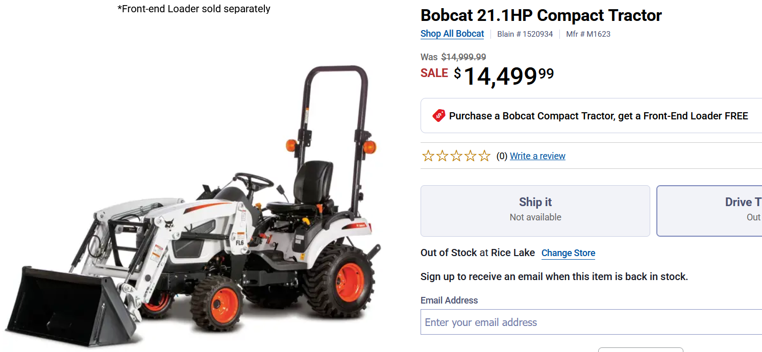

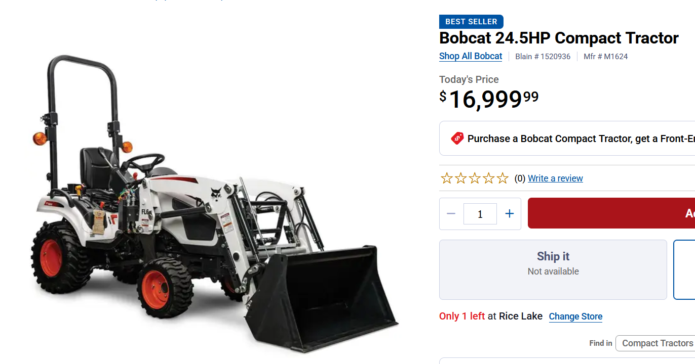

I'm generally not a fan of Sub-Compact Tractors, but for your acreage and tasks, it would be perfect. Where are you located? Here in WI, the Farm & Fleet stores carry Bobcat. Here are some prices for comparison ...

I am located in SE WI about 35 min outside of Milwaukee. I did look at Kioti as well but the prices seemed to have jumped and are on par with Kubota.
