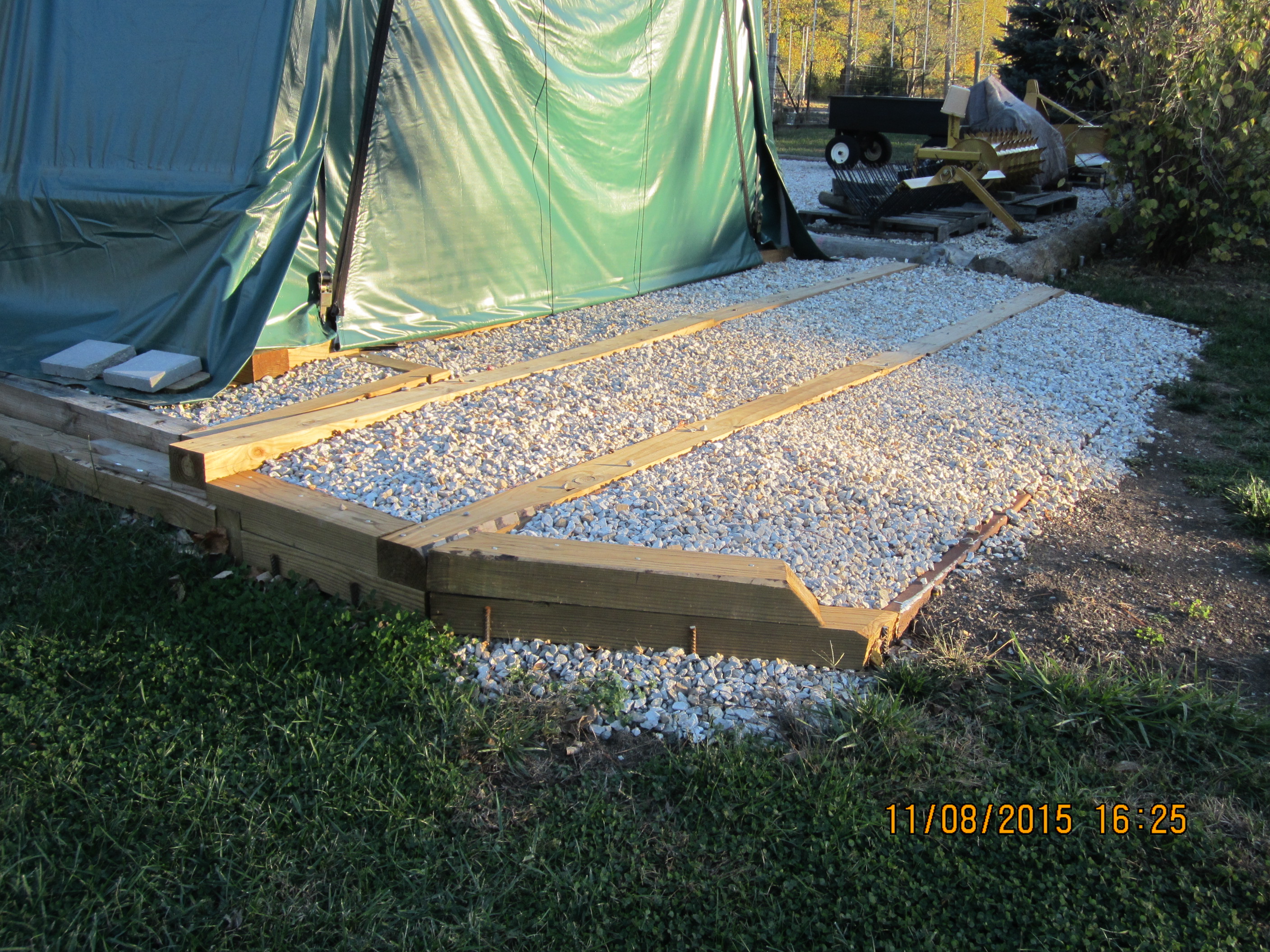

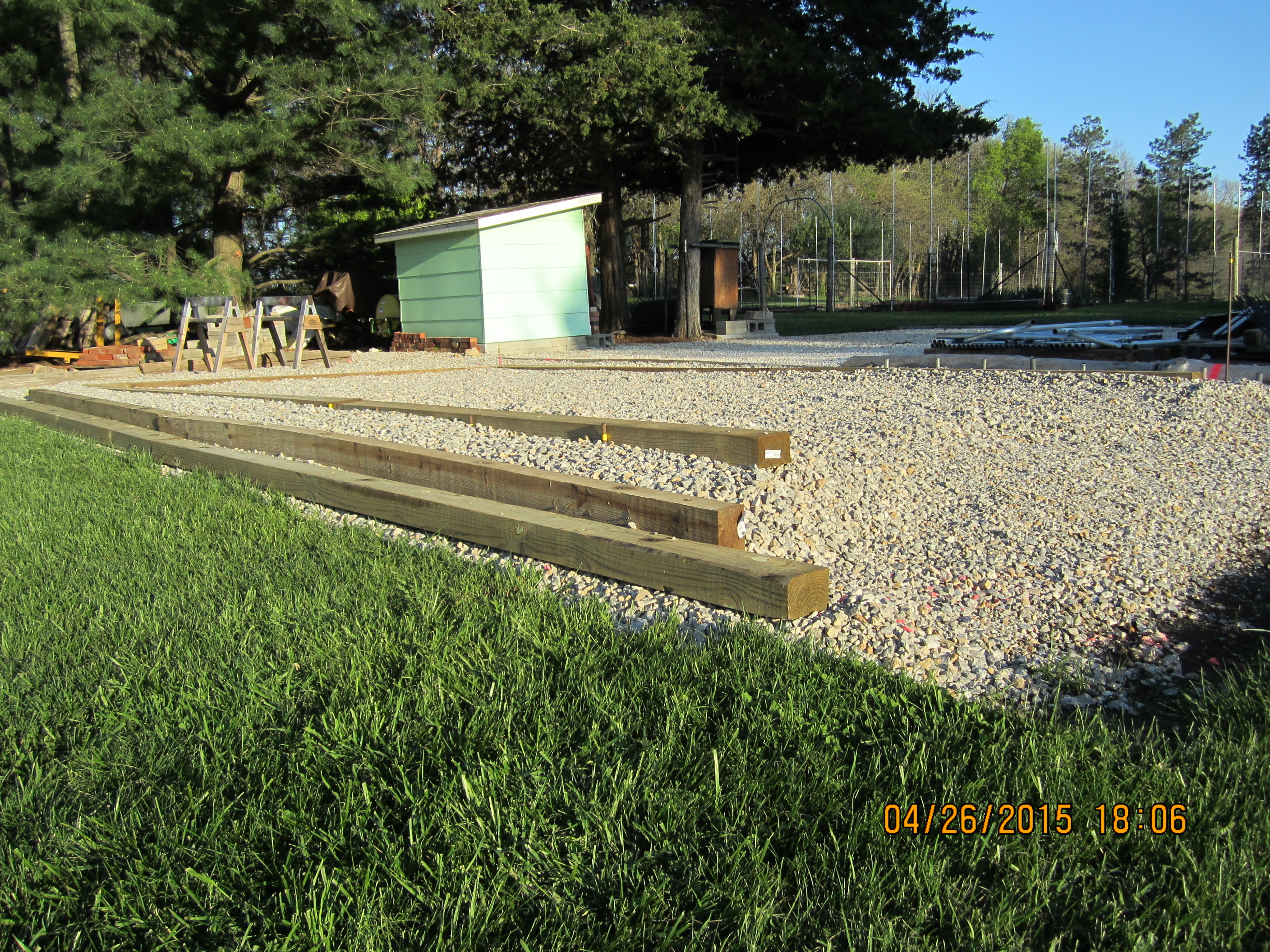

Any concern trapping moisture from the ground below? I would have put down a vapor barrier of some sort under the gravel.
   / Put up a 20x12 Shelter Logic Round Top #13
I used wood chips as floor covering in my buildings and like it. It stays dry so it lasts a long time.

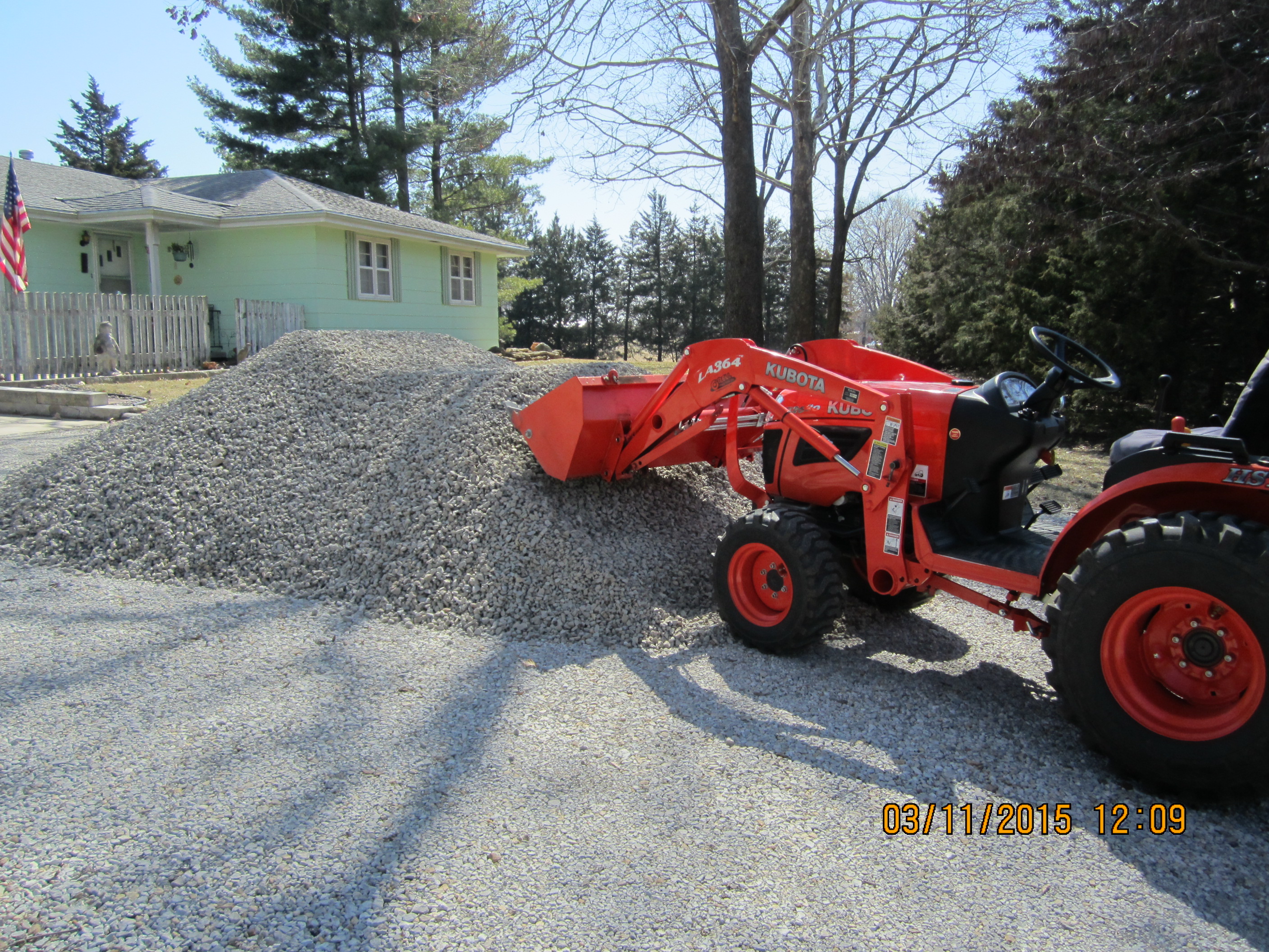

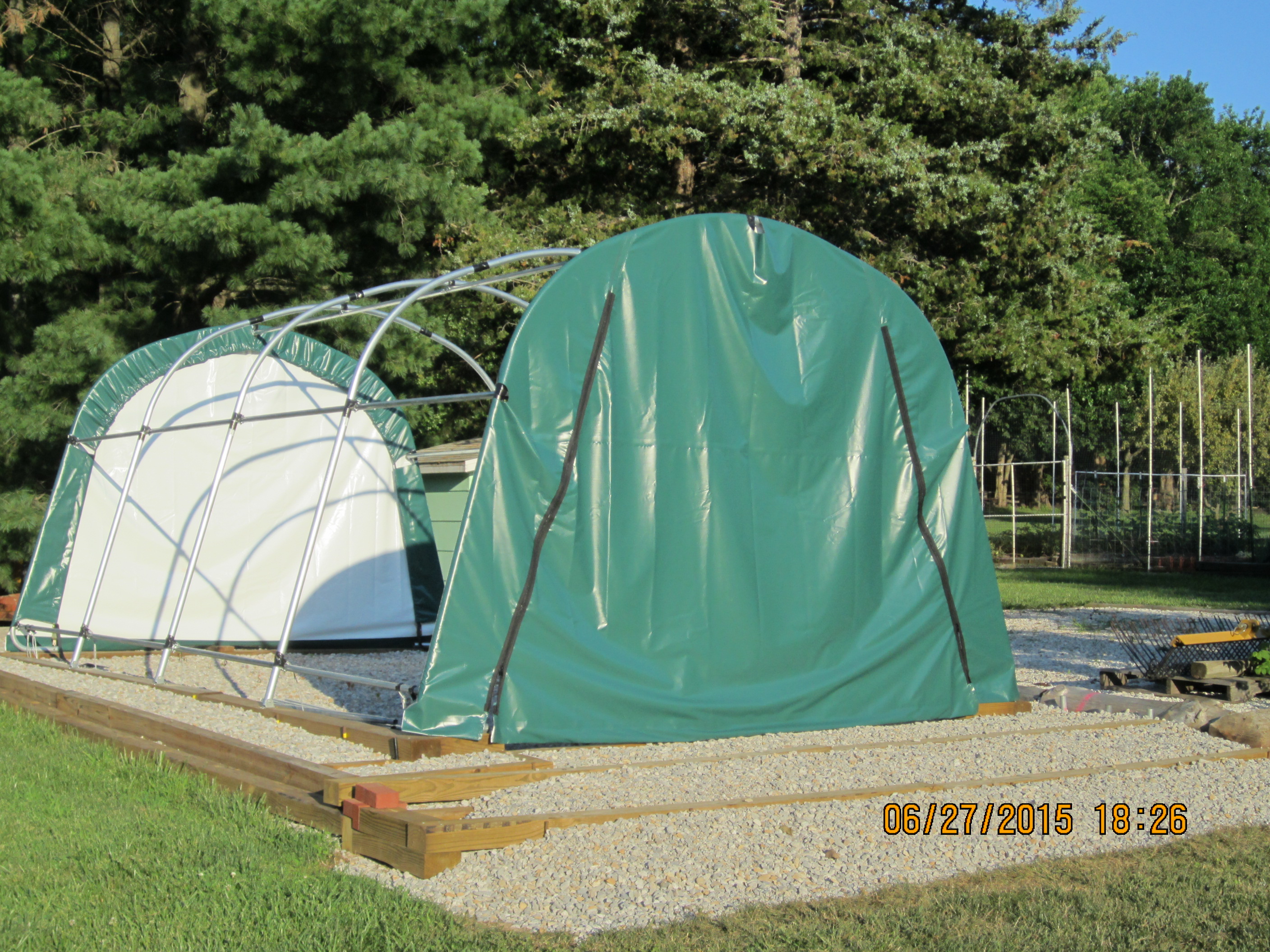

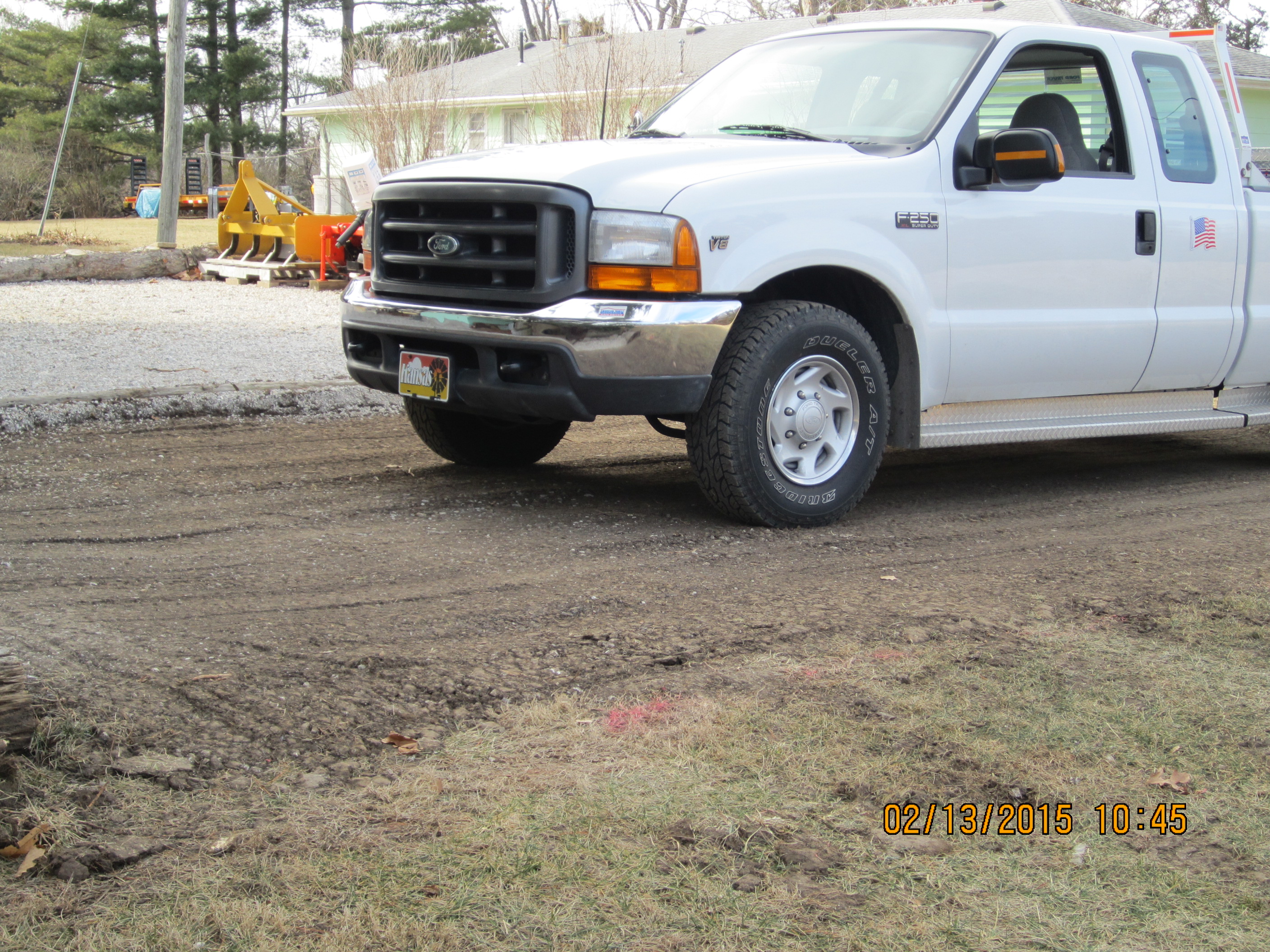

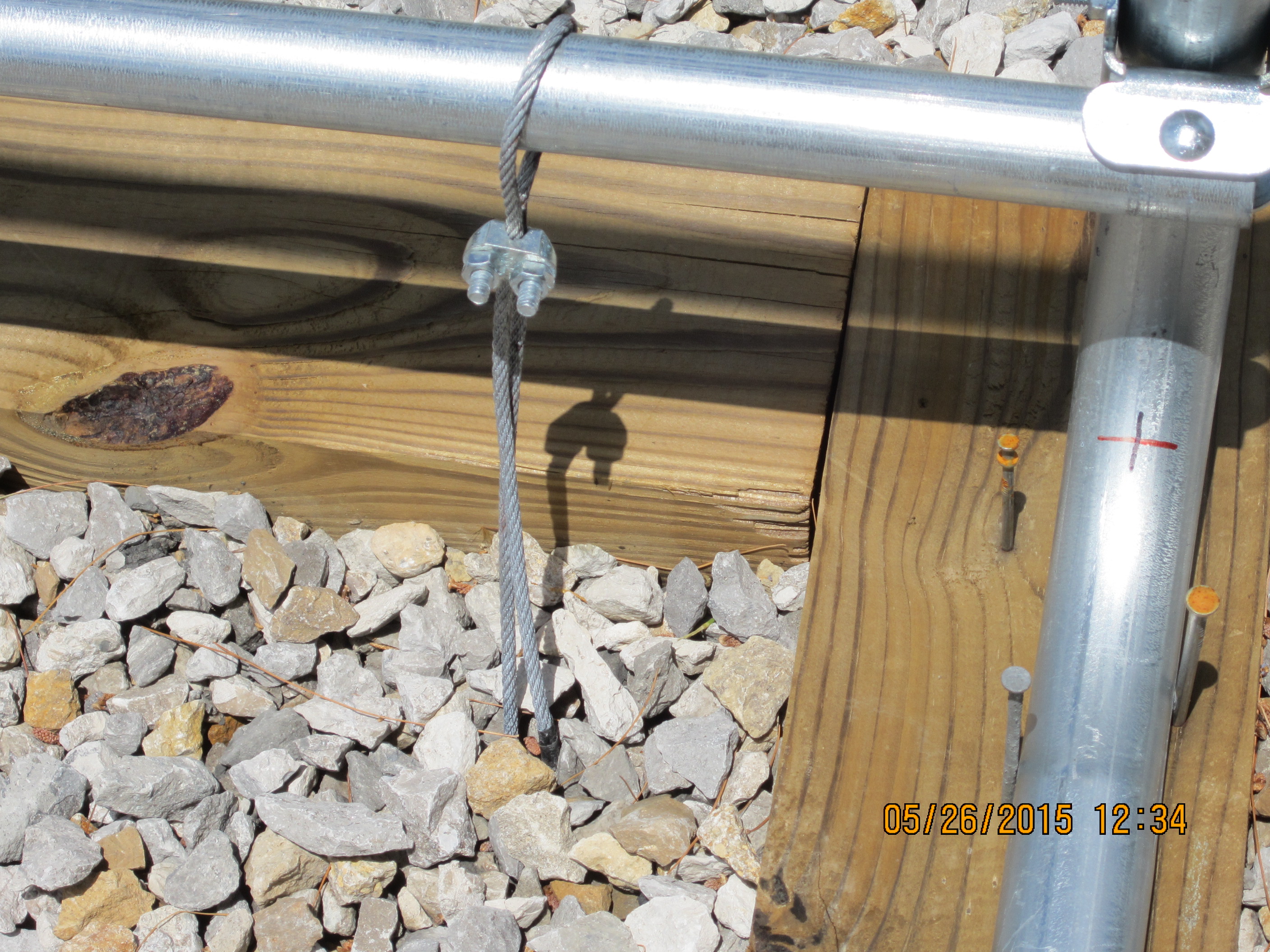

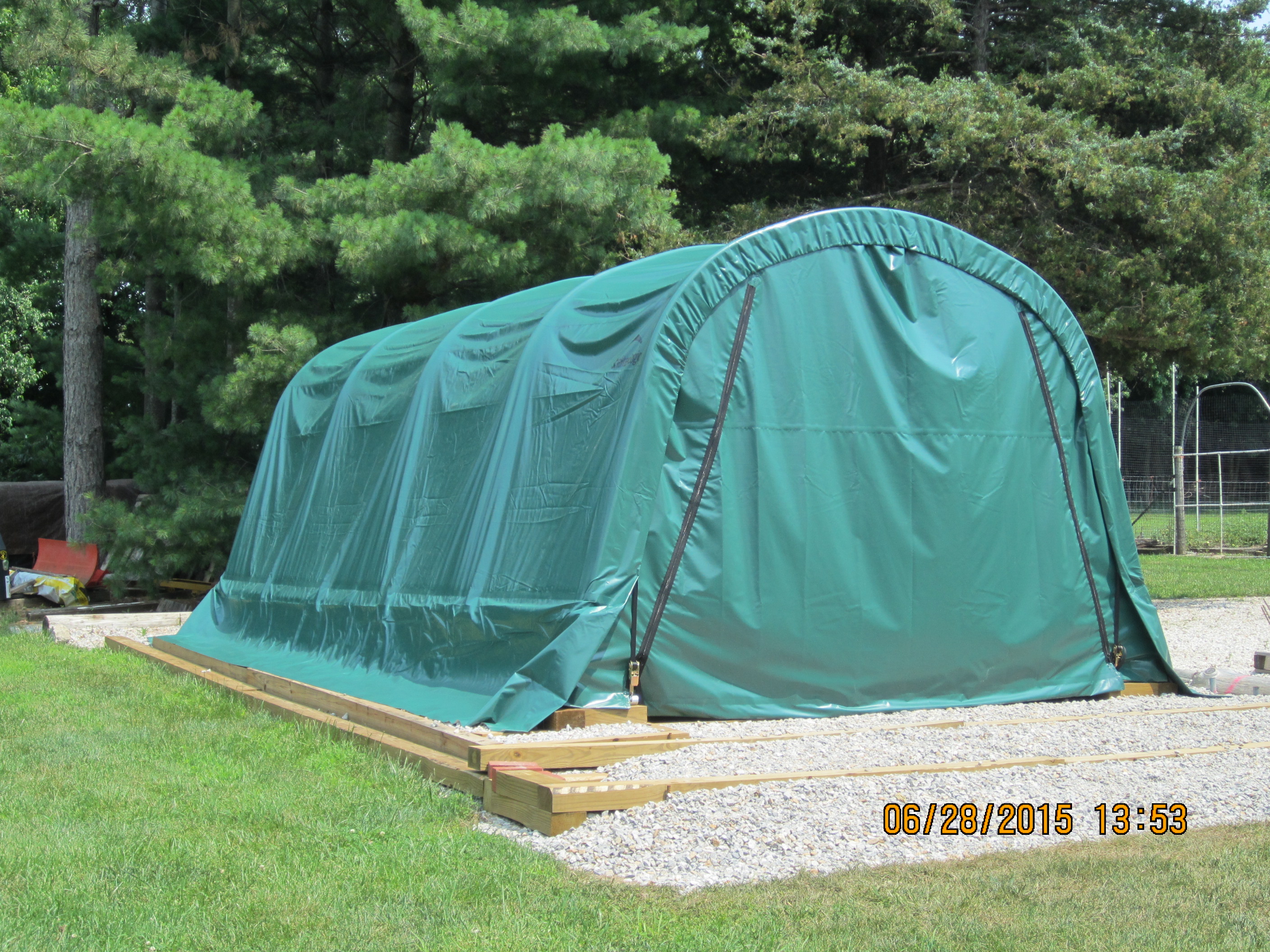

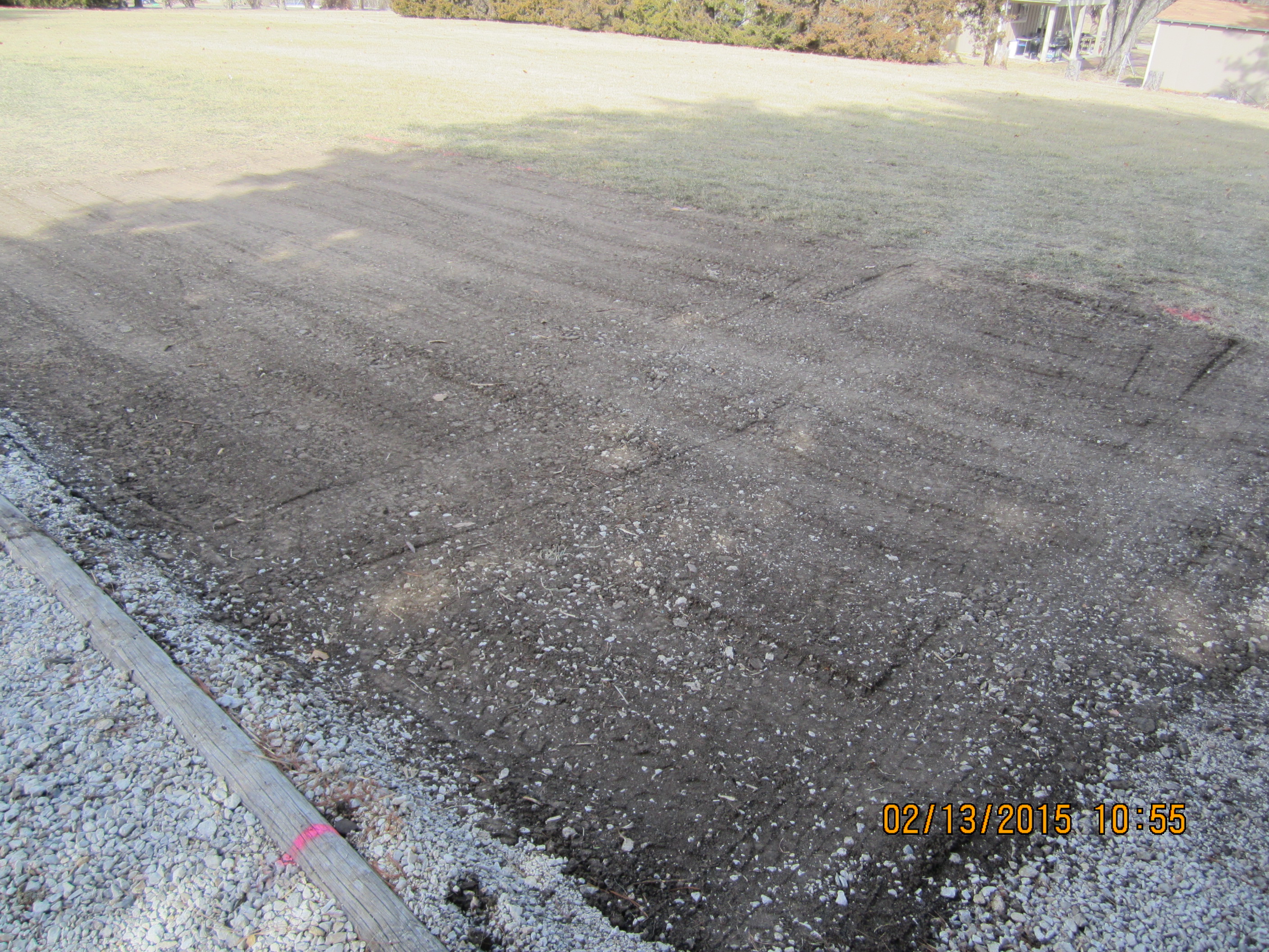

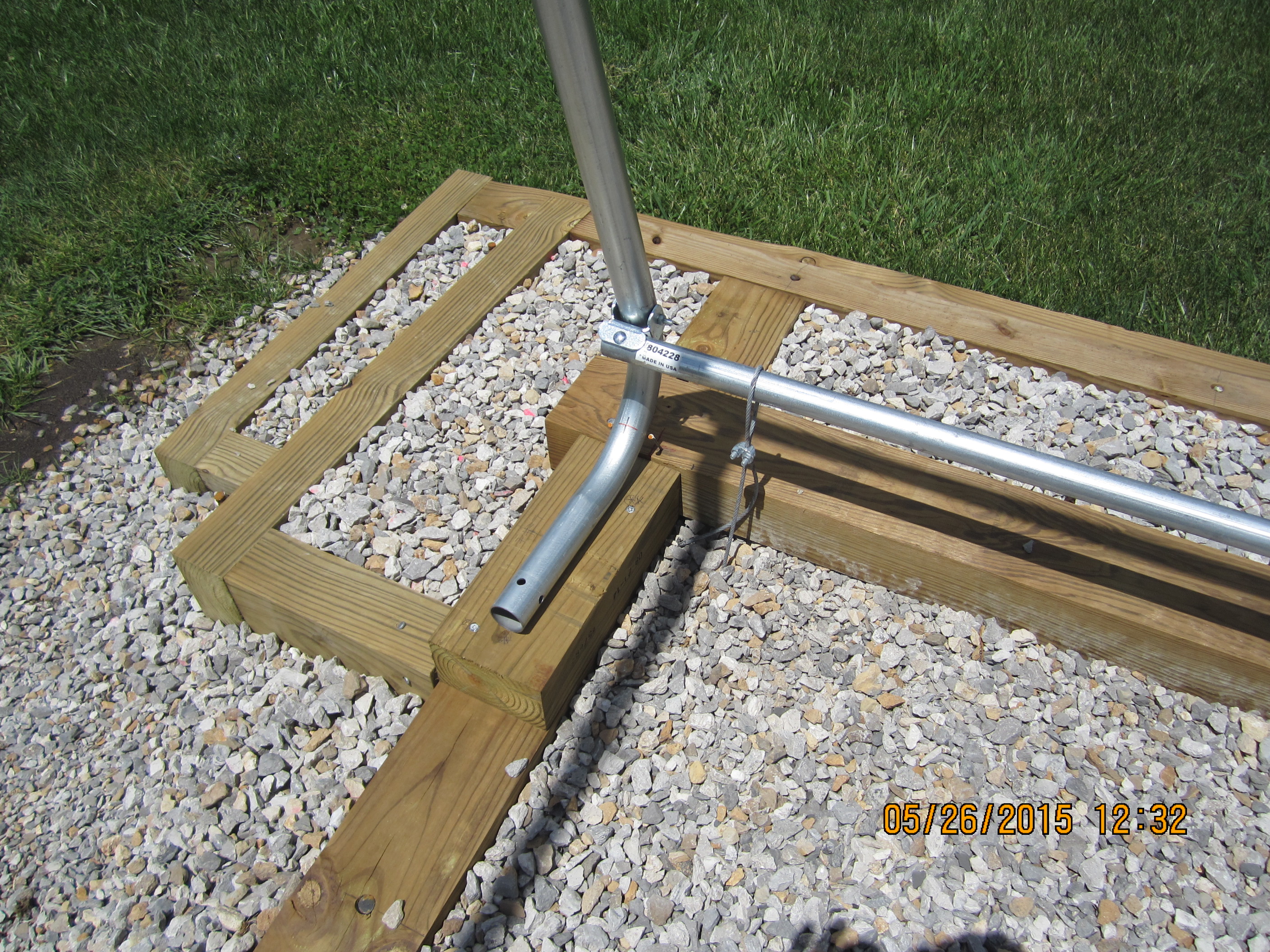

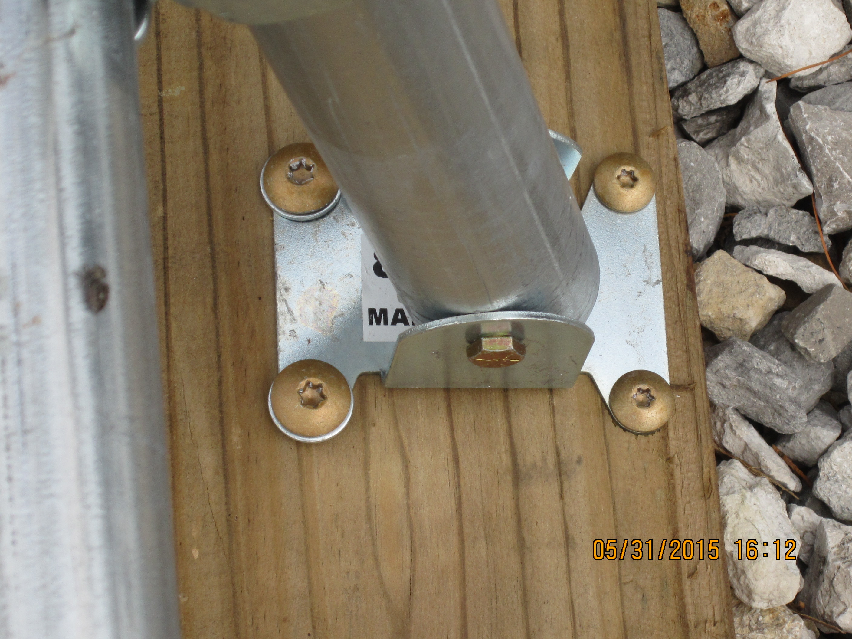

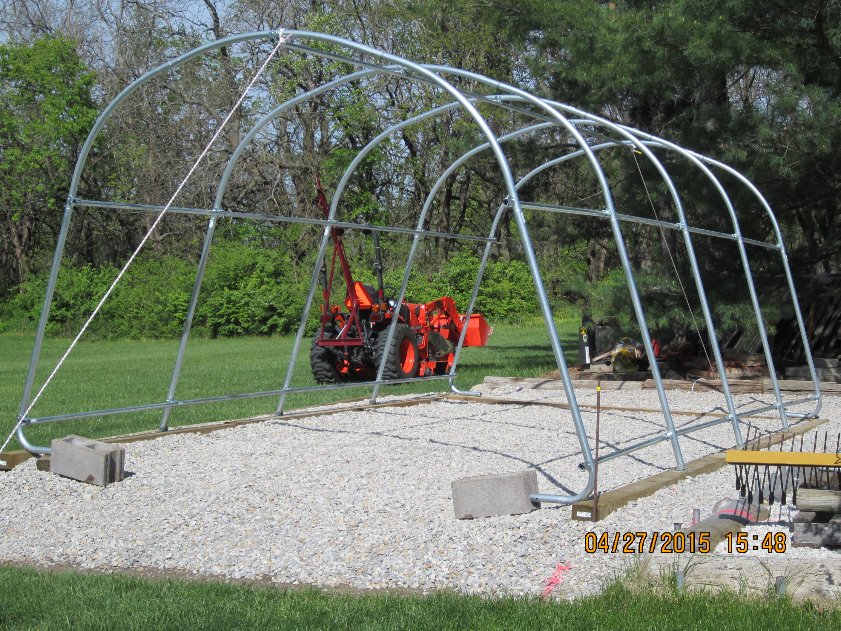

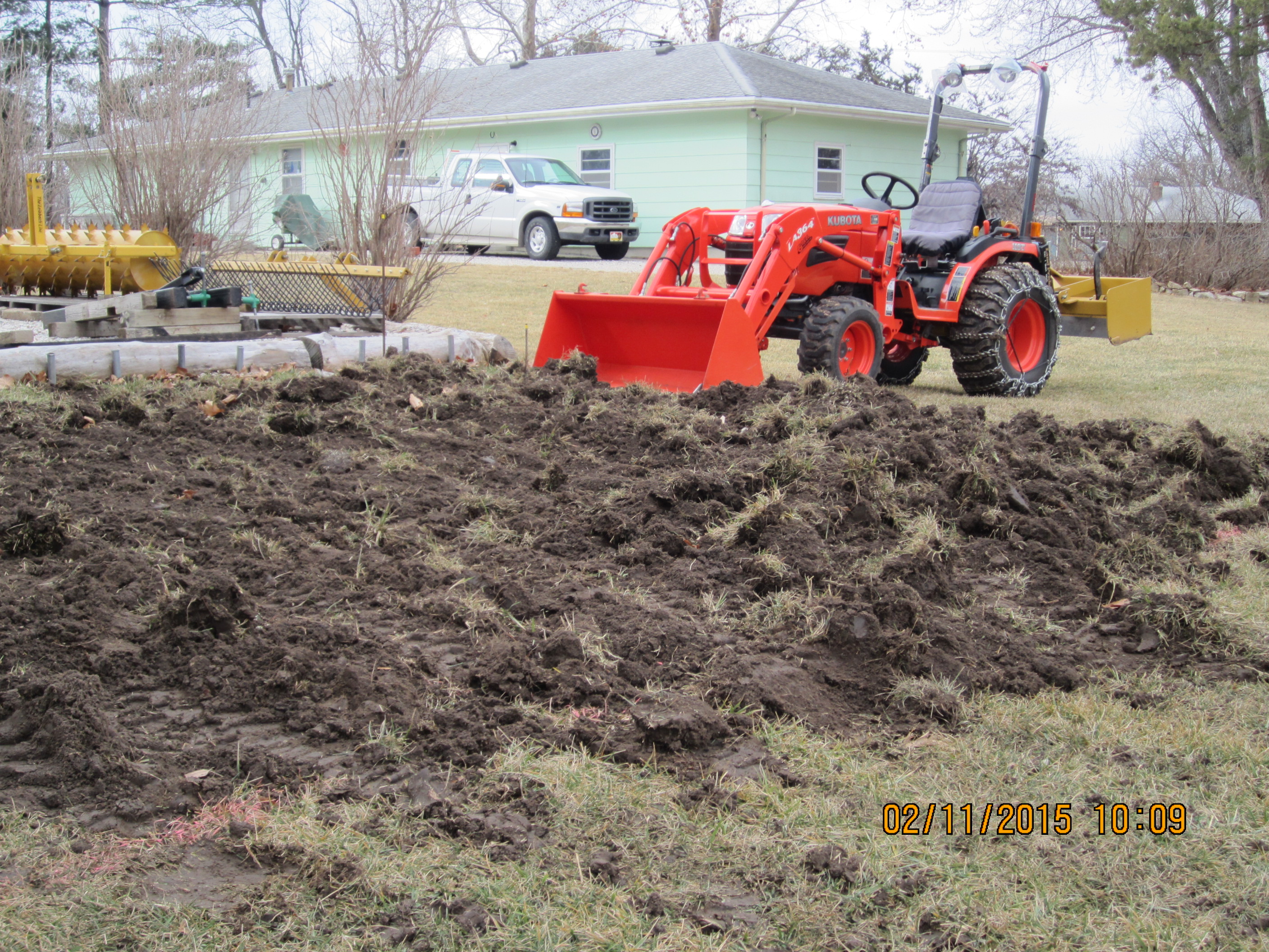

002.JPG016.JPG017.JPG001.JPG047.JPG053.JPG104.JPG106.JPG113.JPG127.JPG131.JPG002.JPG062.JPG
Here's the sequence of my newbie installation. ... bought direct from company .... their "Top Of The Line" product .... had good customer support .... am satisfied so far .... has endured multiple summer storms with up to 70 mph winds .... interior sweat has occurred a couple times .... I'm in/out of it almost daily with several pieces of equipment stored therein.
P.S. .... did the installation by myself with help only pulling the top cover over.

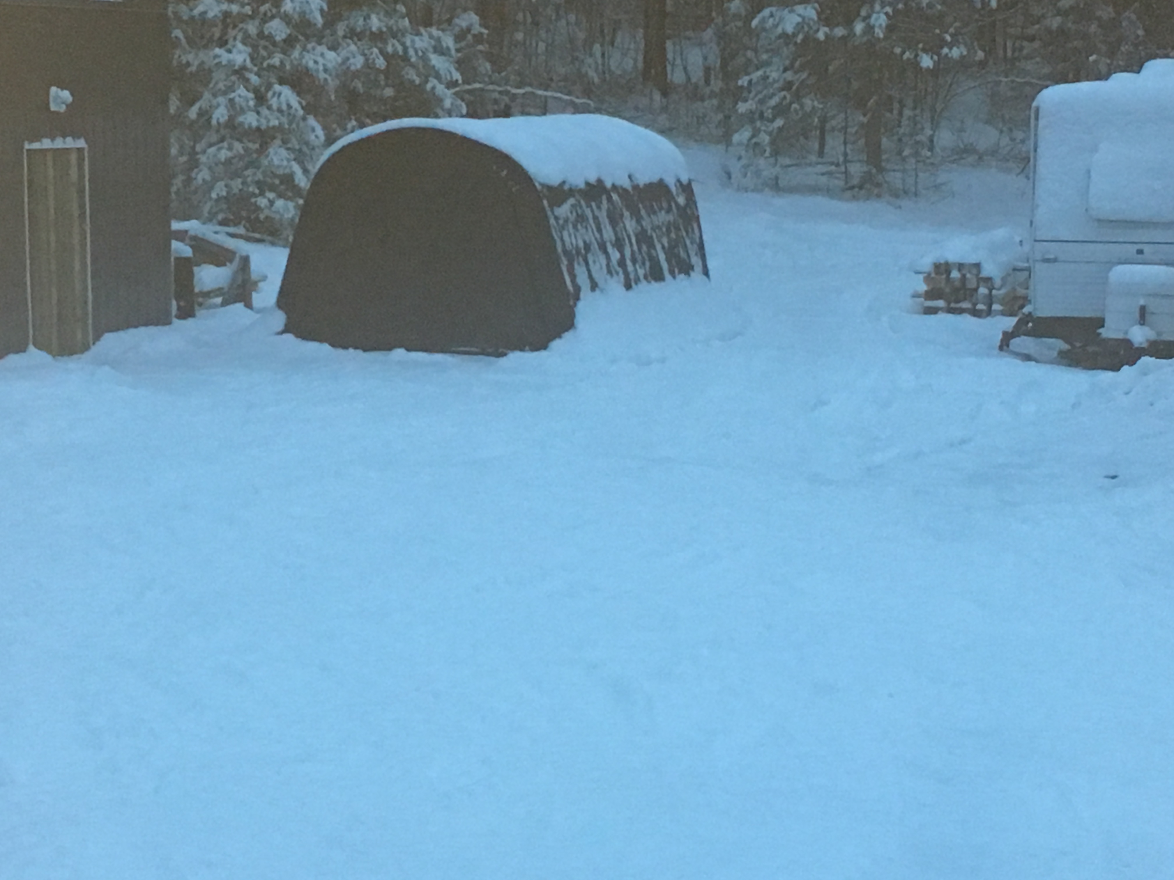

ruffdog, can you post a picture of the outside, nice idea, does the snow stay on the ribs of the siding?

Did the exact same thing, the trusses are now 2 feet apart as opposed to 4. May just do what ruffdog did and put siding. Mine is 24 feet long.

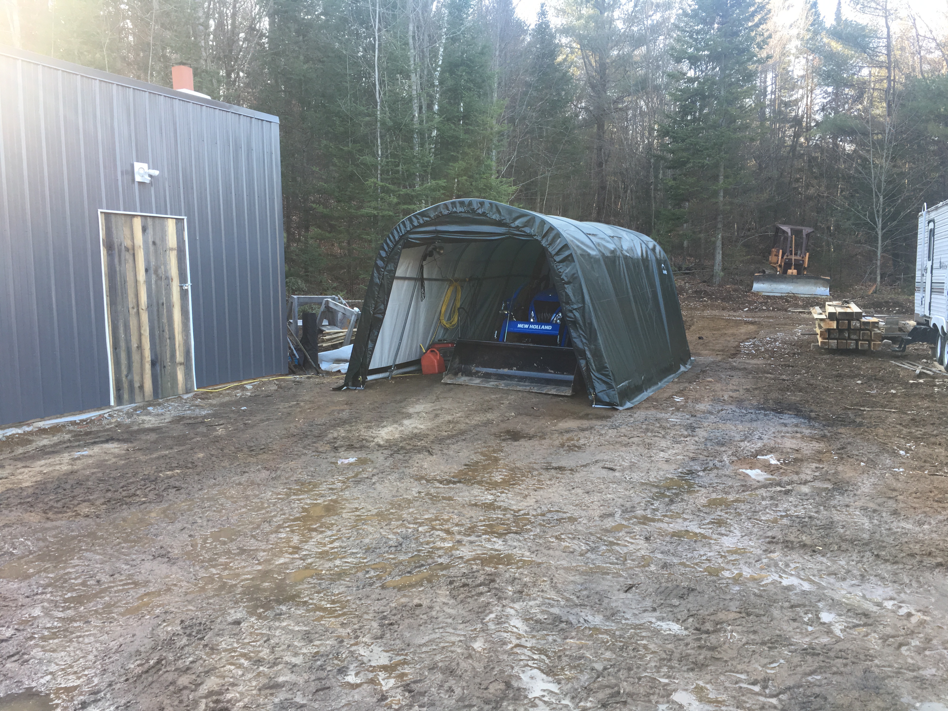

Put one up a couple weeks ago, 12x20, took 3.5 hrs by myself. Great shelter till I can get my shop built!
