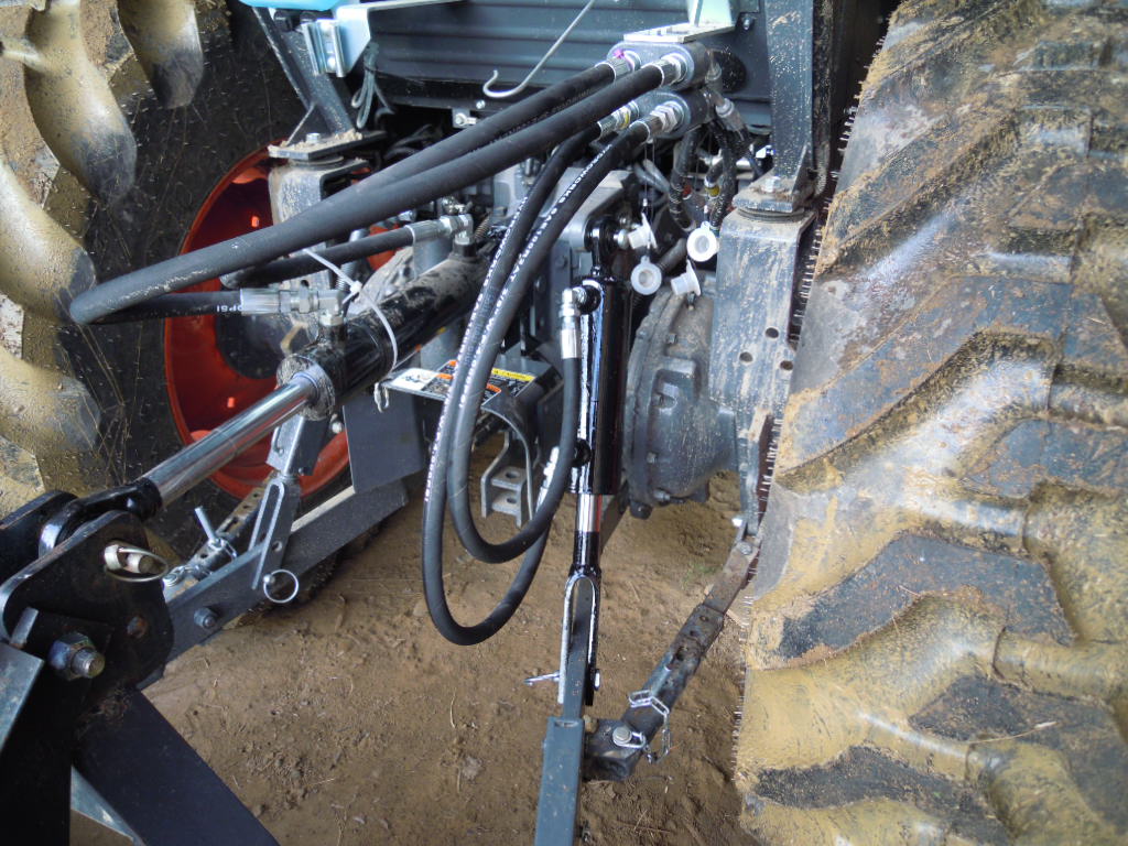

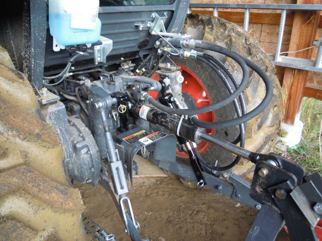

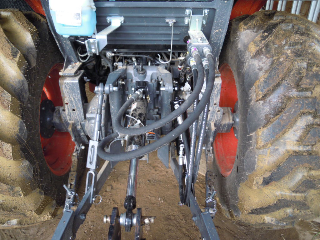

I've been reading a lot of threads about how great it is to have a TnT so I went to the local Kubota dealer and ask how much for a system. The parts guy didn't know what I was talking about. So I went to Princess Auto and found that they carried 3 different Hydraulic top cylinders but they were all too short for my tractor and they did not carry the side tilt cylinders. A little more reading on this forum and I found what I needed. A DIY top link extender and a thread about making your own tilt cylinder. So back to PA I go and get the longest top link cylinder they carry. It's a 2.5" cylinder with a 10" stroke and I got a 2.5" x 6" cylinder for the tilt. I had to cut off the top and bottom tubes that were welded to the top of the cylinder and to the end of the rod. Then make a "U" shaped connector for the bottom and weld that in place plus weld a swivel eye to the top of the cylinder. This was the tricky part because the eye had to be on an angle and it was hard to get everything aligned but I got it done.
I was leery about welding and creating too much heat, which could destroy the seals, distort the ram or the cylinder but after reading some threads and seeing that others have done it successfully, I went for it. Boy am I glad I did.
Here are some pics of the freshly finished and painted setup. The paint isn't even dry but I had to try it out and absolutely love the new capabilities it offers.
