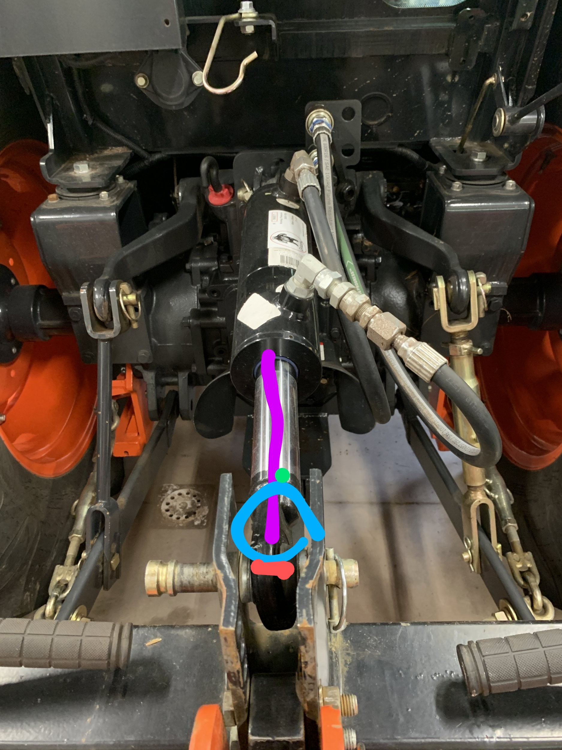

Hey everyone! This is my first post, and I hope someone can give me some thoughts and ideas. I have watched the Dave Knows How videos on setting up a box blade and especially the one about making up a hydraulic top link indicator to see at a glance if your box blade is level and in a neutral position. However, I’m not a welder. So I’m looking for ideas on how to cobble together a rod attached to the top link cylinder and riding thru a loop or eye bolt mounted on the top link rod. If you’ve done such a thing, pictures would be great!
OR…would it be simpler to just draw a line around the top link rod at the neutral position with a magic marker? Is that something can be done without damage to the top link? Any thoughts would be welcome.
I have a Kioti DK4210SE.
Thanks.
take a rod and use a big hose clamp to attaché it to the cylinder leaving it just long enough to meet the end of the cylinder rod when it is level.
/ Top Link Indicator
#23
I see what you are trying to accomplish with a indicator... But that experience comes with more seat time.. if you were doing some very fine grading for sand or something really important I can see it.
You want a simple version attach a small rod, yard stick anything that small enough to attach above the eye of the top link and point back towards the cylinder.. adjust it with the blade level to the point when it crosses plane with the cylinder that will be your level point. Seems more logical since you spend most of the time looking back... down towards the work the blade is doing.
I would suggest sitting in seat and looking back to get it to the point you desire before attaching by tack welds or other means.
A small rod, maybe a small clearance block of steel a nut or pipe to run it through and maybe a nut on top of you want it adjustable... You can drill a hole tap it or weld a smaller nut on top with a set bolt.
Just make sure it has clearance above the cylinder and won't make contact with it or hydro fittings when let in all the way.View attachment 796105
Red clearance block if needed, blue pipe or nut, pink rod, green set point for adjustment
Small tack welds on that rod end is fine you're not getting anything hot enough to worry about.
Thanks for taking the time to give me your ideas. Looks like it might work very well. I don't have a welder, but maybe I can figure something else out. (Or, get a welder, lol).

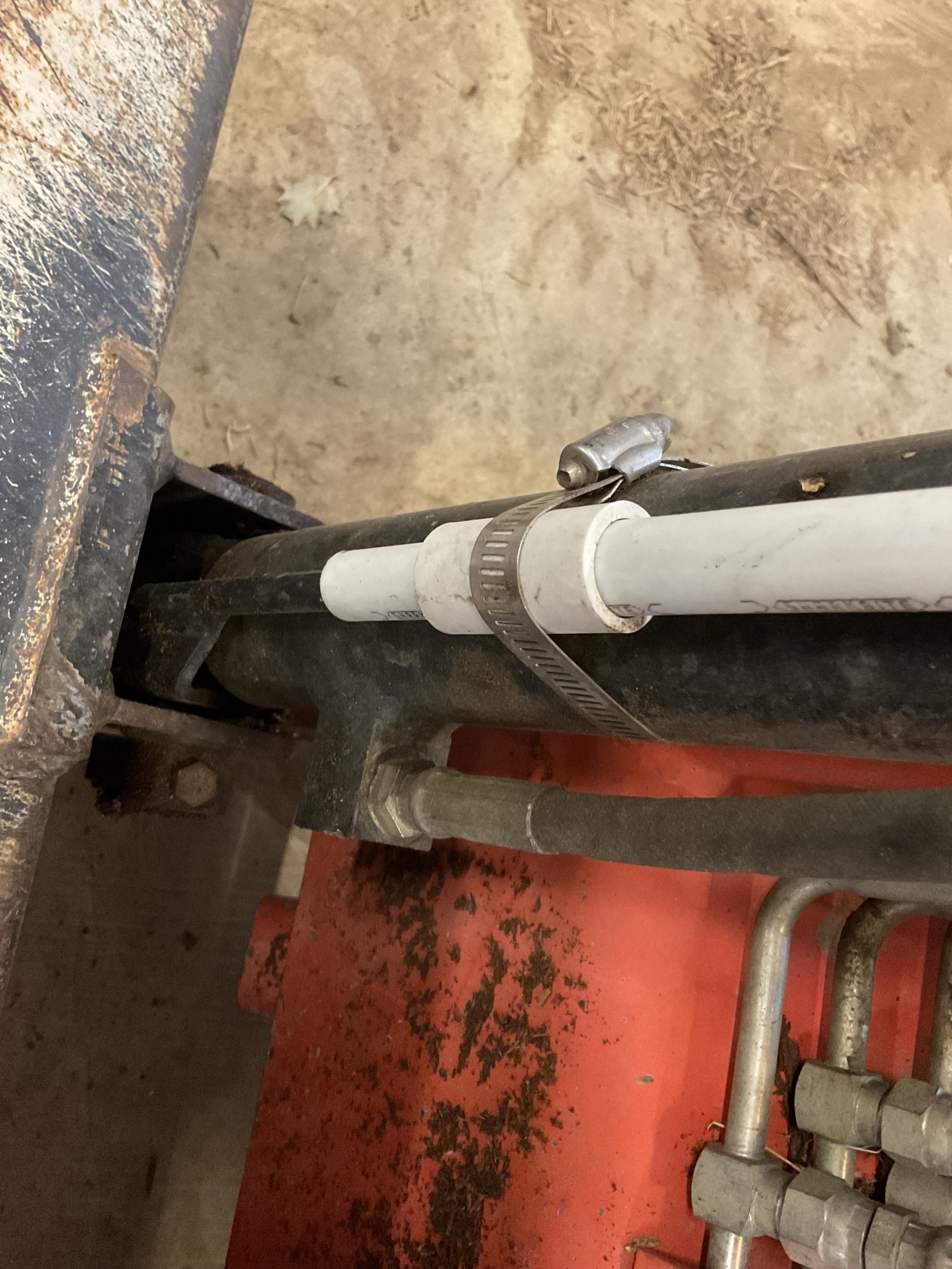

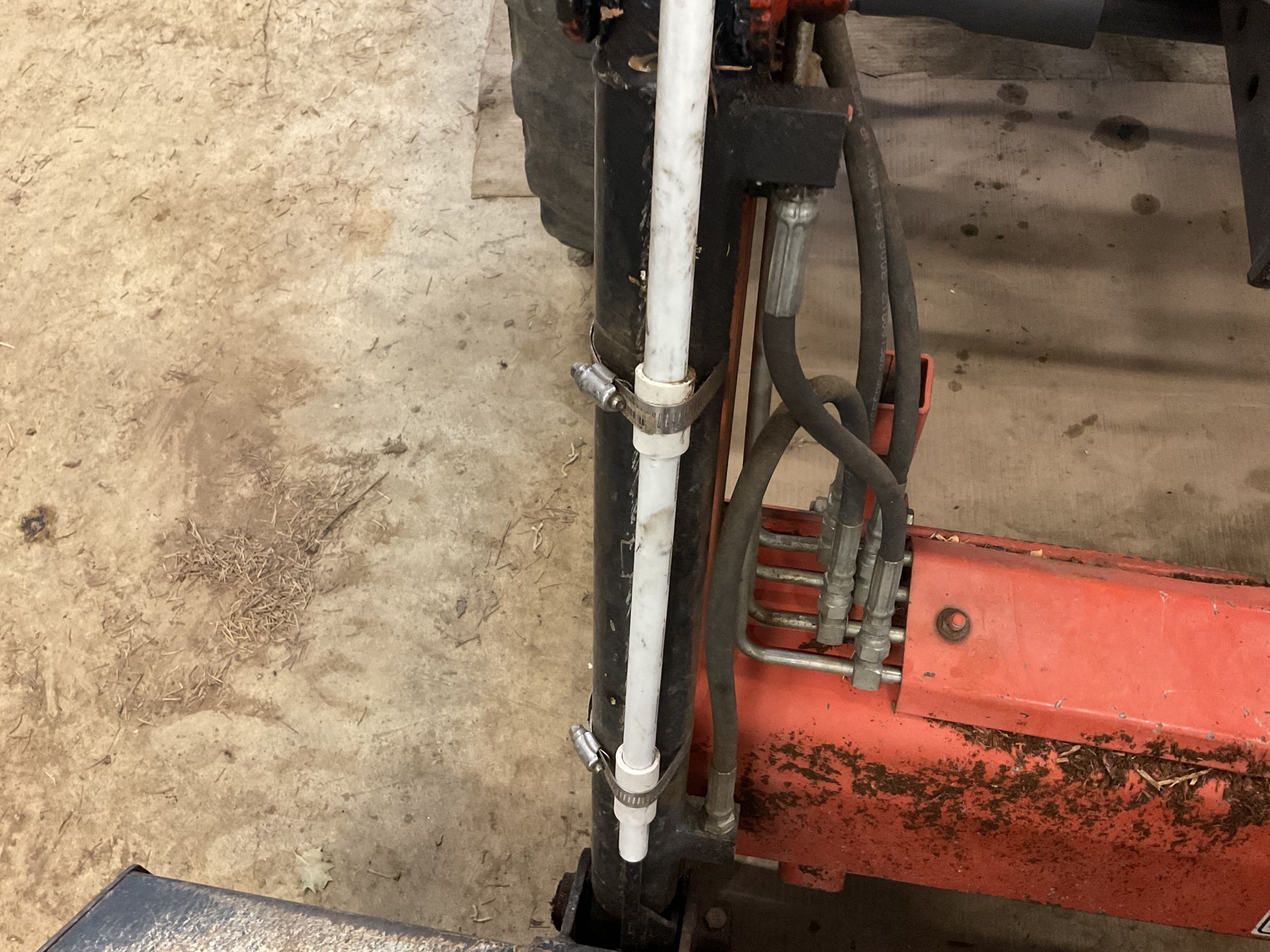

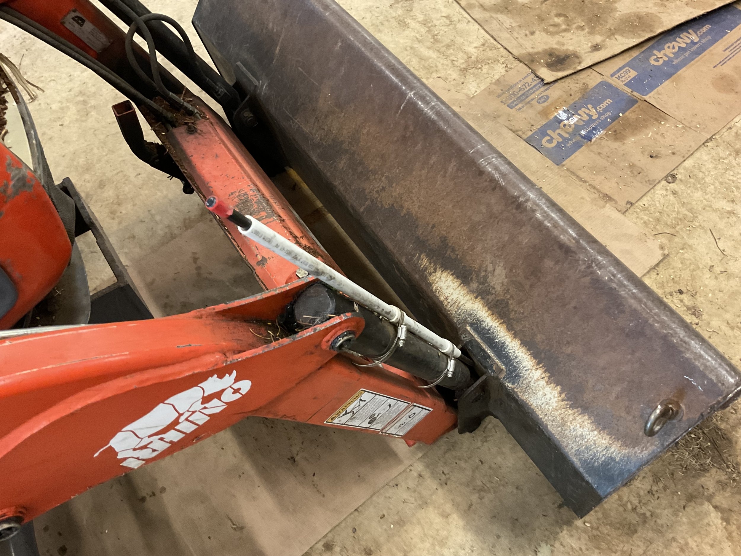

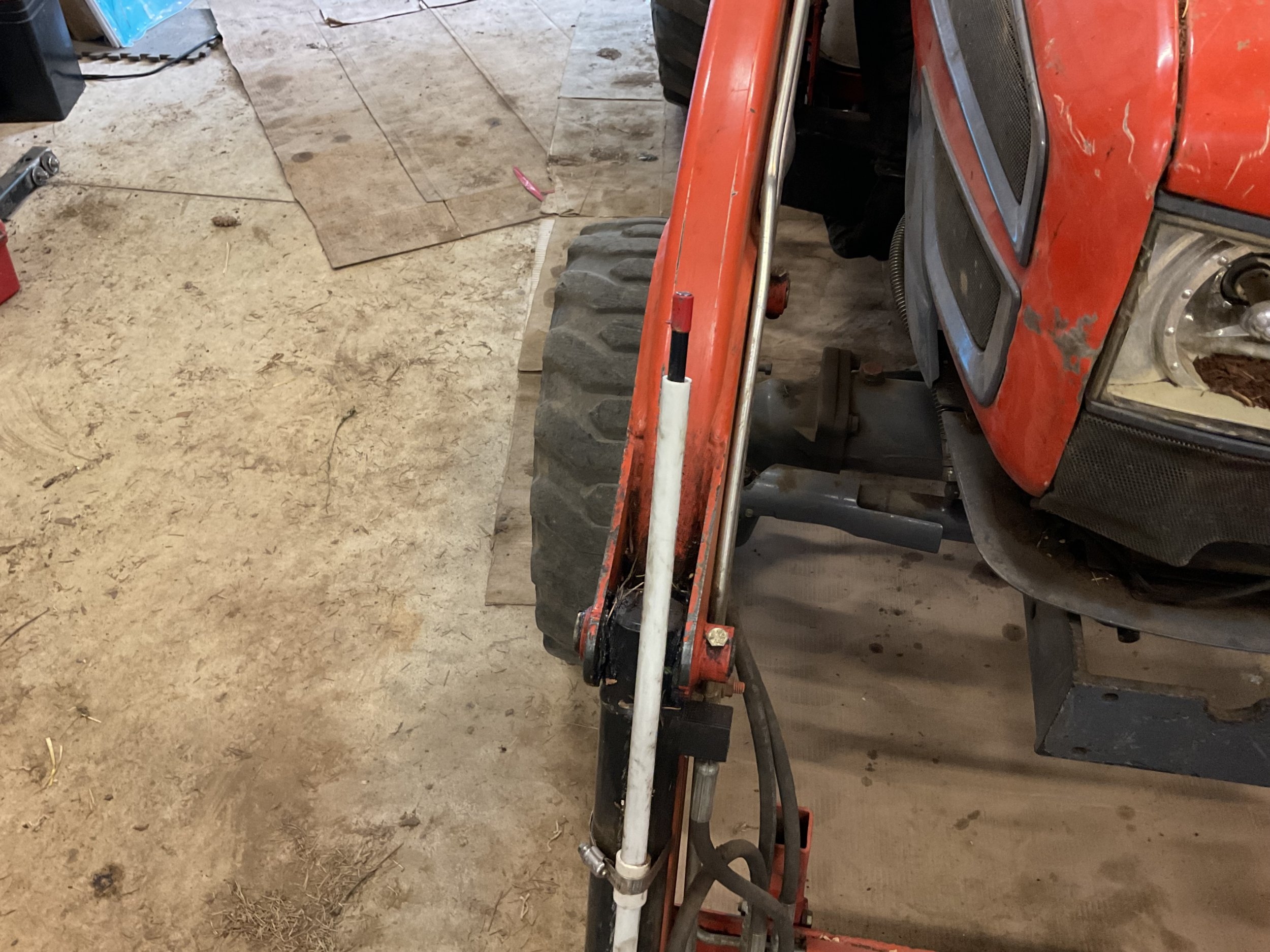

This is what I did. I ordered the rod from my Kioti dealer and then fabricated the rest from PVC pipe the pictures tell the story!
We have a CK25 2005 model! IMG_5388.jpegIMG_5385.jpegIMG_5386.jpegIMG_5388.jpeg
