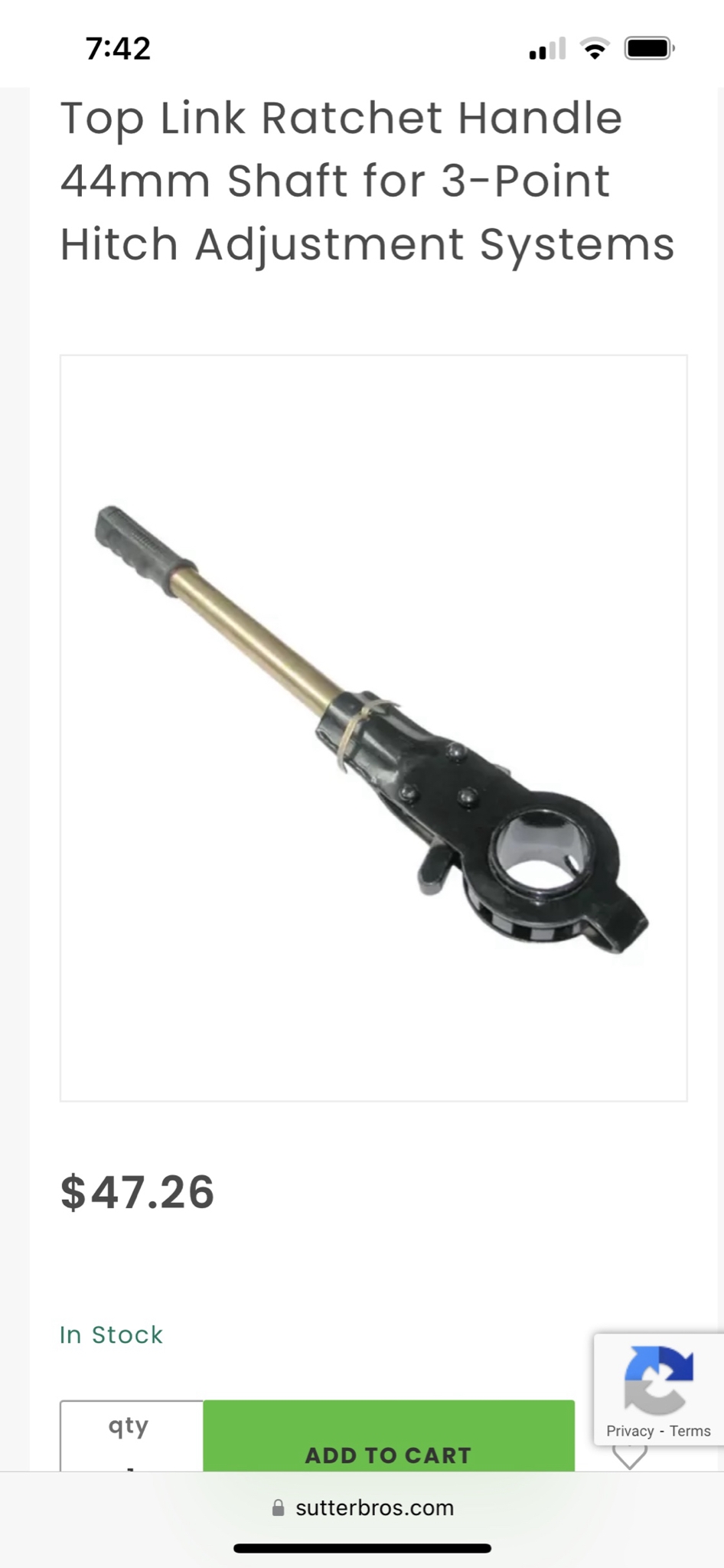

I have a Massey GC1715 compact tractor. I would like to make it easier to adjust my top link.
I added pat's quick hitch to mine and I had to buy a new top link because the massey top link was not long enough. I came with a bar for adjusting. I used a large pair or channel lock pliers before that.
   / Anyone make a ratcheting wrench for a cat 1 top link? #13
Like a load binder with spherical bearings at both ends?
Why not? It ought to work to use a modified chain binder with different ends as a 3pt top link.
Only downside I can see is that a chain binder only works in tension, while a 3pt top link has to stand up to compression as well.
For a threaded rod - or any column - not to bend in compression, it has to be larger than the same shape that only sees tension. That's the reason why top links are so beefy. So it would make sense to use a chain binder with similar large diameter adjustable threads.
go for it,
rScotty
   / Anyone make a ratcheting wrench for a cat 1 top link? #14
   / Anyone make a ratcheting wrench for a cat 1 top link? #16
Well ... It's an option ... What I do if I can't turn the top link by hand, because the weight of the attachment is on it, I take my wrench that I use to loosen the jamb nuts (1 3/16" IIRC) and stick the tip into the little loop and turn it, could also use a sturdy screw driver, but I already have the wrench in my hand
#17
I currently do it the same way with the opened end wrench and screw driver. I really only need to adjust my top link when I’m using my box blade. At different times I like to adjust the pitch and would like to make my adjustments without getting off the tractor. I’ve dropped the wrench too many times and had to get off the tractor. The hydraulic link isn’t an option. The ratchet handle looks better than the chain binder. The wheel attachment looks weird but for an older man that’s losing his coordination, it looks pretty handy to just reach back there and grab the wheel to make my adjustments on the fly. I’m not sure how any of this would work with my jam nut as I need the nut to keep my link from turning.
Maybe I’m thinking too much into the jam nut but anything that has been mentioned would be better than me dropping my wrench all the time.
I’m going to give this more thought before I make any decisions. Thanks for your ideas.
