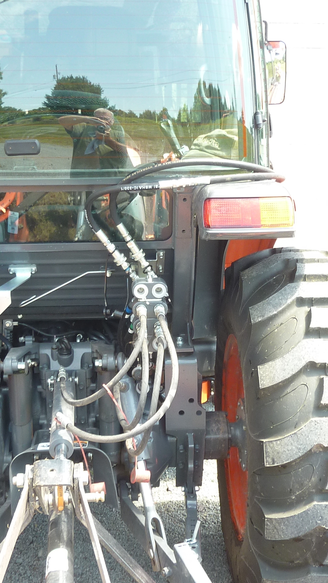

In order to add a 4th remote on my L6060, I added a 4th OEM breakaway coupler housing to the stack.
I then ran hyd. hoses forward and connected them to the 3rd function valve:
A diverter would have been cheaper, but I already had the 3rd function valve installed. I only have a couple of implements that require 4 remotes. I don't use them often, so I didn't bother routing the hoses under the tractor for a more permanent install. I might do later if necessary.
