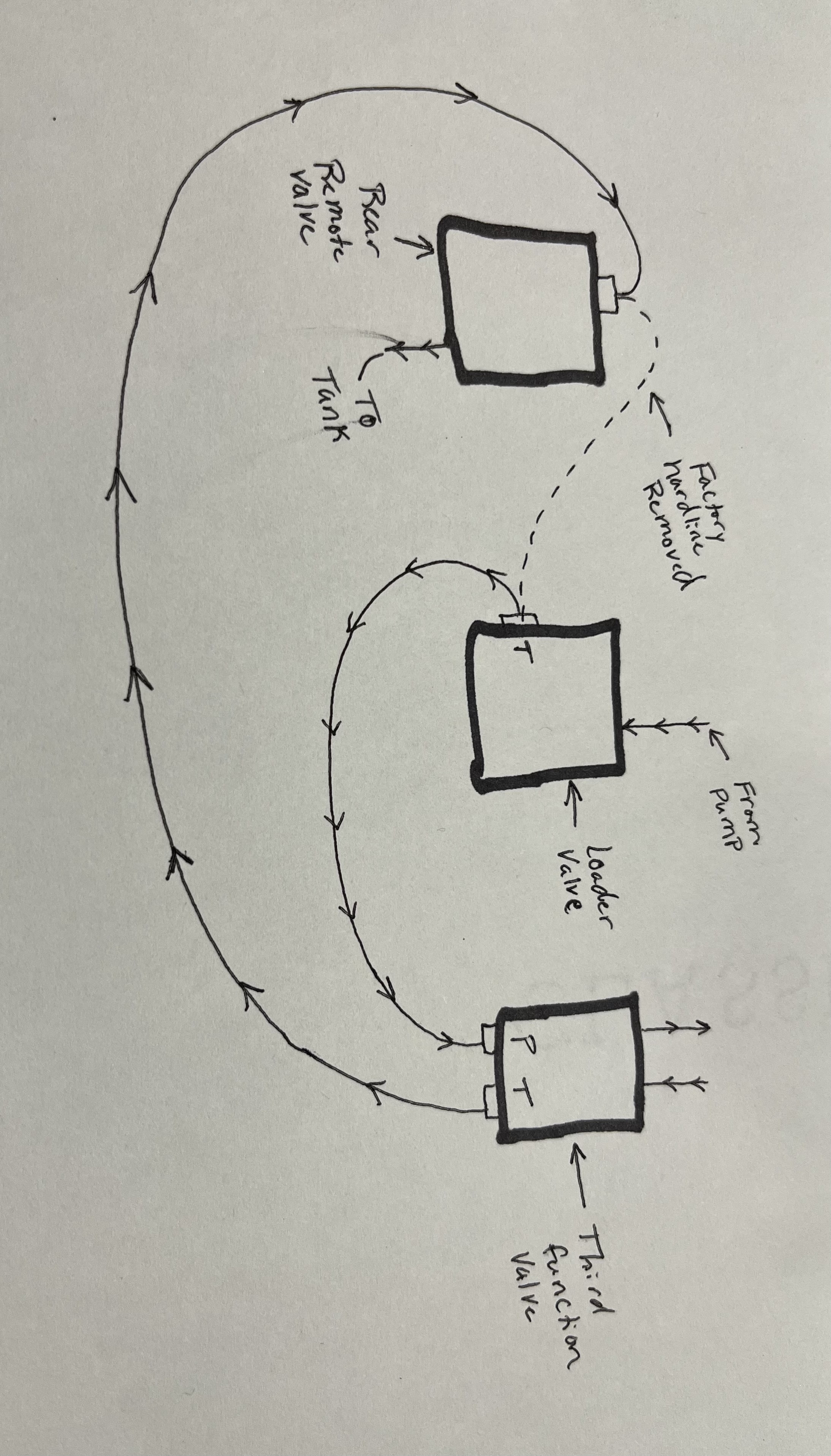

I have a 2021 Kioti CK3510HST with factory rear remote hydraulics installed to run a backhoe. I decided to add a third function kit to the front end loader to run a grapple. I went with a third function kit from Summit Hydraulics. The kit runs the grapple just fine but the problem is that I lost the majority of my hydraulics to the backhoe after installing the kit. The backhoe operates extremely slowly and lacks power (the outriggers won’t even lift the tractor anymore).
I have attached a diagram that I drew showing how I plumbed the kit in. What I did is remove the factory hard line going from the port labeled “T” on the loader valve that goes into one of the top ports of the rear remote valve, basically putting the third function valve in series. I explained to the service guy at my local dealer how I installed it and he assured me that that I had it plumbed correctly and suggested an issue with the third function valve not allowing enough fluid to flow through. To test this theory I put quick couplings on the two hoses going to the third function so that I could couple them together and create a loop taking the third function out of the equation. By doing this the backhoe picked a little bit of speed (not much) but it still lacks power. I suspect that the distance of hose is not able to carry the volume of hydraulic fluid that the short hardline can.
If the way I have everything plumbed is actually correct, why would I be having is issue? Is there another way of hooking the third function or maybe a different set of ports that I could hook into that would separate the third function from the fluid supply to the rear remote (leaving the factory hard line intact)? I know I can’t be the only one that has come across this issue.

The valves need to be connected in series on machines with a fixed displacement pump.
On most tractors the flow goes from pump to the front loader valve. Then power beyond from loader valve supplies next valve which in your drawing was the rear remotes. Typically power beyond from rear remotes supplies flow to the 3 point hitch.
You need a power beyond option the 3rd function so that it can be in series.
Typical plumbing would be power beyond from loader valve to pressure port of 3rd function, power beyond of 3rd function to pressure port of rear remotes. The tank line of loader valve must go directly to tank. Depending on style of 3rd function it may also require a tank line going directly to the tank. This can be teed into the tank line from loader valve.
Hope this all makes sense.

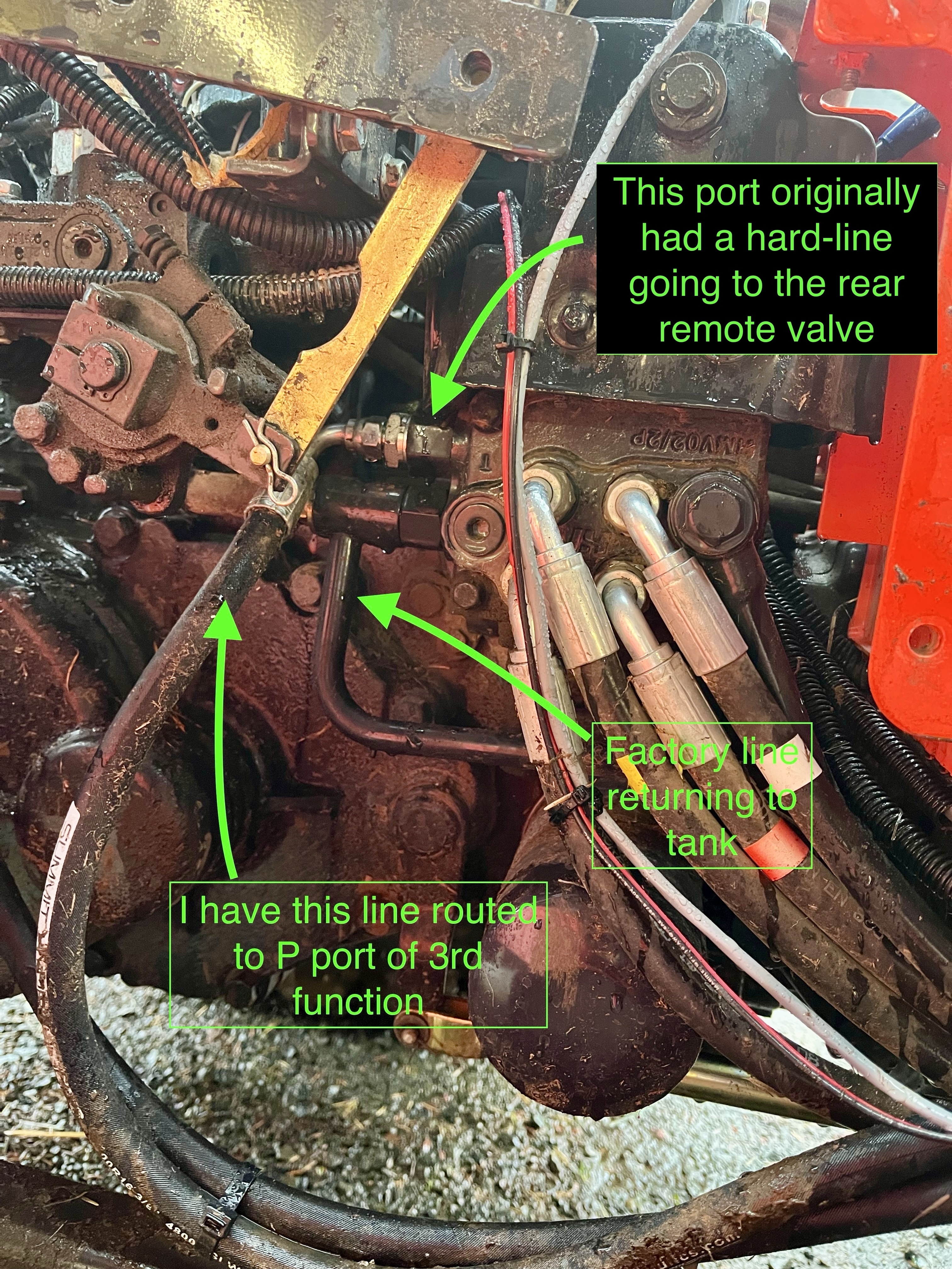

Thanks for the reply. I believe that I have it plumbed as you describe it. After taking a closer look at some of the pictures I took when I had it apart, I think that the "T" stamping is referring to the port below where I am tied into that returns to the tank. I think I do have the third function connected to the power beyond port of the loader valve as the grapple functions fine. I attached another picture that might help to show how I have it hooked up. If I am understanding correctly you are saying that I may need a different third function kit that has a power beyond port to be able to have an in series installation?
If this is the case when I added couplings to bypass the third function like I mentioned in my original post why would I still have a lack of hydraulic function at the backhoe?
Not sure if anyone has any experience with the Kit from Summit Hydraulics. When I talked to them on the phone they seemed to think the way I had it plumbed was correct but didn't really have any insight as to why I am having issues.

Looking at picture is that a steel line and banjo fitting on top right corner of valve?
Where is pressure line located on the loader valve?
I am trying to figure out how loader valve is plumbed since I believe problem started when 3rd function was added.
Do you have pictures or literature of the 3rd function valve?

The steel line at the top right coming from the pump. I found some literature online confirming that I am connected to the power beyond port (upper port on the left hand side). Here is a diagram from the 3rd function valve instructions.

That diagram puzzles me, Were is the pressure from the pump feeding that?
Normally the pump would supply the loader valve (P), from the loader valve POWER BEYOND to your 3rd function P, from the 3rd function tank to the rear remote P.
Then the T from the loader valve and the rear remote T both go to the T (return).
Also all the flow for the rear remote has to pass through the porting of the 3rd function. I don't like 3rd functions so I have not paid much attention to them, I prefer diverter valves, but that's me.

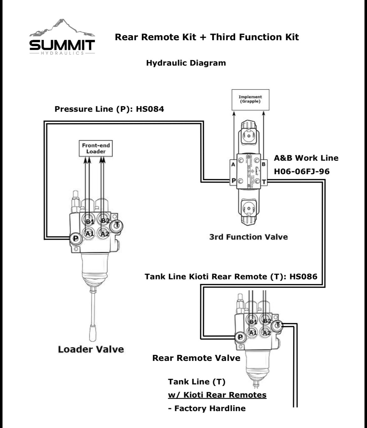

There is no PB port on your Summit H06 valve. You can't use the 'T' line to power the next valve in your series (the tractor AUX valve). That line is limited to 500psi, usually.
I believe the Summit valve is industrial style D03 subplate mounted valve so tank port is potentially rated to 3000 PSI.

So I was reading the documentation on the Summit site. Then looking at the photo you posted of your valve setup. I'm going to copy and paste what they have on their website. I count 7 lines on your valve. If that is correct you have it plumbed wrong according to what they have on their website. Here is their verbiage about it. It appears you are connected at the tank fitting and if you actually have a "PB" port then you are not getting the pressure and flow needed for the backhoe and 3rd valve. I may be seeing it completely wrong and if so tell me. It's early yet and I have only made a few mistakes so far today so I haven't hit my quota yet.
How do I find my power beyond on my loader valve?
"Typically, there are seven hoses or steel tubes connected to the loader valve. If only six hoses or tubes; there is no Power Beyond Port on your loader valve. The 1st four are connected to your loader for the up, down, dump, and curl functions. The fifth line comes from your pump to feed your loader valve. The sixth line goes directly to your reservoir so that when the pressure relief valve opens the fluid is dumped directly to the reservoir. The seventh line is connected to the “Power Beyond Port” on your loader valve, which is used to power other valves beyond the loader valve. On some loader valves there is a “PB” stamped on the valve next to the power beyond port. Some loaders indicate their power beyond port with green tape or a green mark on the hose or valve. Some loader valves have a power beyond sleeve inserted in the power beyond port. This sleeve looks like a nut; however, it is 3 to 4 times longer than a normal sized nut. On some loader valves there are no clues to help determine which connection is the power beyond port. Your owner’s manual may not even indicate the location."

This is a picture from there installation instructions showing which port is the power beyond port. Based on this I think I have it plumbed as they have it shown in their installation diagram. I think it the location of the "T" stamp is a little misleading because it is closer to the upper port than it is the lower (tank) port.

It is definitely not the greatest diagram the they provide. I'm assuming that the port they have labeled "P" is actually the power beyond port and they just aren't showing the pressure line from the pump. If that is the case then the routing they show aligns with how you described it.
