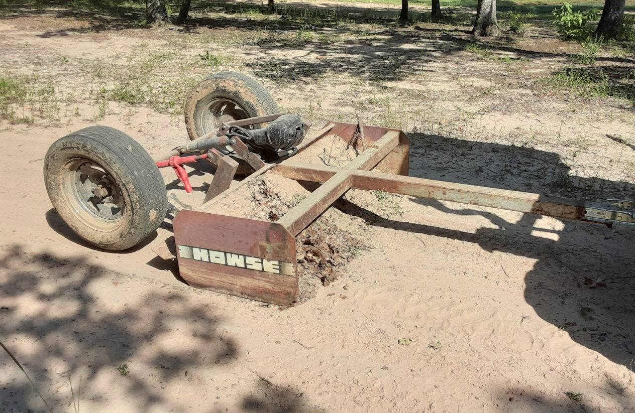

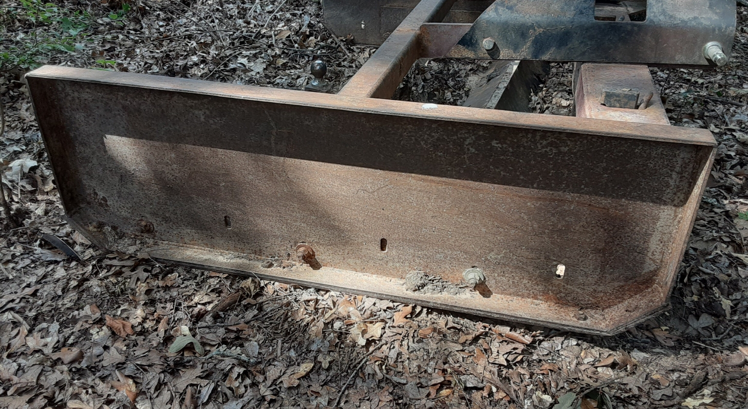

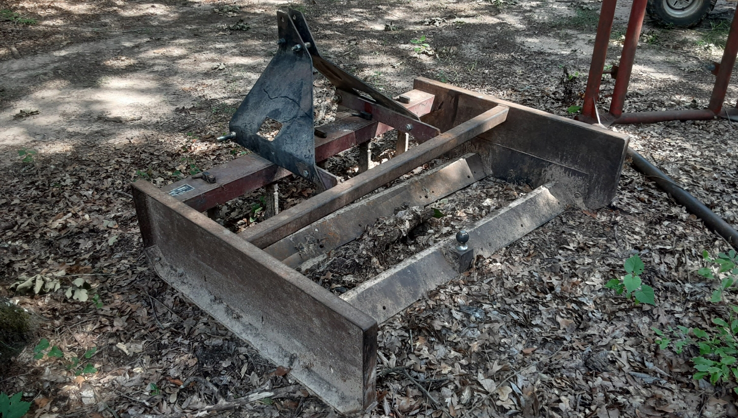

I made the one I have from a box blade and welded the blade mounts to sheets of steel that line up with punched slots in the side. This allows you to lift the blades completely above the surface you are dragging over, only allowing a "cut" on high spots.

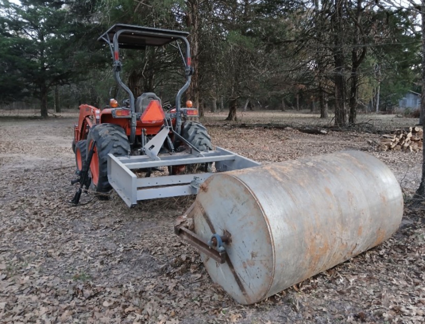

That 2" ball on the back is so I can drag this 3000 lb roller behind it for compaction.
Cutting up the box blade for the plane also gave me a box I could use to drag over lose material to level with.
I do have a hydraulic top link but I don't use it with either of those.

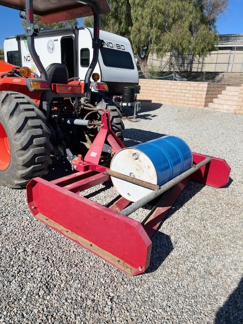

Speaking of tuning attachments. I put a cylinder on my rake so I could change the angle on the fly. I added a water barrel on the LP so I could cut the hard packed washboard on the road. A water barrel allows infinite weight adjustment depending up the volume of water up to nearly 500 pounds.
That's a very nice setup Scootr!
View attachment 5051355View attachment 5051354
Do you find that the ripper teeth are needed alot with this land plane setup?
If I am maintaining roads, they are up. More often than not the rippers are up with blades cutting 1/2" below skids.
I have used them on ground where I would have otherwise needed to go get something else to tear up the ground first.
Quicker to raise/lower them than swap implements and they already existed.
I have also never needed to add any additional weight to it.
