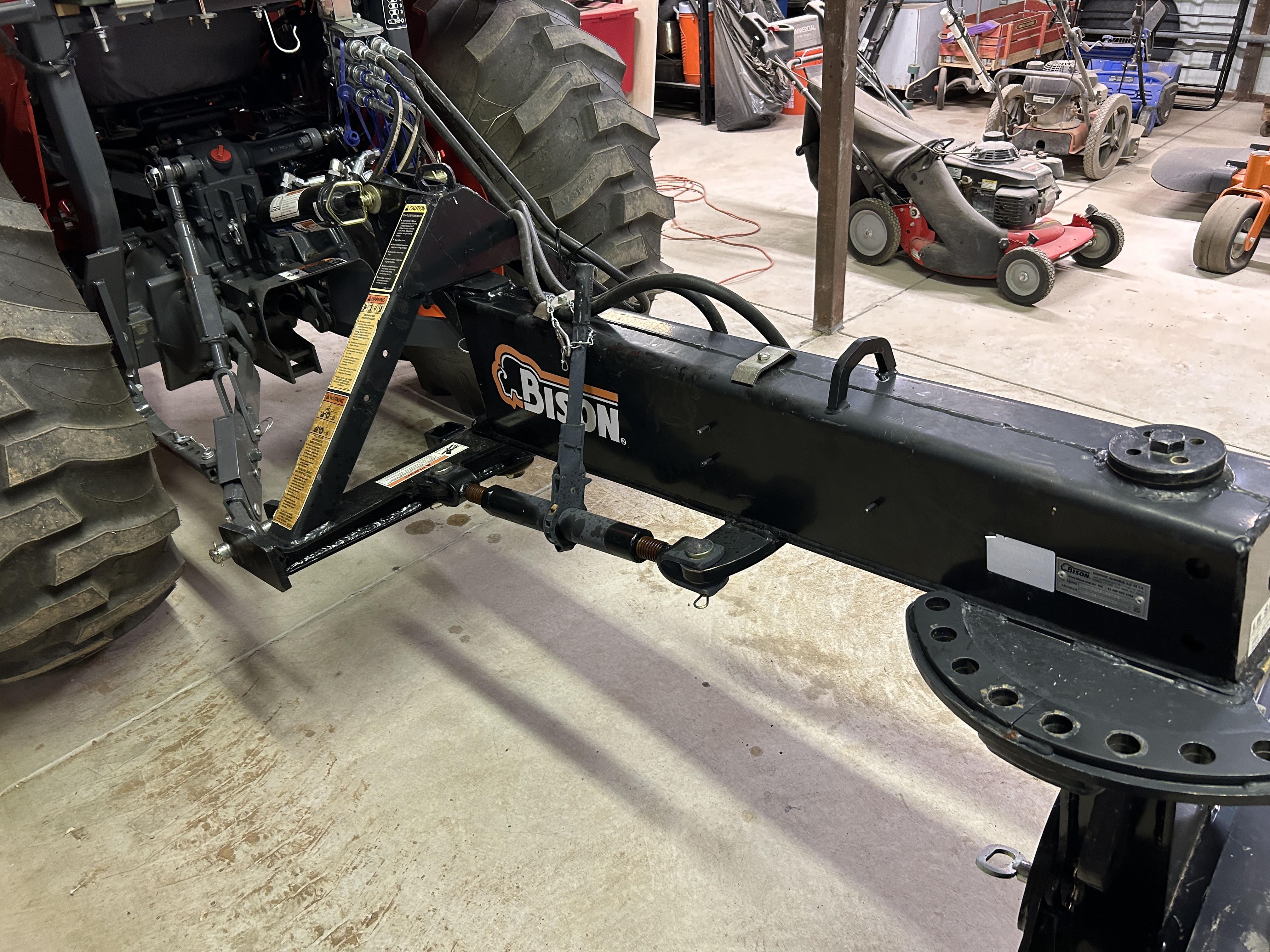

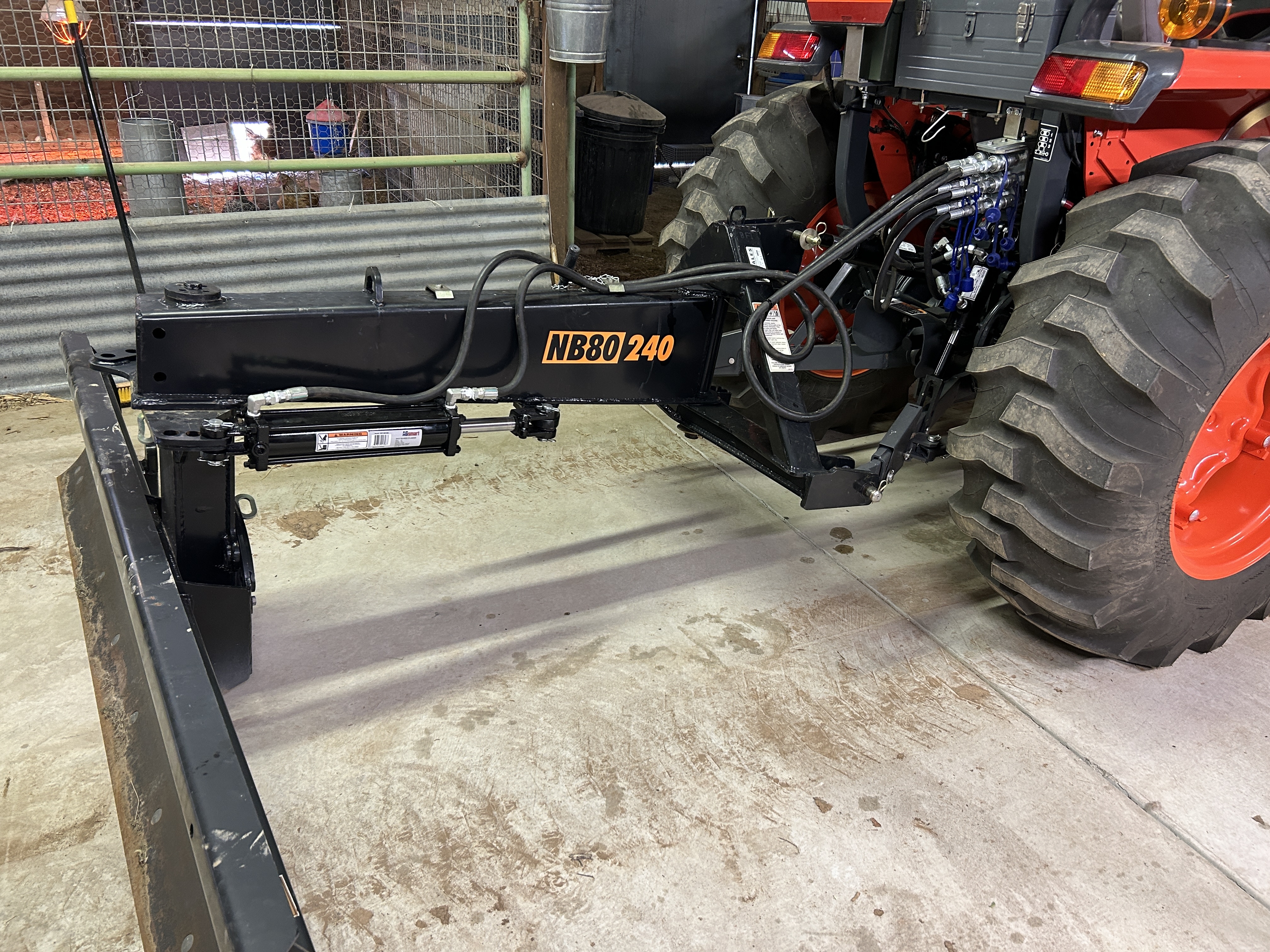

So, I use a Tufline 6 footer grader blade ($250) which can offset to the side and angle/tilt down. With my hydraulic top and (especially) the side tilt, I can get a pretty aggressive cut for my ditches. I also can only cut by following my rear tire. I can not cut a ditch from the top surface of the road... that would have too much leverage and it would just drag your front tires over (into the ditch).
I don't see any hydraulics on your tractor so you might be limited in what you can do.

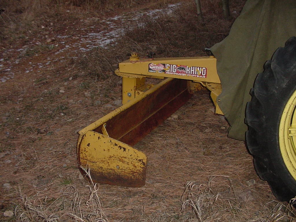

Say, your Tufline looks like our similar vintage 8 foot "Big Rhino". Anyone considering one should keep in mind that these big old 3-way blades needs a larger tractor when offset with a tilt & angle. A rear blade for ditches and crowns needs to be 3-way adjustable: offset, tilt, and angle.
Gotta wonder what a new 3-way Tufline would cost today? I suspect that $1000 for a used one is a steal. Those big 3 way blades used to be offered as manual adjustable for economy, which could be later be converted to hydraulic control with simple kits.
I'd try to borrow or rent one before buying it. Too much depends on the OP's ditch material and such to tell if his tractor would pull it. We use a 6000# long wheelbase tractor with a Cat. II 3pt. with the Big Rhino blade.
Even so, any tough spot pulls the tractor sideways pretty easily. After using our blade for years, my opinion is it can be made to work, but I'm not convinced that even a good 3-way blade is the right tool for the job. For one thing a blade hung out like that from the back end of a tractor pitchs up and down a lot. Maybe a gauge wheel would help....but there's another hydraulic and another grand or two.

Big Rhino 3-way & Little Rhino 3-way.

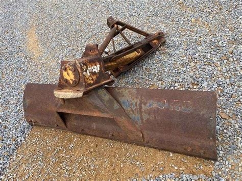

About 15 years ago DW and I were out driving around and she spotted one of these old Ford 6' grader blades with horizontal swivel and vertical tilt leaning against a tree with a for sale sign.
I can set it so it acts like a double-shovel plow and dig a pretty good ditch.
Mine is in better condition than this picture.
If anyone wants, tomorrow I can go snap a picture of the nameplate and edit this post.
This one is swivel and tilt, and for sale: https://www.schneiderauctioneers.com/auctions/30324/lot/14856

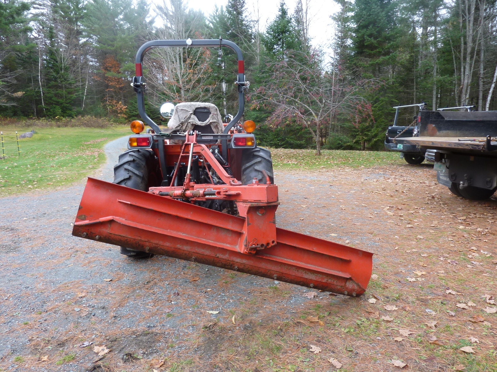

I run a Tufline GB1 7 foot.
Here in VT, It's too rocky to do much without tearing stuff up.
But it moves soil, and gravel just fine behind my 35 HP tractor. The ditches on the side of the 500 foot long, steep incline drive, are ledge and bony fill. Hard to do much with it.
Your conditions may differ.
A back blade with tilt and offset is the tool, even if it takes a bunch of passes and some hand work.
That's the same thing I have and I agree you have to be careful where you use it in our bony ground. But just cleaning loose stuff out off an already formed ditch works OK for me.

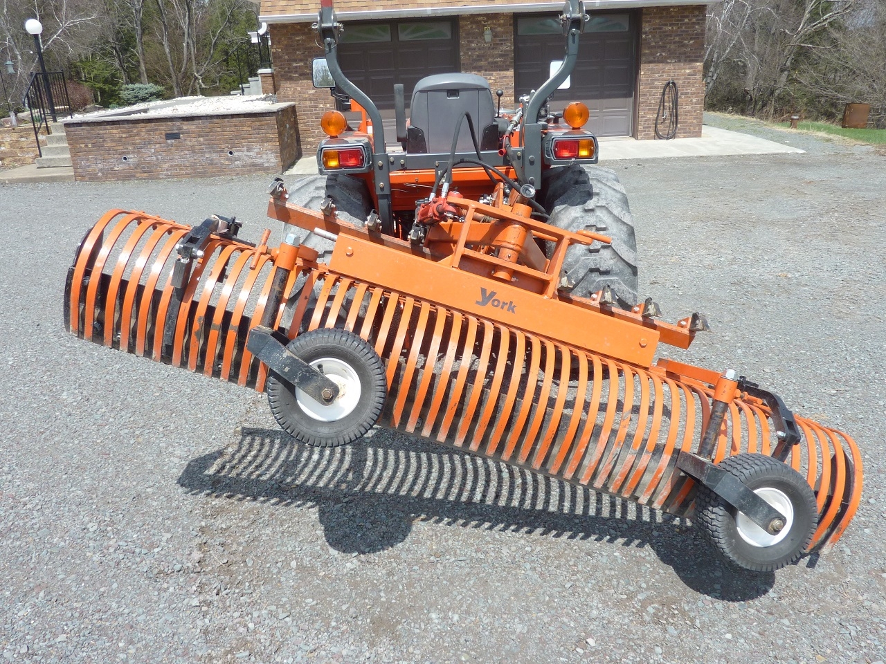

I use an 8' York rake and T&T kit which gives the blade a 15 degree pitch.
I offset the 3pt as far as I can and it does a good job on the ditches.
The only downside is, dragging the spoils back up onto the road requires regrading the surface. The mud & grass can make quite a mess.
My old Kubota L3430 had no trouble pulling the rake, but I don't know how well it would work on a smaller tractor.
   / attachment for cleaning/creating drainage ditches along gravel road #19
