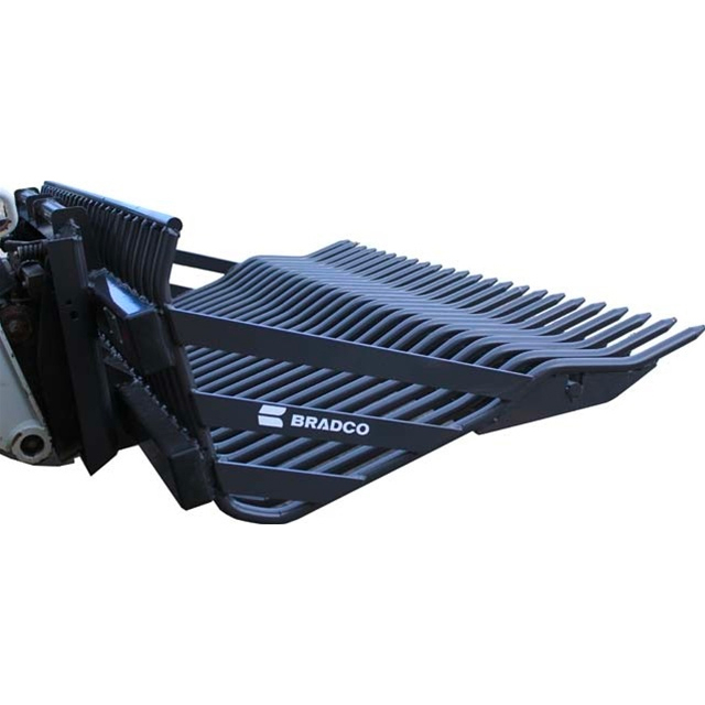

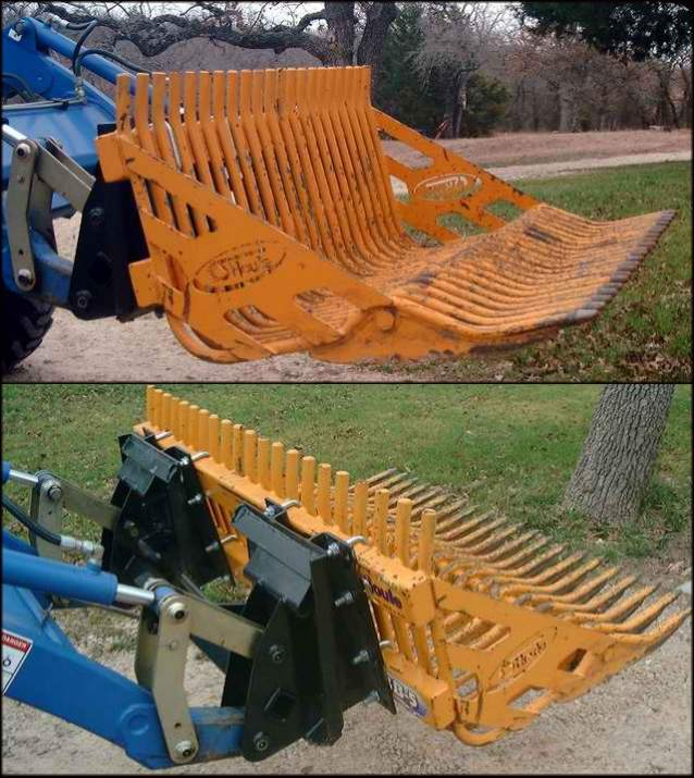

Below are some 2 pictures of an inexpensive no-name rock bucket that has the flame-cut rectangular section flat tines. I bought it originally about 15 years ago for just under $1000 & used it a few years. The flat tine bucket has fabricated points on the tines.
Below that are several pictures of better working Round Tine rock buckets. One yellow Houle & one black "BRADCO" - I've been mistakenly writing "ADCO", but it's a BRADCO. The Bradco cost $1800 ten years ago. Compared to the flat tine bucket, the round tine type is a foot longer front to back, slightly lower overall, and the tine spacing is half an inch closer together. Plus it has that weird rounded bump in the front. A small feature that is probably responsible for a lot of the extra cost.
The difference in the way they work is subtle but real. I'm one of those guys who loans tools to friends... and everyone wants to borrow the round tine bucket. For skidloader use I only loan the flat tine bucket because I don't care what happens to it. The round tine one is special.
In use, the round tine pushes into a pile with less resistance, and will even slide under some rocks and the ends of logs. Dirt passes between the round tines easier when shaking the load to sort rocks from dirt. And rocks don't tend to get stuck between the tines. When doing successive fills, that odd rounded bump near the front of the round tine bucket holds rocks & trash at the back of the bucket while using the front to scoop up more load.
For use like forks - well, I should say "sort of ....but not completely. Nothing replaces good SSQA forks". But this will do some of the same work. Look at the pictures. The round tine bucket has an open space forward of the side supports where you can pick up logs longer than the bucket. That is an advantage that forks have and that this round tine rock bucket also has. Regular dirt buckets won't do that very well at all. And although the round tine won't spear a pallet securely like forks will, it is long enough to slide under a pallet with the tines then being long enough to enable some palletized loads to be lifted and moved. Again, not as good as forks, but much better than a standard dirt bucket which won't do that because the back of the bucket is too close to the lip to get fully under a standard pallet.

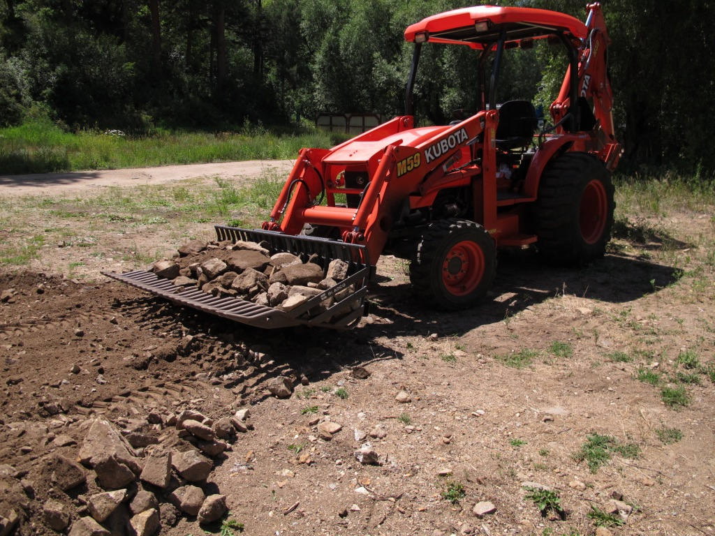

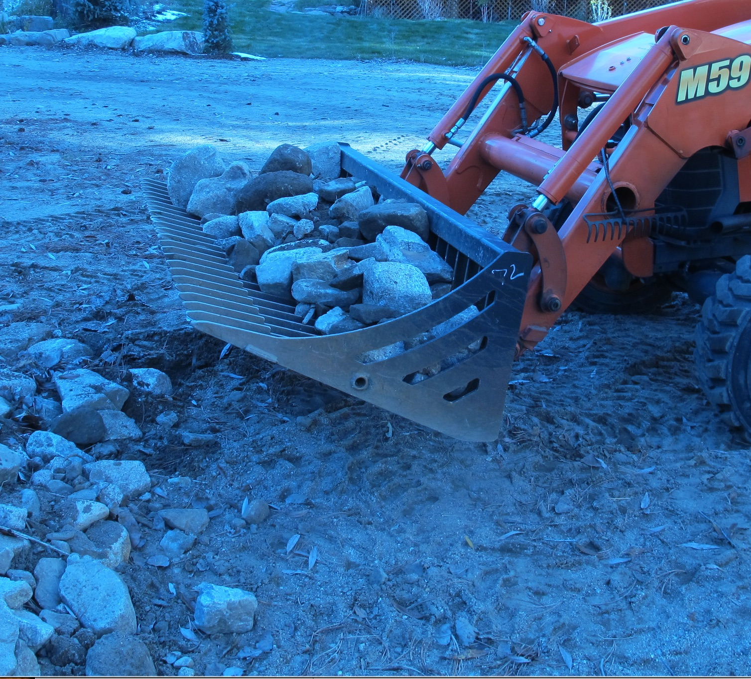

Just a little more on rock buckets and also grapples.
In the pictures below, the tractor is actually a 60 hp Kubota M59 TLB with 6 speed HST & wide industrial tires. It weighs 8000 lbs with the backhoe - and the FEL is not removeable - although the bucket is.
That 72" rock bucket pictured weighs about 700 lbs, plus there is that much more weight in rocks and about to be twice that. All that weight is fine in a machine that size. But it is more machine than you are looking for at present.
For a smaller tractor or one with less gears available, it can be a mistake to use wide heavy implements for dirt and rock work. Many times you will get more work done by reining in the desire to buy big and just buying a size to fit - approx.same as tire width, or even a half size smaller.
A smaller tractor with correctly sized implements does a lot of work.

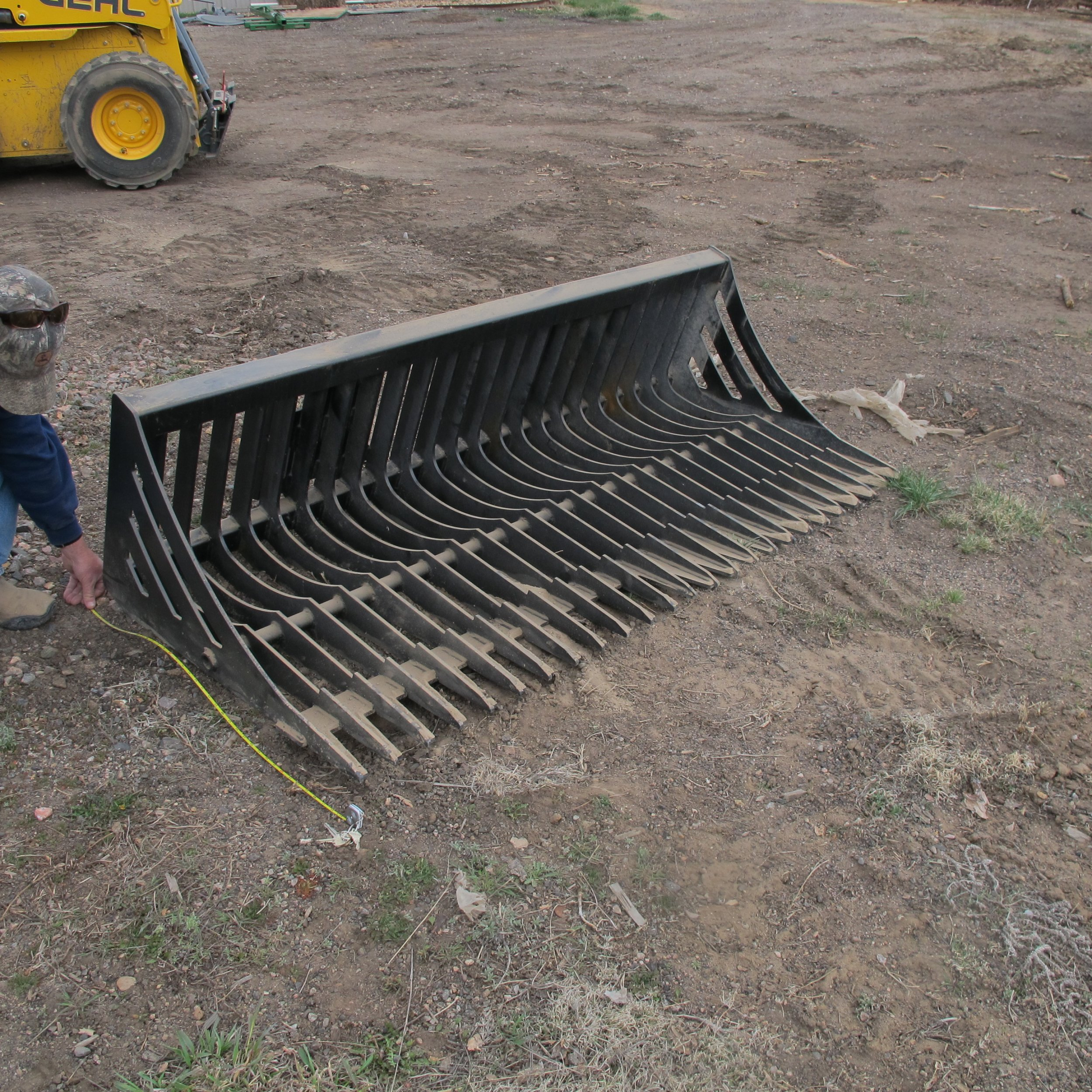

Ok. Understanding a little of what you're saying on the round tines version vs the "normal" ones.
And thanks for the note on the sizing. that makes a lot of sense. The max width of the tractor I'm looking at is about 64 inches, so I am thinking a 60 inch rock bucket then??
And I did a little research and watched some videos on rock buckets last night. Seems like I would want to get a Rockbucket/Grapple combo attachment. Rather than a separate grapple.
Since I'm not clearing fields for planting, I'm not expecting rock clearing to be a large part of what I'm doing. But a rock bucket with small or no sides, and with the grapple included, seems like it would solve quite a few problems for me and let me use one attachment rather than switching between several. I'd think I would want SOME side walls, even if just in the back of the bucket if I can find one like that.
What do you think about doing a version with no or little sides? I looked at the Stinger ROG bucket with grapple last night (simply because a guy that lives in my area did a really useful review of this companies model)
https://stingerattachments.com/buy/skid-steer-rock-grapple-open-sides/#
Doesn't have the round tines and is pricey, but is an example of what kind of a design I'm talking about.
