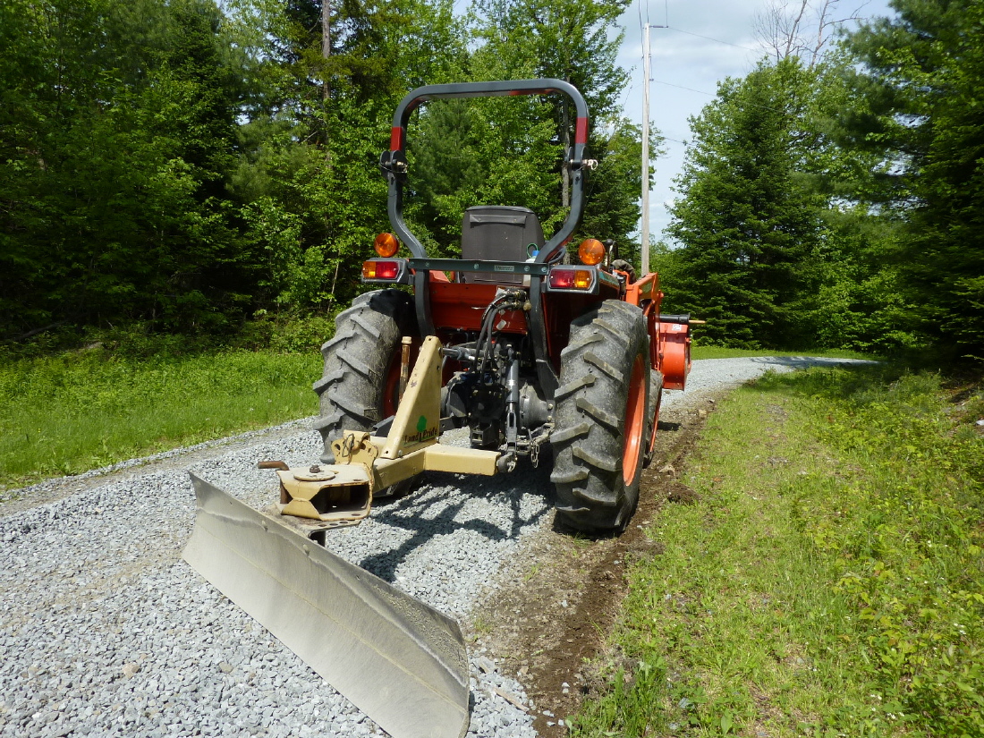

If your surface material is just loose rock and not gravel that packs the back of your rear blade should work pretty good. If you can't turn the blade around 180 you could just drive backwards. With the straight edges you say you want you have to be turned around backwards anyways watching the blade all the time with a hand on the controls making continuous little adjustments. This is 3/4" crushed ledge. Spreads nice with the back of the blade.
Or make a wooden drag like a landplane. RustyIrons idea sounds good too.
