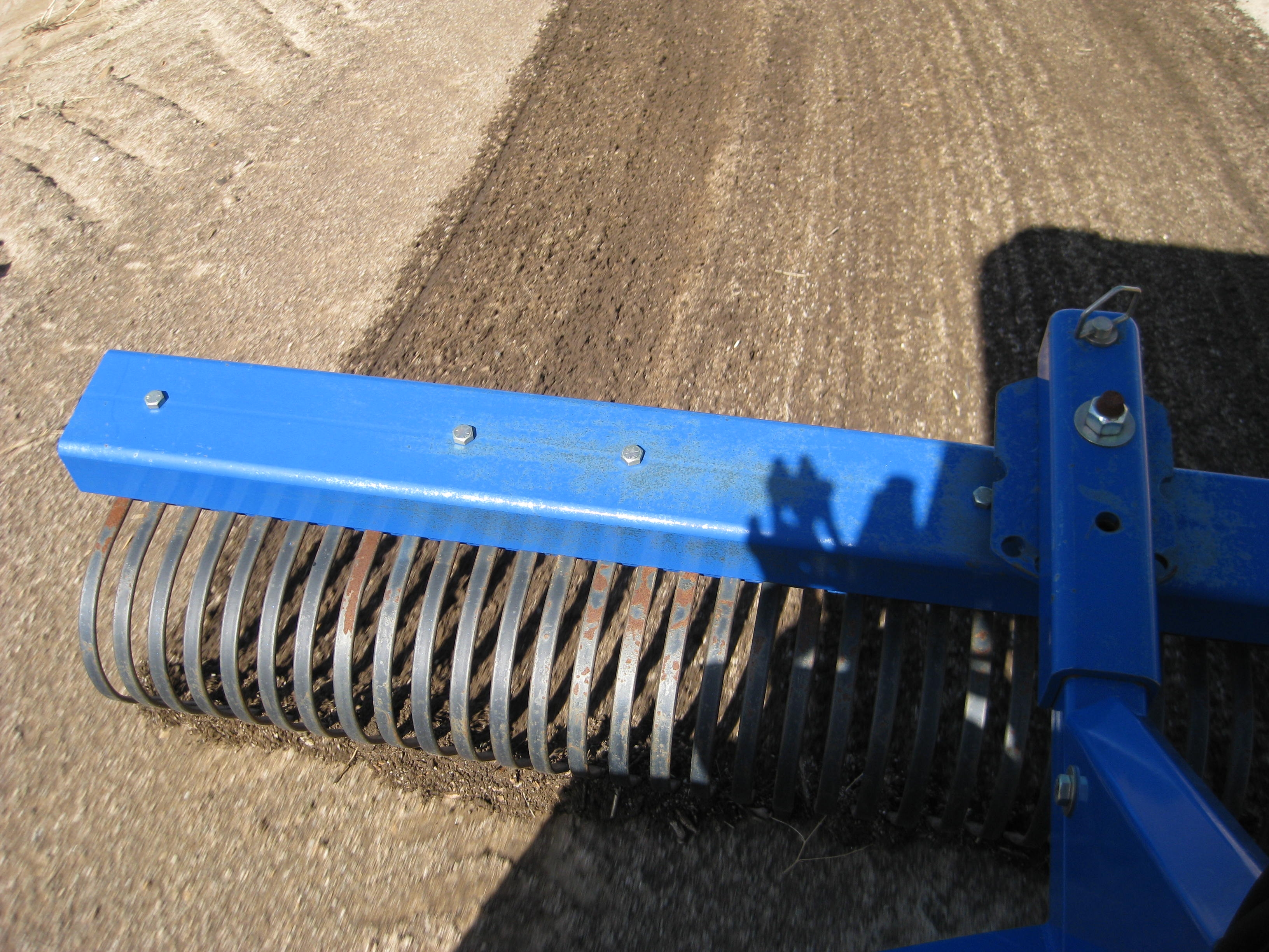

It's true there is no one attachment that works for all grading situations. Which is why we all need a collection of attachments ;)
All of these get used on the road. It all depends on what needs to be done.

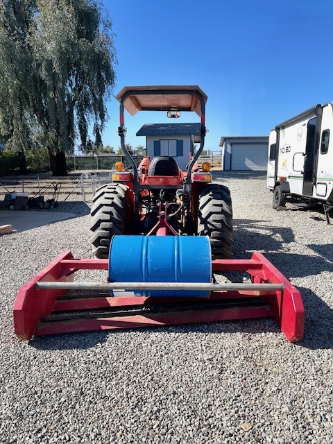

Sometimes our road gets hard and has a lot of washboard created by fast drivers. When that happens I ask the neighbor to drop a load of water on the road and I add water to my weight barrel to cut better.
That seems like a very simple solution, I have some plastic drums and water so I may try that if needed. I don't have hardly anyone but me the wife and deliveries use my driveway. Occasionally an explorer that quickly leaves once they realize the driveway has a homeowner at the top. I have it posted at the bottom and middle but those ATV and UTV drivers seem not to care about a silly sign.

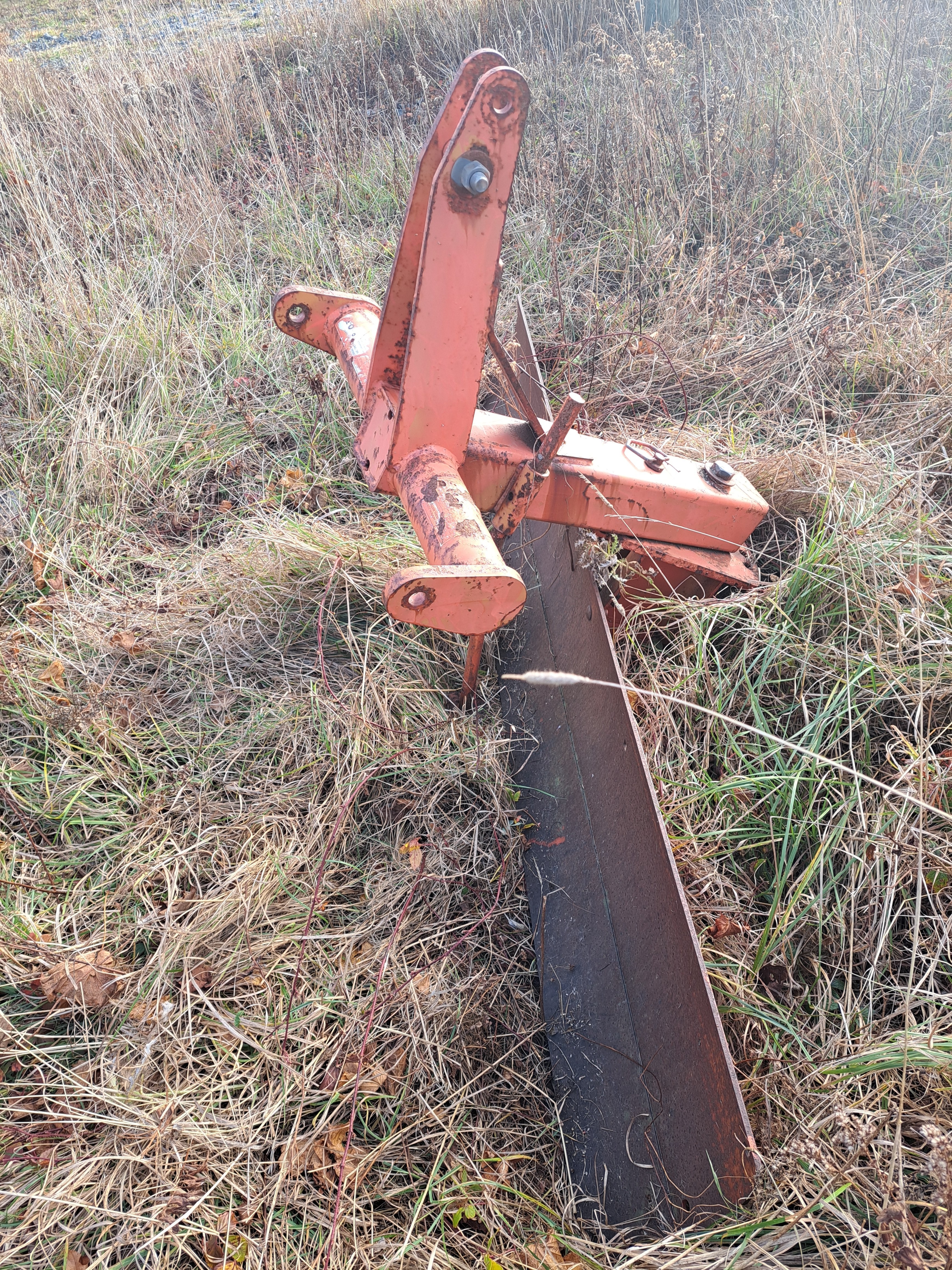

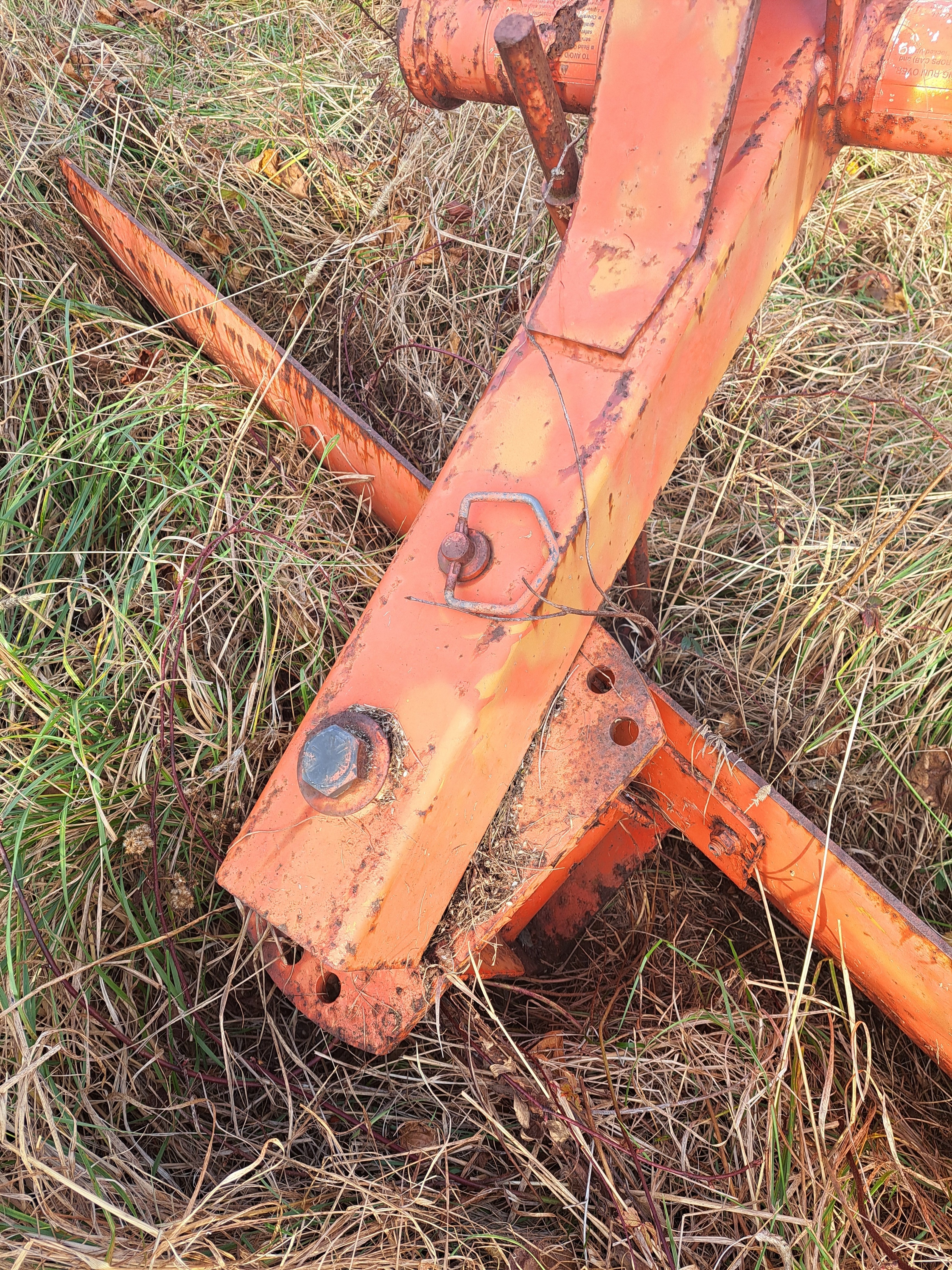

Sorry to jump in. What's this worth. Friends Dad died and didn't take it. It's not worn or even worked just a bit rusty. 7 ft blade.
