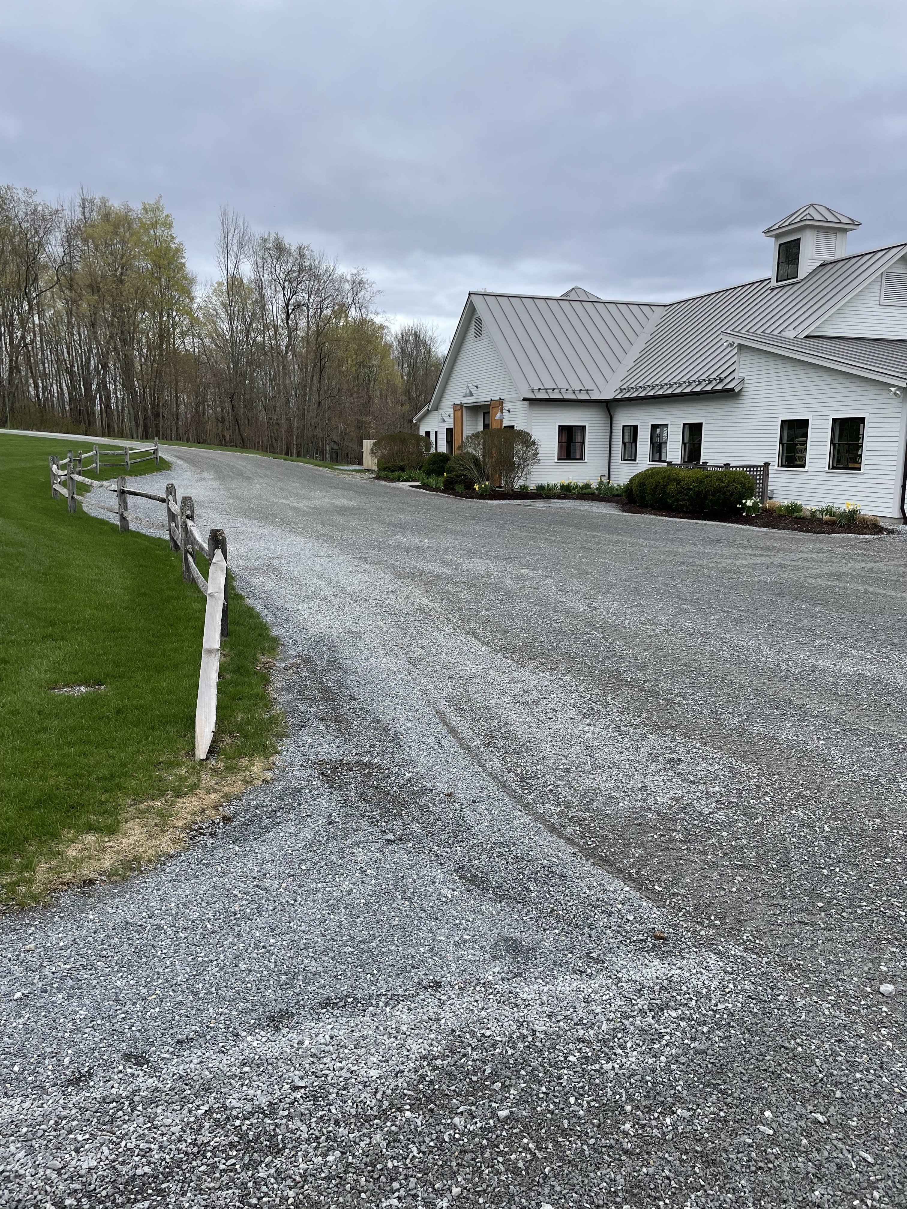

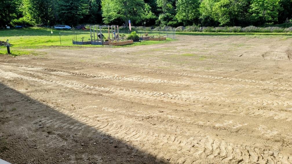

I have both. I have a heavy duty 8' original Harley Rake which is PTO driven. It's an expensive attachment to use on a gravel drive. Though heavy duty, I'd be concerned it would beat itself to death and wear out quickly using it on gravel.
It's spectacular on dirt for grading and windrowing debris like stones and sticks from dirt for final finish for a lawn, but I would never use mine on a gravel drive.
Landplane is my first pick for maintenance on the gravel driveway. It's fast, and made for that type of activity.
1st pic is lawn before Harley Rake, 2nd is after. 3rd is driveway using the landplane...
/ Land plane Vs. Harley rake #6
View attachment 3373862View attachment 3373863View attachment 3373864

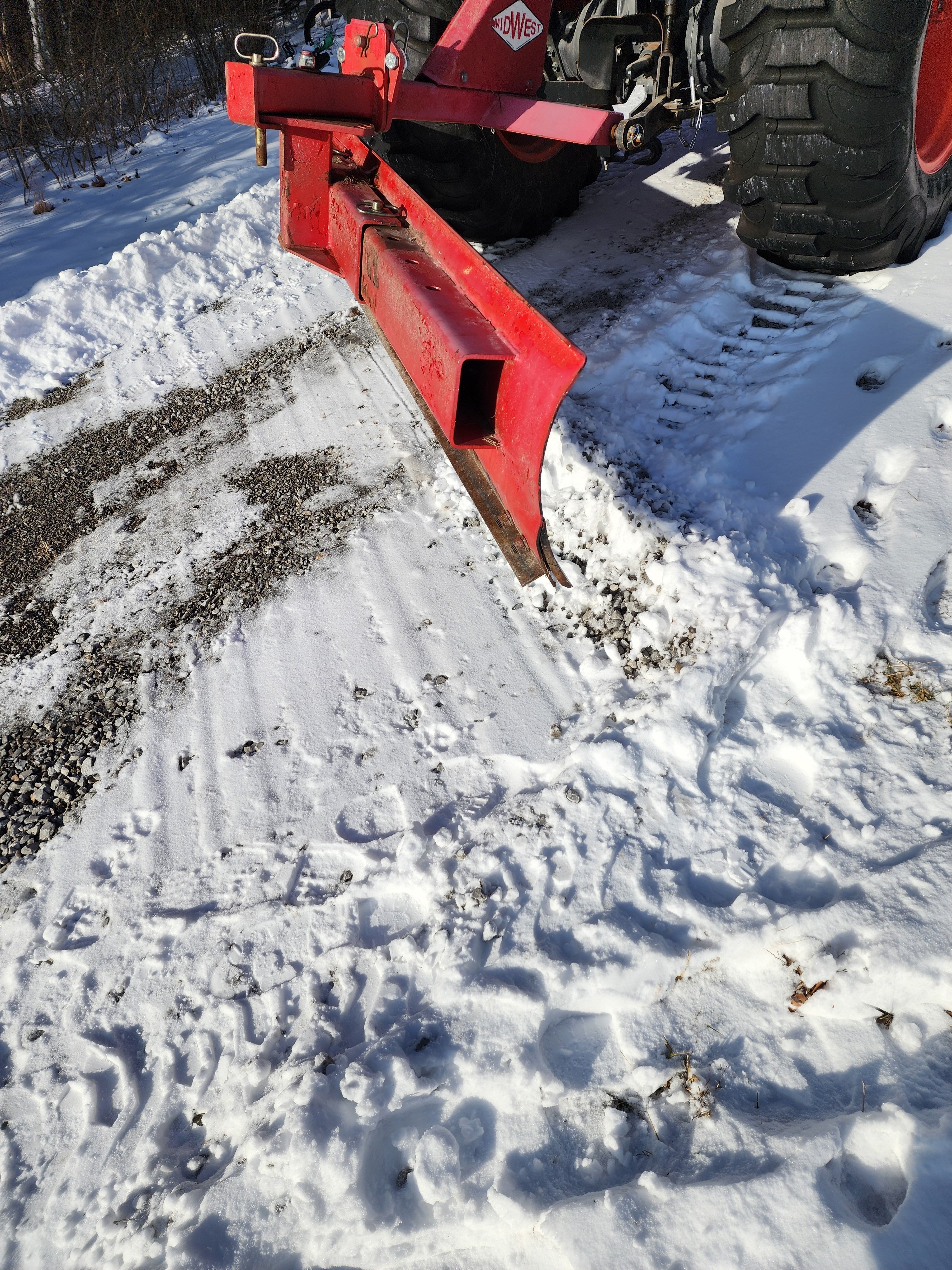

You do not say what happens with the current implements. I am guessing that they dig in, then leave a ridge at the end of the spread. I was searching for solutions for this when removing snow. What I found works for me is a piece of angle iron clamped between the blade and the frame. It works in spreading gravel also. Because the angle iron is a 90 degree bend the overall angle of the attachment is unusual. I may take some flat stock and weld one up with a different angle.
It is an inexpensive solution if it works. Have not tried it with the box blade.
