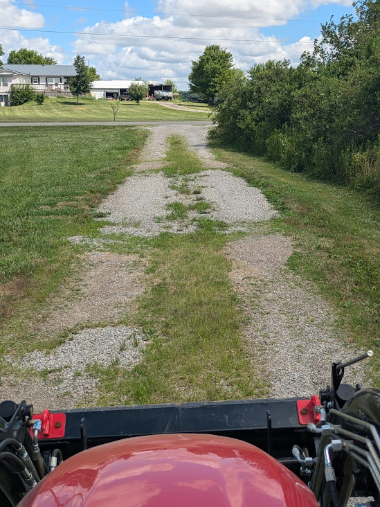

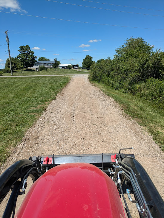

I have a new BEFCO I'll try to remember and measure it and take a pic where the blade is on the carrier. I haven't changed the adjustment and it does an amazing job. Did this job about 4 weeks ago. This was the smaller of the potholes and it was much worse than the pic reveals. This was a 900ft. drive I did for some folks, they were happy.
Before
After
