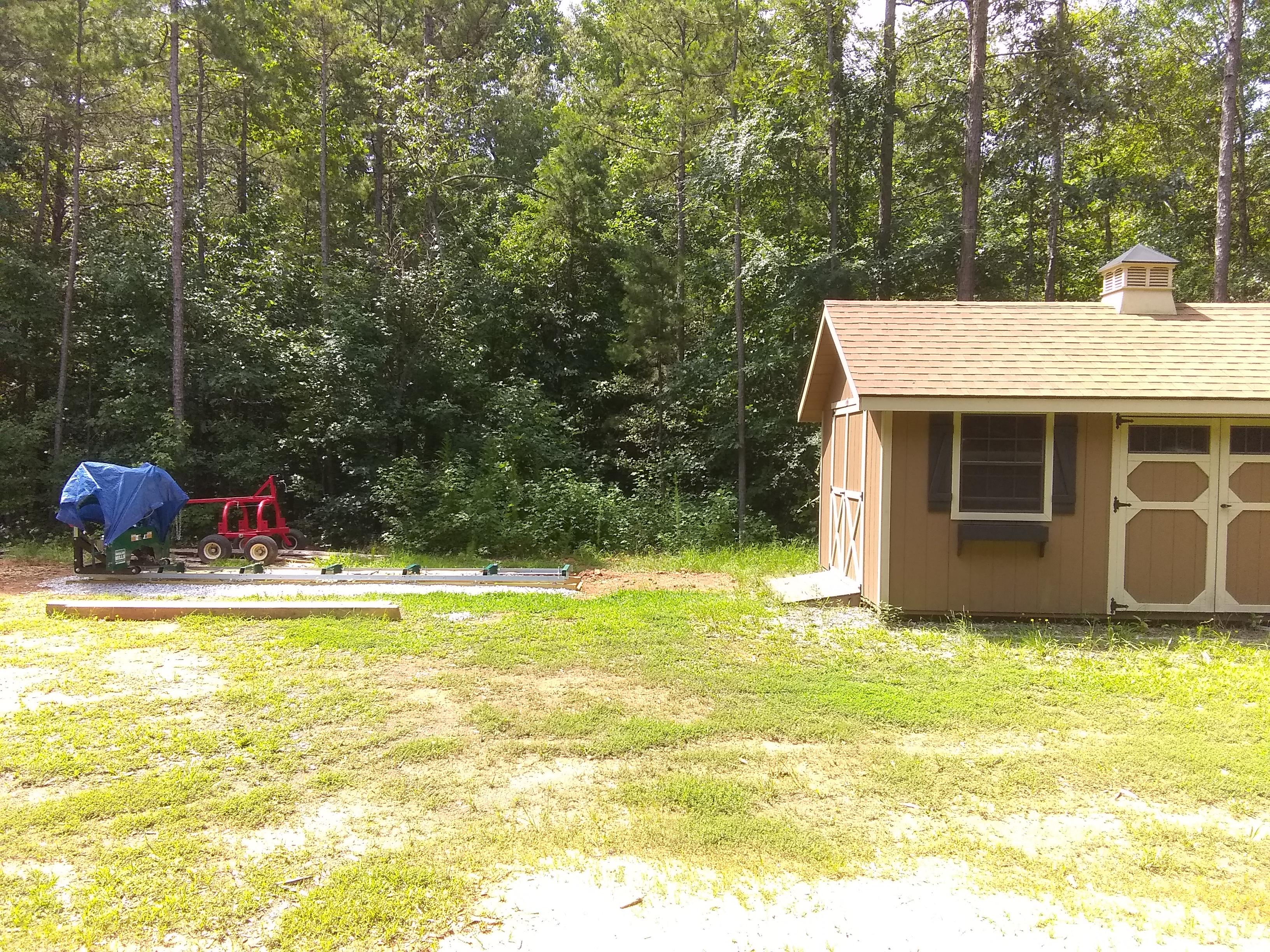

I set up my sawmill near my shed, with a couple of intents in mind: 1) The shed is going to be used for drying wood, and 2) to extend the shed roof to a pole / roof structure (similar to a porch roof) that would offer shelter to the last section of the sawmill track, so the sawmill head would be out of the weather without needing to put a cover on it.
A couple of weeks ago, I cut a couple of 5x5 posts from a pine log, intended to be the poles for the roof extension. I've been pondering how to set them to keep them from rotting. My instinct is to auger holes, fill with concrete, and anchor the posts on top of the concrete, just above the ground. The disappointing part of that thinking is that typical galvanized anchors for posts cost as much or more than PT posts. Seems counterproductive to have a sawmill and then spend more to protect the sawmill wood from rotting than the equivalent PT wood from the orange big box store costs.
Another possibility would be adding a piece of vertically set rebar to the concrete, and drill a hole in the post end, inserting the rebar into the post end hole, to act as a lateral brace. And maybe a simple, galvanized L bracket to resist uplift.
Pic of sawmill/shed end follows. I happen to have eight bundles of that exact roof shingle left over from our house build, so my plan is to blend the roof of the extension to the shed.
Input greatly appreciated.

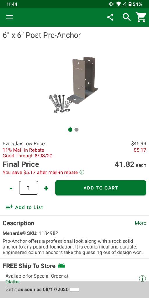

They're not cheap but very nice and I'm sure you've seen them before but I really like these brackets for anchoring to concrete. They've got wet set ones as well.
Another option I've done in the past is cut pieces of angle iron the wide of you post then anchor to the concrete followed by lagging or bolting through the post to the other angle that's you've anchored to the concrete.

Find some locust or white oak logs to cut the posts out of instead and set those on the concrete. Far more rot resistant than pine.
Yup!
Pine logs will rot within 15 years, no matter how you set them.

What I did was use pressure-treated 6 x 6 posts, set on concrete circular discs in the bottom of the holes.
I did a similar thing when I built my shed about 25 years ago (maybe, forget exactly when). No issues at all. Looks like the posts will last forever.
Put this 28x16 roof on the side of the shed last fall. Same motivation as yours. Plan on putting my small sawmill under roof, at least the power part. Did more excavation of the area beyond the roof after photo was taken.
I plumbed the posts and added a bag of concrete mix plus water to each hole to hold the post bases in position when back filling the holes.

Finally got around to finishing this project. I poured concrete piers for the posts, so the posts sit above ground level. I added a piece of 1/2" rebar to the piers during the pour, sticking up about 6" from the top of the pier. I center drilled the bottom of the posts with a 1/2" bit, and dropped it onto the rebar as an anchor. Had to hammer them down to make them fit down over the rebar, works well as an anchor.
All of the wood for the extension came from milling on the HM122. Great machine. Well made and enjoyable to use.
Added bonus: There's room for my Yanmar 2210 under the roof.
