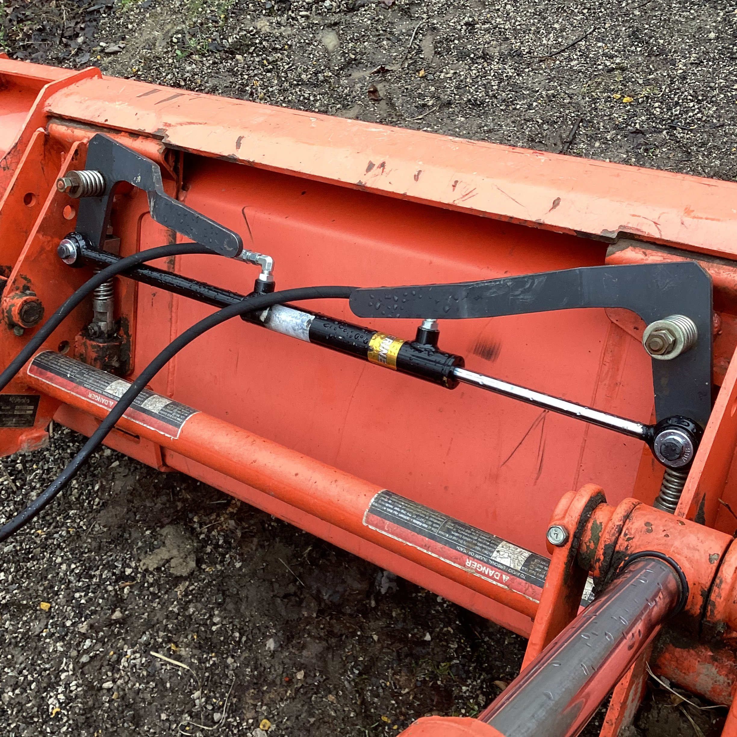

2 pieces of wire, a DPDT switch, a linear actuator & a few brackets is about as simple as you could make it.

I was thinking of a jackscrew where others are placing a linear actuator. I'd just run, say, 1/4" rod with a couple universal joints through eyebolts, a little like many bucket indicators. I imagine it'd be about like those awnings that extend or retract with a crank -- they might have 10 or 20 lbs of force, and move maybe 10X as far as the levers do, so a similar amount of work albeit with a different gear ratio.

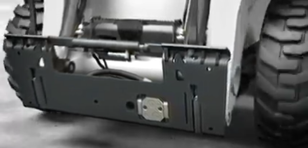

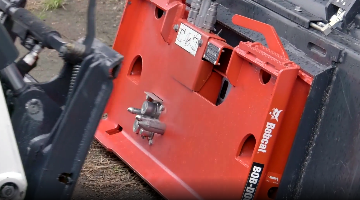

Lots of skid steers have hydraulic connect. They do it with 8” or 10” of cylinder travel.

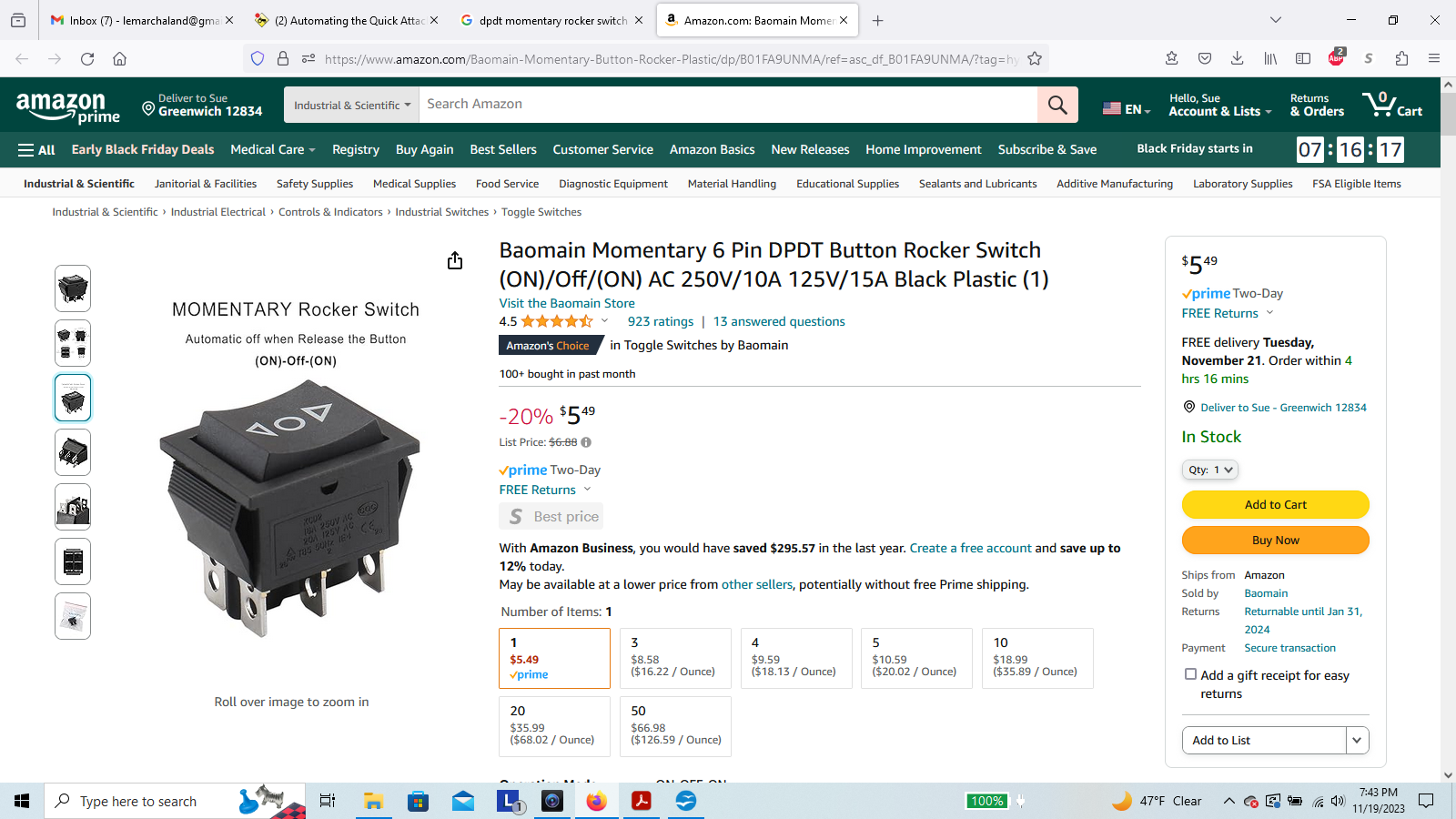

Interesting reading here. The only thing I haven't heard mentioned would be using a spring loaded "momentary" DPDT throw switch. That way you would have to physically hold the switch energized for either direction.
/ Automating the Quick Attach (SSQA) #47
My skid steer lock button uses a switch that’s similar to that and it has a cover over the top that you have to lift up to access the switch.

Linear actuators have limit switches internally. If you leave the switch in either position it will just extend or contract all the way, then turn off. Thats how I had my first power SSQA wired & it worked fine. I think I had a 10@ breaker for a 15@ actuator. That way it tripped if the actuator ever worked really hard.
