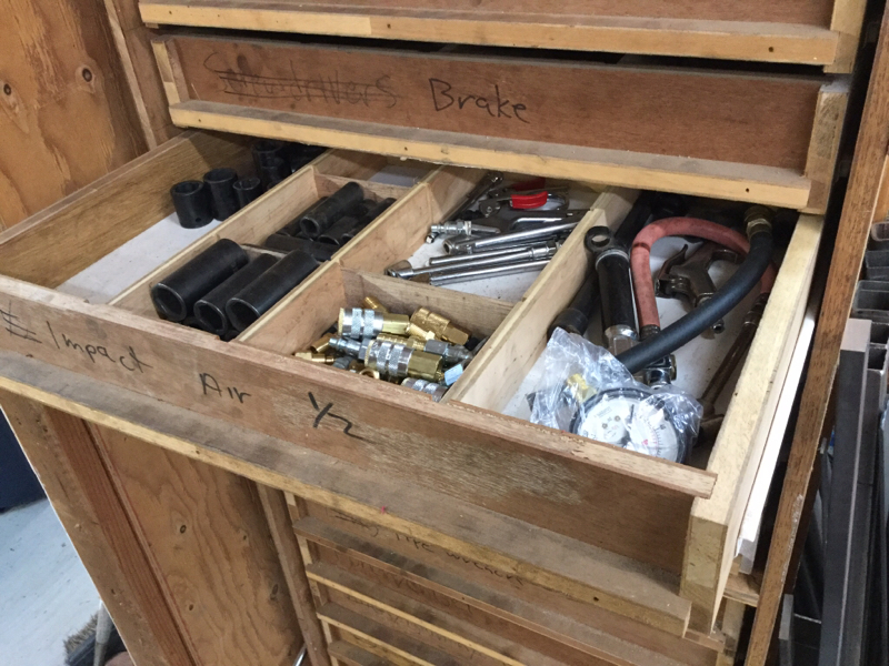

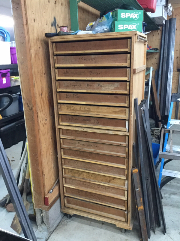

This is a good old thread time to wake it up. I made this rolling tool chest exactly 30 years ago. We didn't have much money so couldn't buy a steel one. I had some material left over from a cabinet job. The casing and drawers are glued and stapled. The drawers have adjustable dividers. On the bottom there are oak boards that the casters screw into. After 30 years it is just as solid as new. I have several steel roll-aways now but this is still in daily use. <img src="http://www.tractorbynet.com/forums/attachment.php?attachmentid=459789"/> <img src="http://www.tractorbynet.com/forums/attachment.php?attachmentid=459790"/>
I'D take your wooden roll cabs over new steel ones ANY day! :)
Terry
