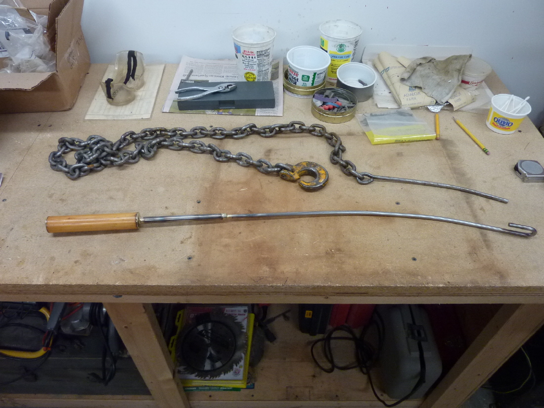

Choker Chain Grab Hook. Push it under the fallen log/tree, hook on to the choker chain, and then pull the choker chain under. A lot easier than pushing the pin end of the choker chain under and then trying to find it to grab it with your finger tips and pull it thru.
Made one of these during some recent down time. Yesterday was my first chance to use it. It works great, now if I just don't spend all the time it saves me trying to find it when I need it...;)

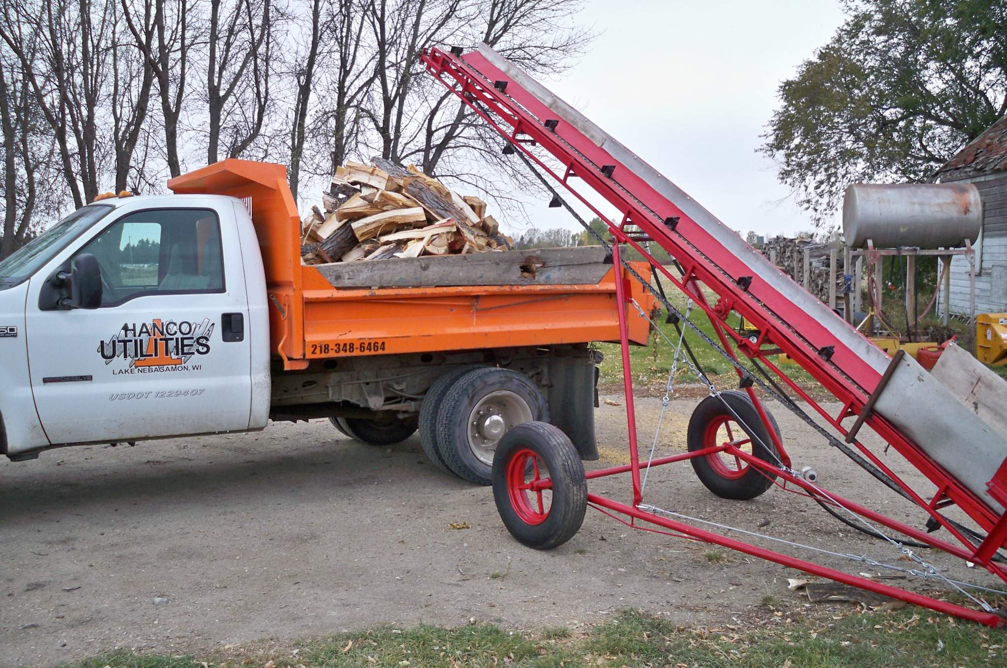

I built this firewood conveyor two years ago.

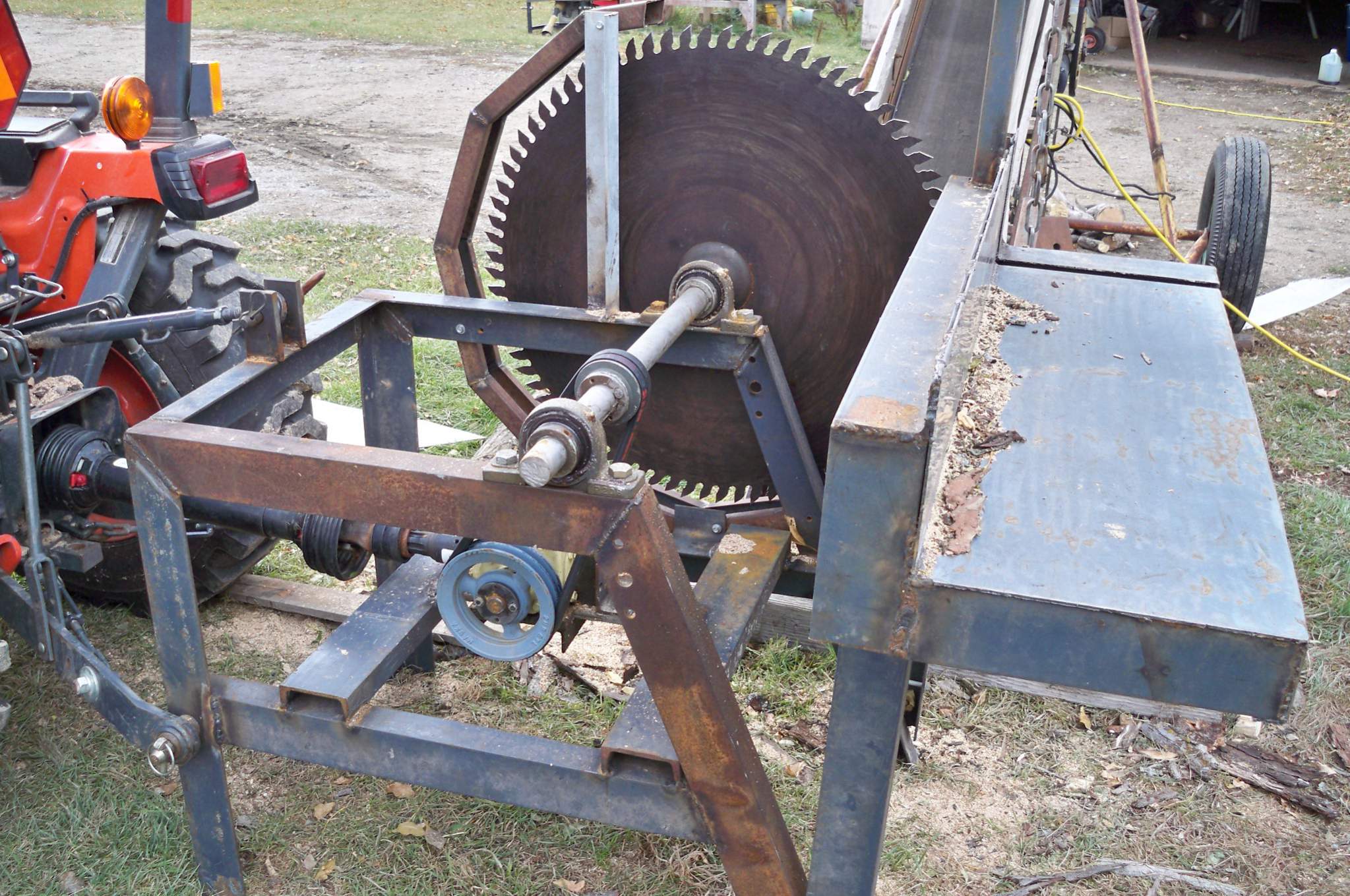

I built this buzz saw about three years ago. It was constructed from scrap metal. I purchased the gearbox, drive line, bearings, and blade. I then machined the saw arbor from a 1-1/2" steel shaft. The 31" blade spins at 1300 rpm and can produce about 3 cords per hour when staffed with three good workers. I can make a little over a cord per hour when working by myself.

working on a deal kinda like that myself...Pops had a working saw...I'm working towards powering it off the PTO

Nice job Joel. So the blade is spinning at about 1200 rpm or so?

My Kubota B2920 has the option of running either 540 or 960 rpm from the rear PTO. I run the buzz saw at 960 PTO rpm, then throttle down to about 2/3 of full engine rpm. The blade is geared up by way of the pulley mounted on the gearbox, to a 2:1 factor. The gearbox is 1:1. This provides more than enough power to the saw while saving quite a bit of fuel while cutting firewood.
