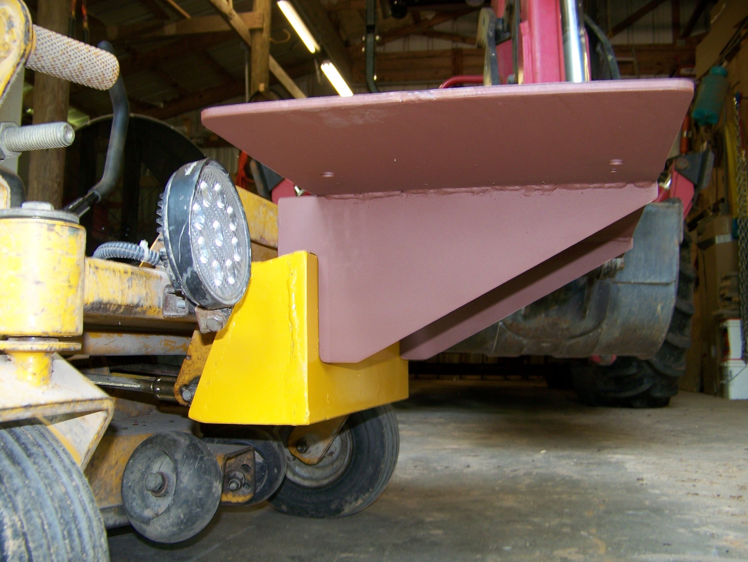

I welded up a permanent bumper that bolts on and the sprayer mount just hooks on. It's a 26 gallon sprayer that makes the rear end light on the Hustler. The sprayer has inserts on the bottom of the tank and stays mounted on it's mount.

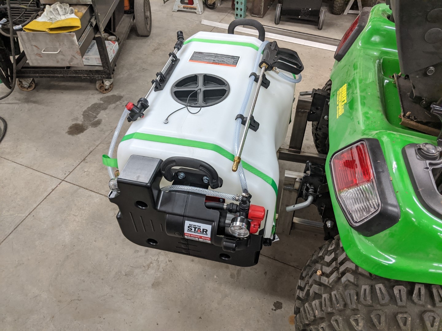

I made a similar mount off the back of my JD X738 out of leftover 304 Stainless. There is a 12V lighter style plug on the back corner of the fender you can just see in the third photo to the right of the taillight. I plug into that for power, and it conveniently has a switch on the dash to turn it on/off.

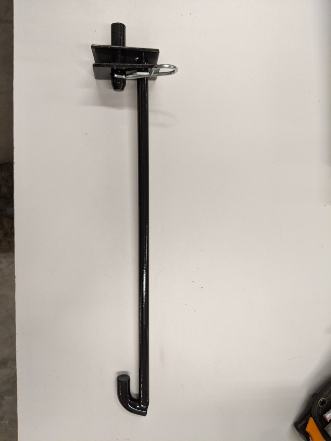

But I was also concerned about stability as I have lots of hills and side slopes so I added a front weight bar retainer. The bumper can already hold 4x 42 lb weights, but it needs something to keep them from potentially bouncing off if something unpleasant were to happen, so I welded up a bar and clip to restrain them in place.
