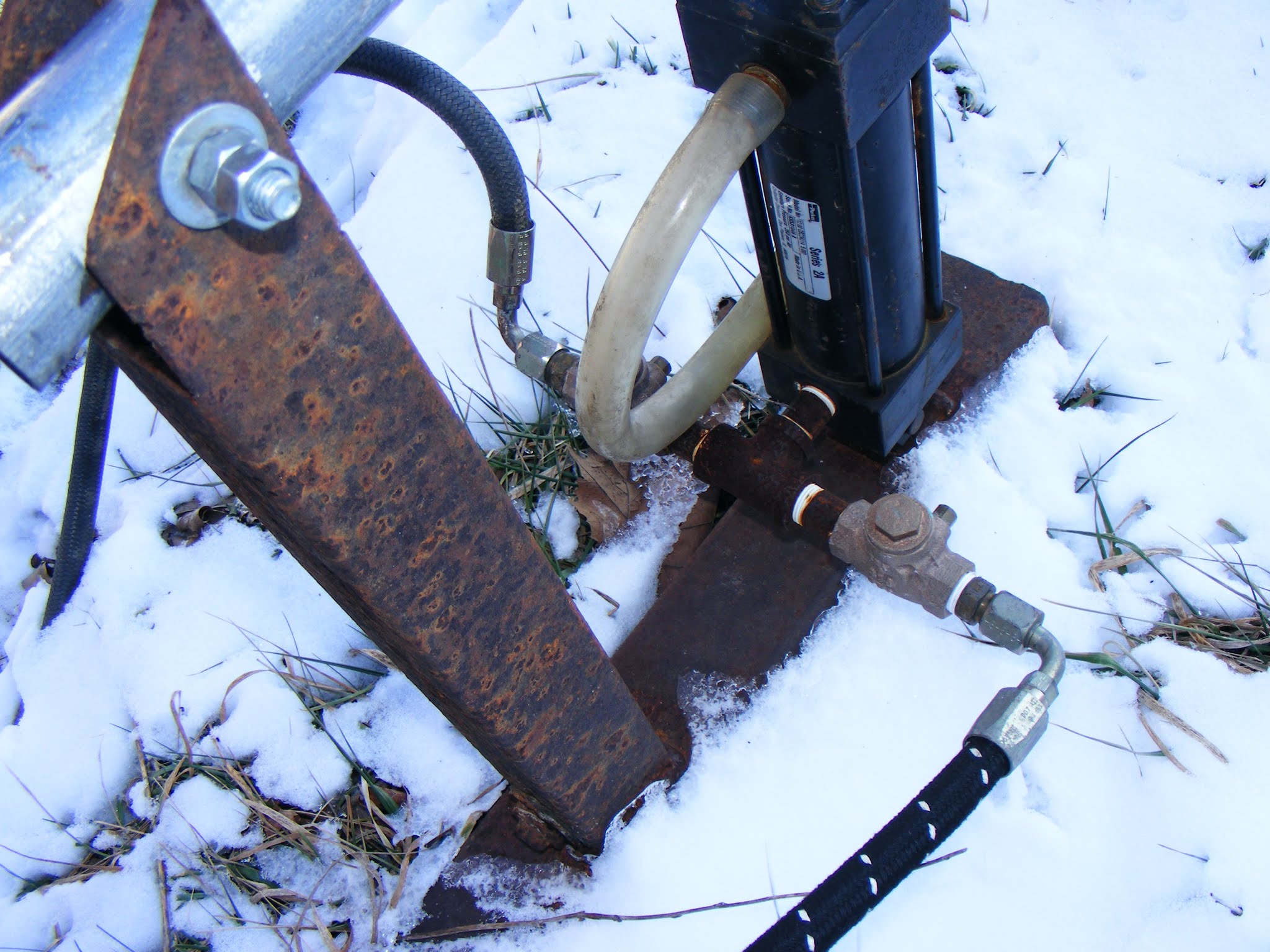

I have converted a lot of my engines over to propane and use the 20 pound cylinder to run them on.So I needed to fill my own cylinders. I made this propane pump from a air cylinder and two check valves .The handle is a post from a chain link fence. The hose that is pushed into the end of the handle is the end that screws into the 20 pound tank, it was in there to keep it out of the snow.DSCF0612.JPGDSCF0613.JPGDSCF0614.JPG

I have converted a lot of my engines over to propane and use the 20 pound cylinder to run them on.So I needed to fill my own cylinders. I made this propane pump from a air cylinder and two check valves .The handle is a post from a chain link fence. The hose that is pushed into the end of the handle is the end that screws into the 20 pound tank, it was in there to keep it out of the snow.View attachment 486603View attachment 486604View attachment 486605
I refill my 20 lb tanks also but I just hook it up from the big tank to the small tank and let it fill. When you back off the air screw on the small tank it lets pressure off and the liquid propane fills it from the larger tank. If the small tank is cooler than the large one it fills faster but it don't have to be cooler.
I use a bathroom scale and crack the bleeder to watch for liquid, the tank weighs 18 pounds empty,and it hold 20 pounds of propane, total of 38 pounds.If my small empty tank is cool from over night and I get out there early it will transfer up to about 30 pounds on the scales when the two tank pressures equal out about 2.85 gallon or less.If it is high noon it will only move up to 25 pounds about 1.6 gallon. When it quits moving on its own i pump.The newer tanks with the over fill protection valve on them stops the pump handle solid when its full. The stores with the racks only have 15 pounds of propane in them, the label on them says so, about 3.5 gallon. 1 gallon of propane weighs 4.2 pounds. A "full" 20 lb cylinder should have 4.7 gallons of propane in it. I get about 1 acre to the gallon mowing. But yes you are correct temperature is everything when filling them. Back when gasoline was $4 and propane was $1.25 it was a big deal, now it is Gas at $2 and propane at 77 cents it kinda hard to fool with, all of mine are dual fuel and I can run both ways but all of my carbs are wore out and my stuff runs so much better on propane I stay with it.

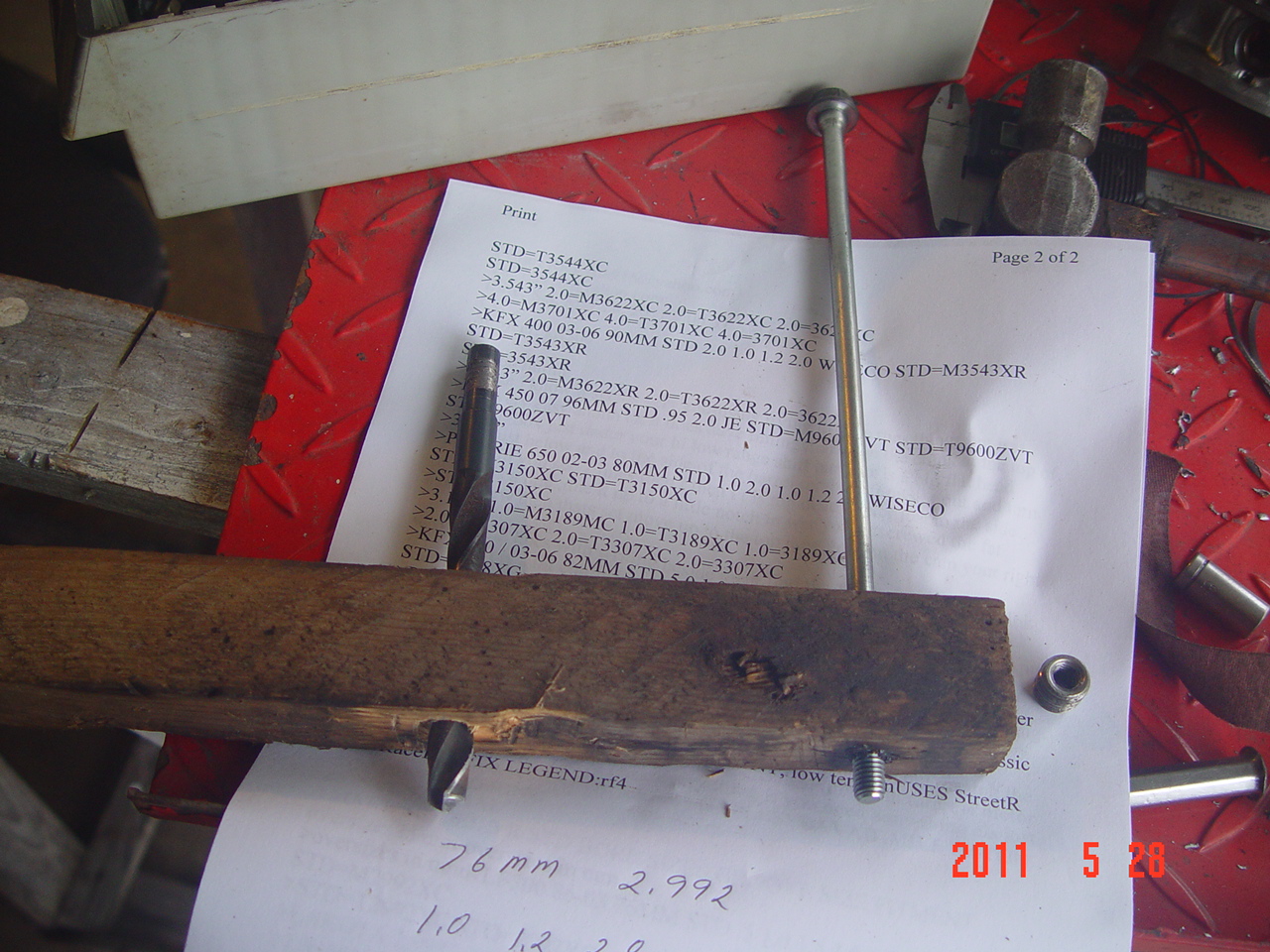

I know I only get half a point for this one but to keep it alive I will share it. I had a broken 8mm head/cylinder bolt broken off in the block on a KLF 300 KAW. The person that started the job was going to drill it out but kept falling off the broken bolt until they had little holes drilled most of the way around it in the aluminum block. In his defense that bolt was hard as a drill bit. I felt I had nothing to loose and finished drilling holes around the broken off flush bolt. Hit it hard with a center punch and it came out but left a big hole. This is where the homemade tool was used to get my 3/8 pipe plug reducing bushing hole drilled straight up and spaced proper. DSC06860.jpg I took a 3/8 pipe plug with the allen wrench head on it and drill it to tap with a 8mm tap.DSC06859.jpg DSC06857.jpg DSC06864.jpg . I taped the block with a 3/8 pipe tap.I leveled it up with a 4 inch lapping wheel .

I know I only get half a point for this one but to keep it alive I will share it. I had a broken 8mm head/cylinder bolt broken off in the block on a KLF 300 KAW. The person that started the job was going to drill it out but kept falling off the broken bolt until they had little holes drilled most of the way around it in the aluminum block. In his defense that bolt was hard as a drill bit. I felt I had nothing to loose and finished drilling holes around the broken off flush bolt. Hit it hard with a center punch and it came out but left a big hole. This is where the homemade tool was used to get my 3/8 pipe plug reducing bushing hole drilled straight up and spaced proper. View attachment 486703 I took a 3/8 pipe plug with the allen wrench head on it and drill it to tap with a 8mm tap.View attachment 486704 View attachment 486705 View attachment 486706 . I taped the block with a 3/8 pipe tap.I leveled it up with a 4 inch lapping wheel .
Hi Rocky,
Even though I'll prolly forget it when I need it, that was a neat temporary tool and handy application of it.
