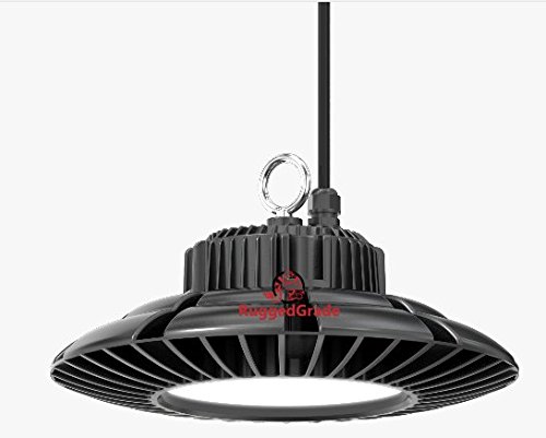

Those round high bay LED lights are pretty interesting but I'm wondering if the company will be there to stand behind the UFO product? I was interested so I looked into it a bit and it Looks like LED Light Expert has only been in business since 2014 and has a CEO Dara Greaney that is an eCommerce guru that joined in 2016 from BuyAutoParts.com. Pretty successful guy. I come back to my question on whether products with warranties sold in eCommerce will be supported and further more can you buy more of the same if need be.

I installed 2 of the 150 Watt UFO units. They seem to be top quality and put out a lot of light. I did a video review and included some light measurements in the shop. I plan on installing two more when I have extra money laying around.
