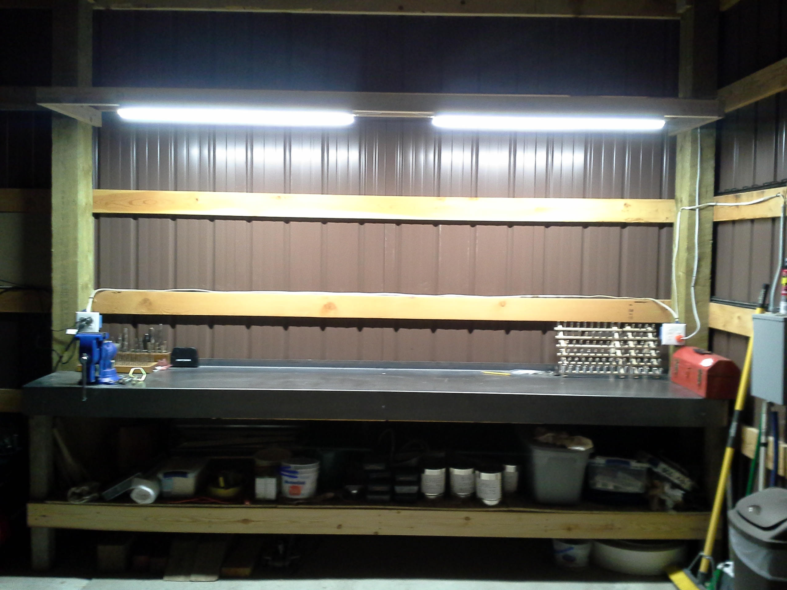

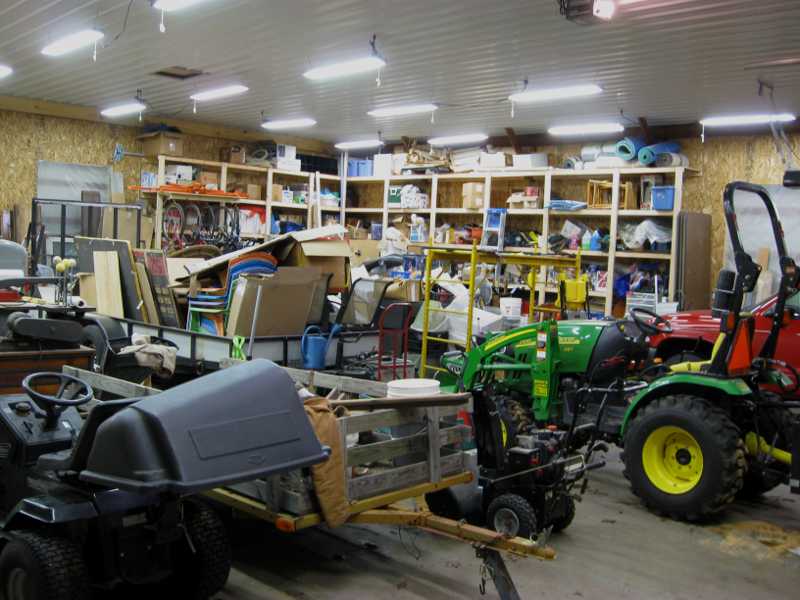

We have 26 4' fluorescents in our 30x40 shop and it works well - now I am slowing converting it over to LED's and they work even better. One thing to remember set it up on several switches so you can adjust it to your needs. Somedays I need just my perimeter lights on to do some little dumb thing, and the next I am pulling a tractor tranny and light the place up so I can see everything. Generally you can have too many lights!

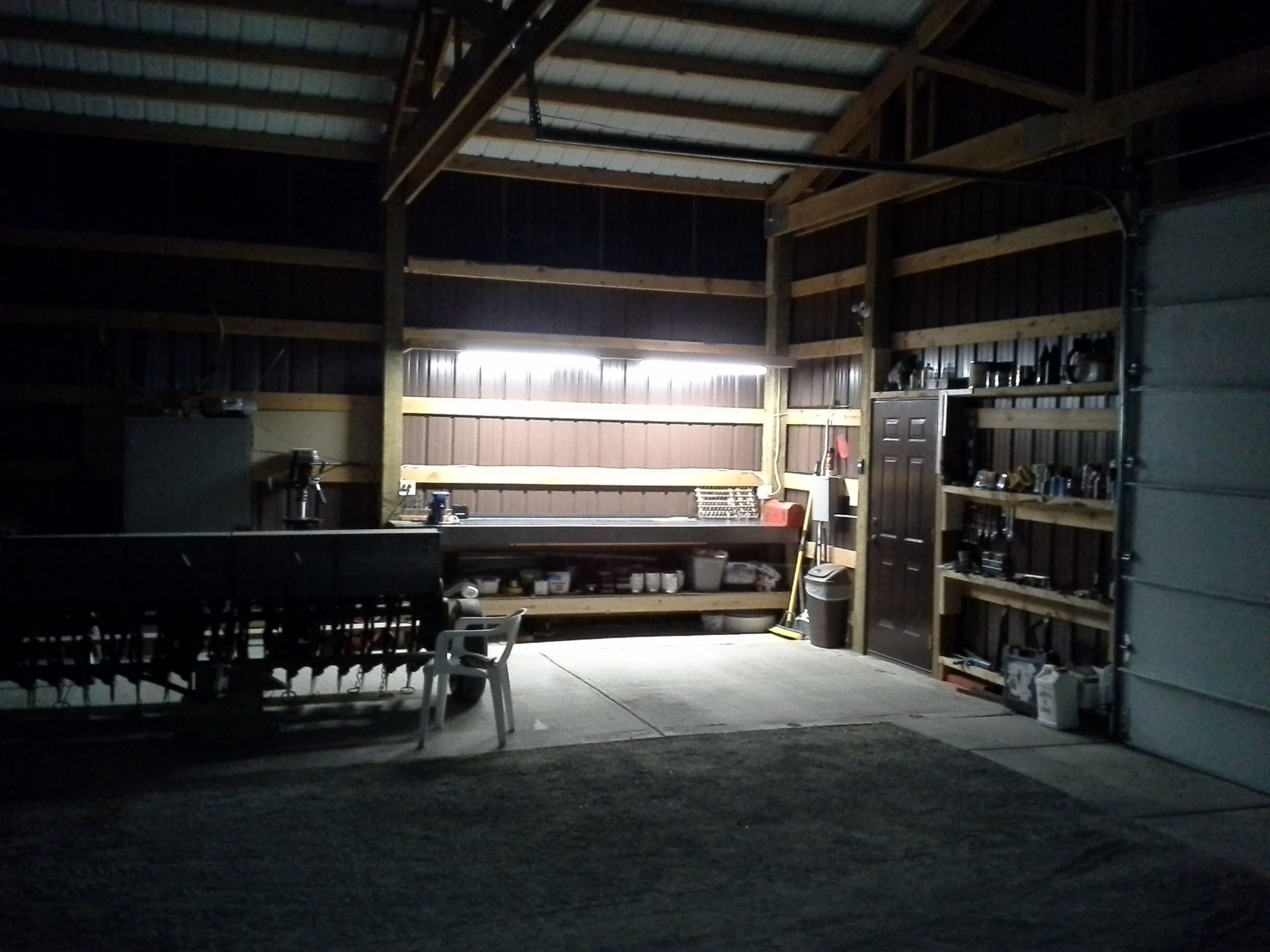

I really like the Costco LED lights also. But something else to consider is to paint the wall a glossy white so the light is reflected more. Someday I going to clean out the garage and repaint the walls gloss white instead of the flat that my wife insisted on. Easier to clean bug smears off of!

Yeah me too, but the 'clean out the garage' part is daunting. I have unfinished drywall that begs to be finished. I love my six Costco LEDs installed so much I bought two more just before xmas. Really should have bought 4 and now they are not there. I never learn my lesson with Costco.

Friday I went to our local electrical supply and bought a retrofit kit for the one 8ft floresent light I had out.Replaced the 2 8ft bulbs with 4 4ft LEDs.It's a lot brighter.When the ballast go out in the other lights I will replace them with this kit.The bulbs and kit cost less than $57 dollars.
