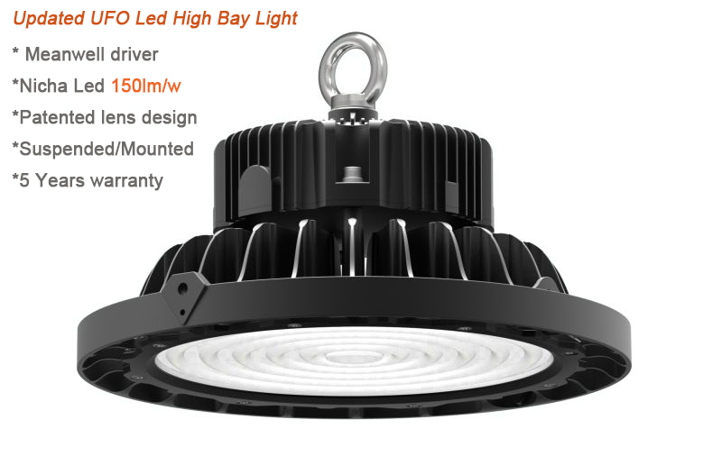

I went with these over tube type. 18 watt consumption. Nice and bright for 3k foot shop
Running 8 of them

Used the scissor lift and took a pic of a label
My electrician did say for these to work well they gotta be high

Do you have a link to the ones you are using? Thanks
Sorry to jump in. This matches the part number he was showing in his picture.
Amazon.com: LE 55W LED High Bay Lighting, Super Bright Commercial Lighting, 15W HPS or MH Bulbs Equivalent, 48lm, Waterproof, Daylight White, LED High Bay Lights: Home Improvement
3000sf with white walls and lid. 8 lights at ~5000 lumens for a total of 40,000 lumens. As a reference a 4' T8 fluorescent bulb is ~3000 lumen.
Do you find you need task lighting as well with the 8 lights you have? I have a very similar situation and have been watching this post for some time now.
1 Watt LED High Bay UFO Lights -13, Lumen- Ultra Efficient 13 Lumens to Watts - Smaller and more efficient - Warehouse LED Lights - LED High Bay Lighting - High Bay LED Lights - - Amazon.com
I found these and was worried 8 wouldn't be enough. Maybe it will be based on your experience.

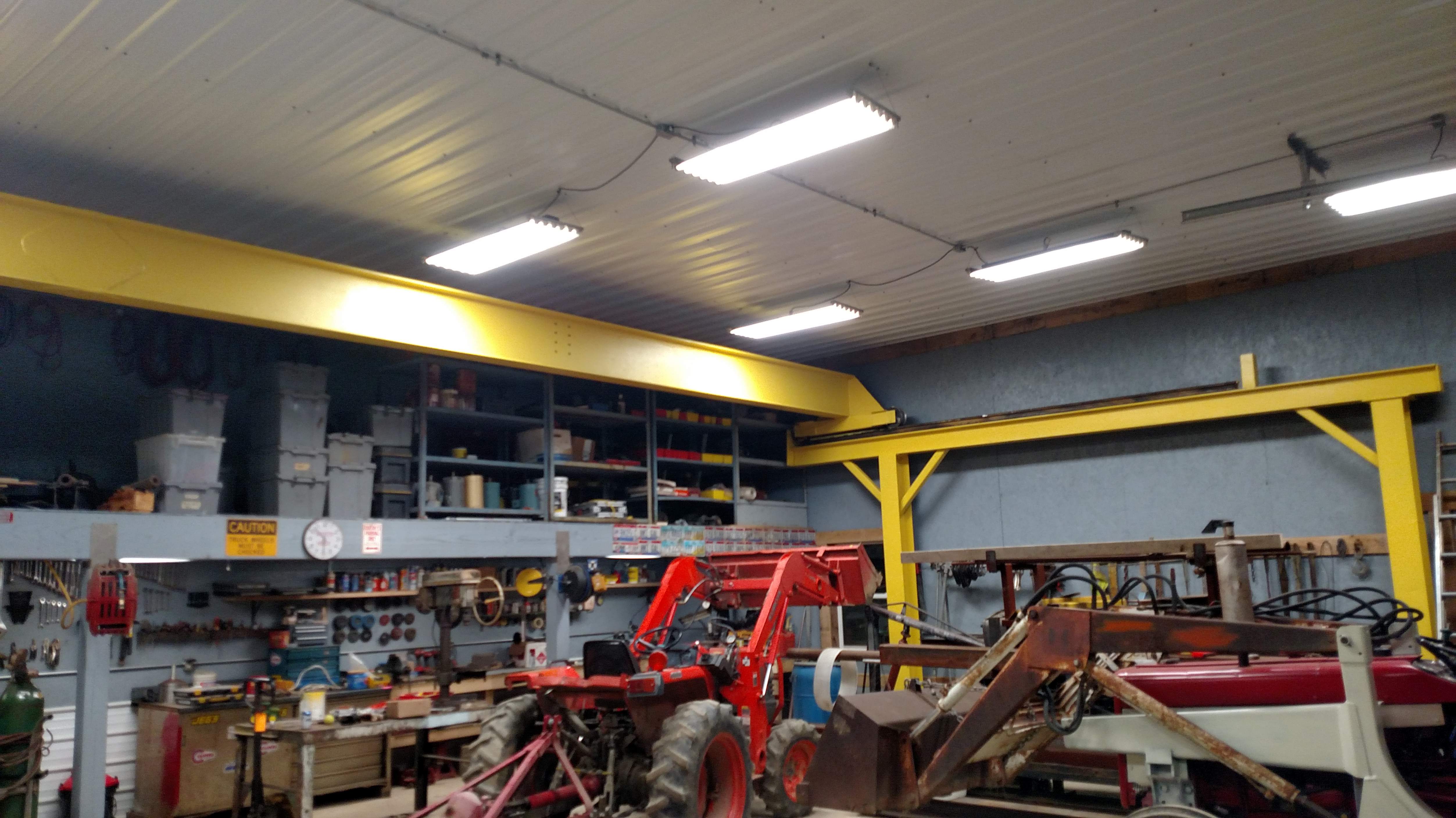

A little late, But I'd vote LED as well.
I just did my shop a few years ago, also 40x40x14' I have 8 HO fixtures, each with 6 T-8 4' bulbs. And they have the mirror like reflector behind them.
Then under my storage I have 4 4-bulb fixtures and above it I have 2 4- bulb fixtures.
So in total, with all lights on, I am burning 80 4' T-8 bulbs. All 5000k. (would have preferred 6000k bulbs)
Lights are the biggest power user when I am at the shop. 80 bulbs at 34w each.....2700w of juice. Down there for a 8hr day....thats about 22kwh for the day which is more than I would like for lighting. But all the fixtures and lights + about 300 spare bulbs was all free courtesy of work. We were replacing fixtures with ones that use a battery backup ballast to dimly light 2 of the bulbs when the power goes out. So they were tossing these, which is 100% of what our facility uses on the production floor. Got all the spare bulbs because we change them every 3 years weather or not they are burned out. So I saved some of the good ones.
Can get the same level of lighting with fewer watts with LED. And as cheap as they are becoming....they will pay for themselves in no time.
Just a few random old pics showing the level of lighting in my shop

No task lighting, that is a nighttime pic
Maybe under a car yes but happy thus far
