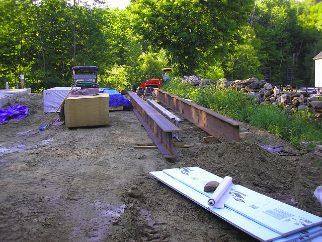

More progress over the past few days. The big action has been the installation of the beams. There are two steel beams in the shop to provide a clear work space. In the garage section there are three laminated beams.
The first picture shows the steel beams preped and ready to go up. Those are 2x12's bolted to both sides. The floor joists will then be attached with joist hangers.
Next shows the lifting straps being attached.
