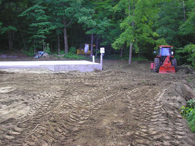

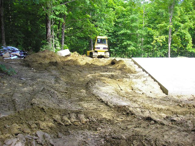

Great build! I like the pic of the concrete truck with the long front mounted chute- It looks like its close to 20 feet long and able to get way into the middle of the foor. Was there any concern about the weight of the truck right next to the footers causing any damage?
Im in planning stage on a shop building and would love to avoid having to pay for a pumper truck to come out for doing the footers and then again for the floor. The soil here is real sandy and I wonder if it will tolerate the 60 or 80K pound cement truck right next to the footers and forms. Nice work on your building, Dave

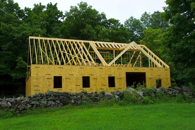

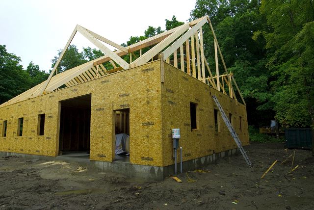

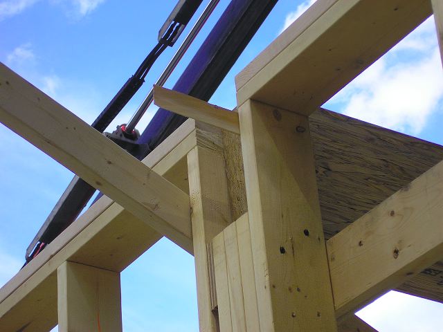

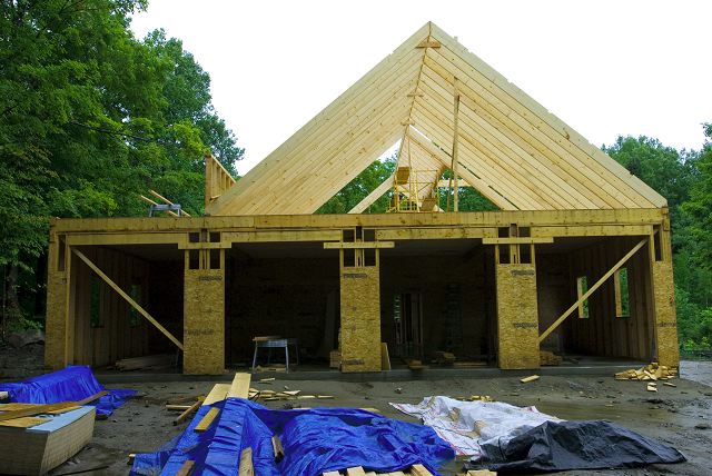

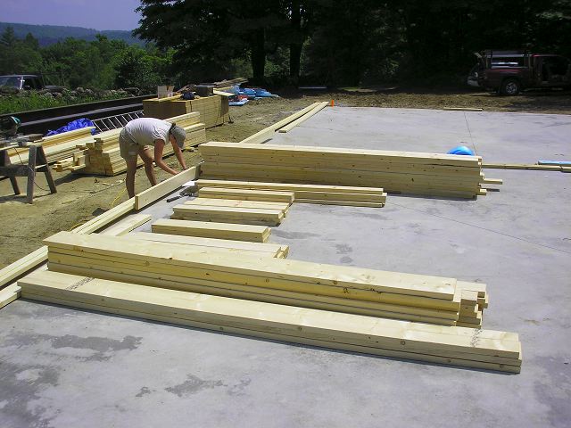

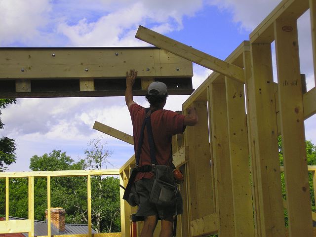

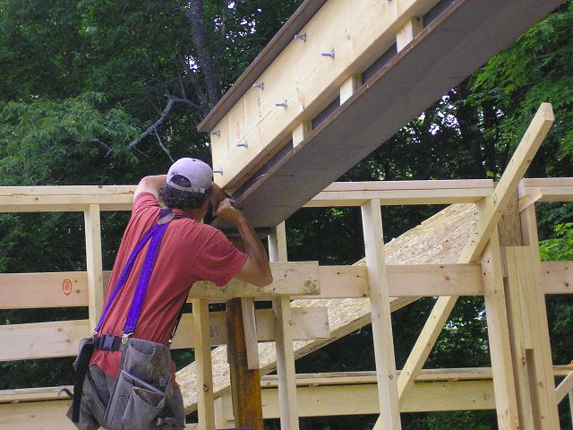

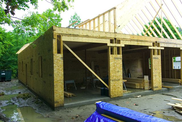

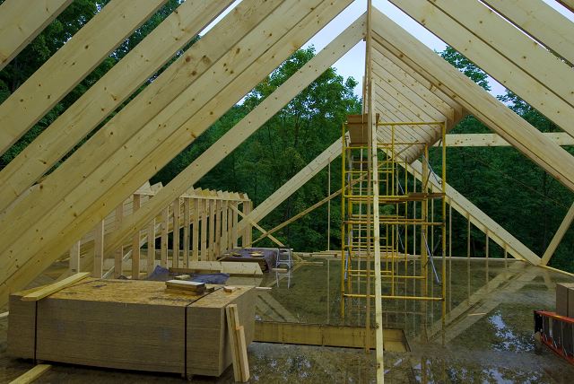

Well, there has been lots of progress over the past several weeks. These are from about 3 weeks ago and show the roof framing going up. It's pretty complex with the peak, shed, and large dormer.

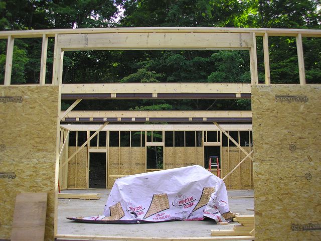

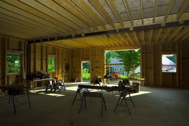

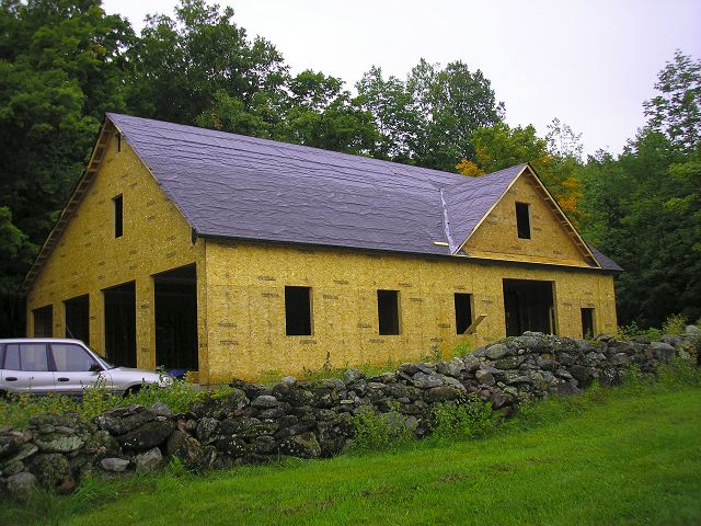

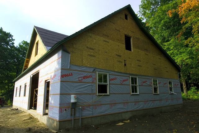

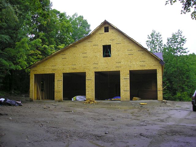

And here we are today. The roof is all ready for the standing seam which should go up late this week or next. The windows are also just about all in, and the siding will start to go up this week.
I've been a wiring mad-mad for the past week, and just finished up all the rough-in today including alarm and smoke detectors, network, etc. The crew has some more strapping and some foam board to put up and we'll be ready for insulation next week.

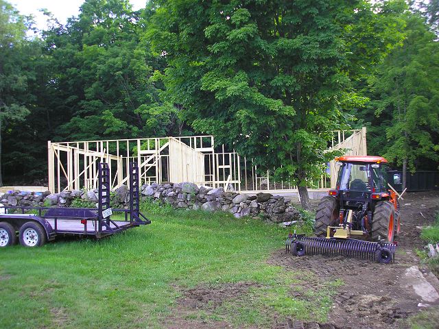

That looks great! Are you keeping the stone fence? It really looks nice in front of the building.
Yes, absolutely! Damaging one of those old walls is a capital offense in my book. These walls (they are on three sides of the area where the building sits) presented one of the biggest challenges in the original siting of the building. I'm very please with how it came out. It's deceptive in the pictures, but the wall you see is between 20' and about 40' away from the building. There will be a drive between the building and wall to access the single large door to the shop. All in all the building tucks into the space really well and helps temper the overall mass of the structure. You'd think I knew what I was doing, but it's more the result of luck.

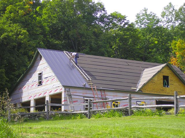

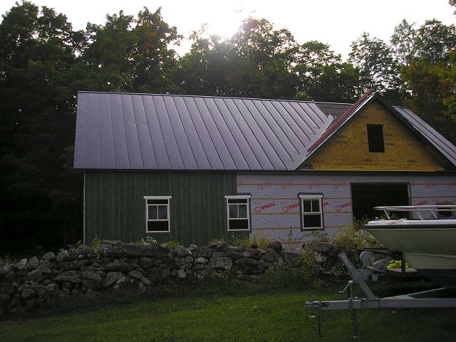

Progress has continued on the shop while I've been working on the solar panels. The roofer started yesterday and made good progress through today. He's probably got 2-3 more days to complete it.
In the last picture you can see the siding going up starting on the left corner. We got the barn-board pre-stained on all sides which will help preserve the wood. A second coat will be applied later in the fall.

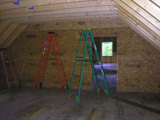

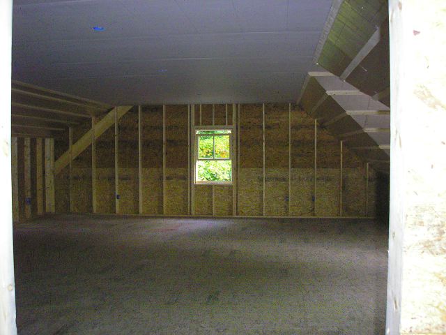

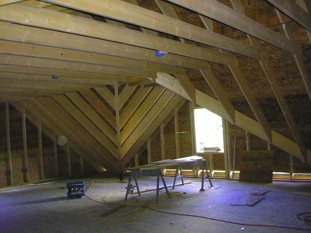

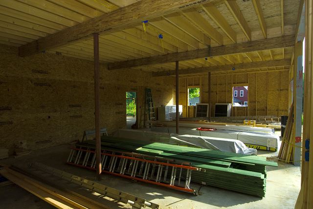

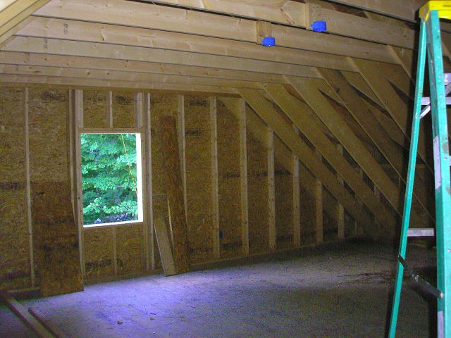

The insulators are due to start Tuesday. In preparation for them the ceilings needed to be closed in to hold the blown in cellulose. On the second floor, the flat part of the ceiling got wallboard since the 16+ inches of cellulose will be more than enough insulation. The sloped parts can only hold 11" (rafter depth), so they get 1" foam board. Here's the room from a number of different angles.
