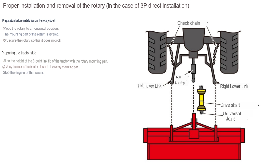

Would that need a longer driveshaft?
For tilling only a couple of times a year, it's not that much trouble to take off the QH to install the tiller in place of it. But making the tiller QH-compatible does sound attractive!
/ SCORE - Quick Hitch H-F #43
I was able to use the one it came with that was never fitted to my tractor.

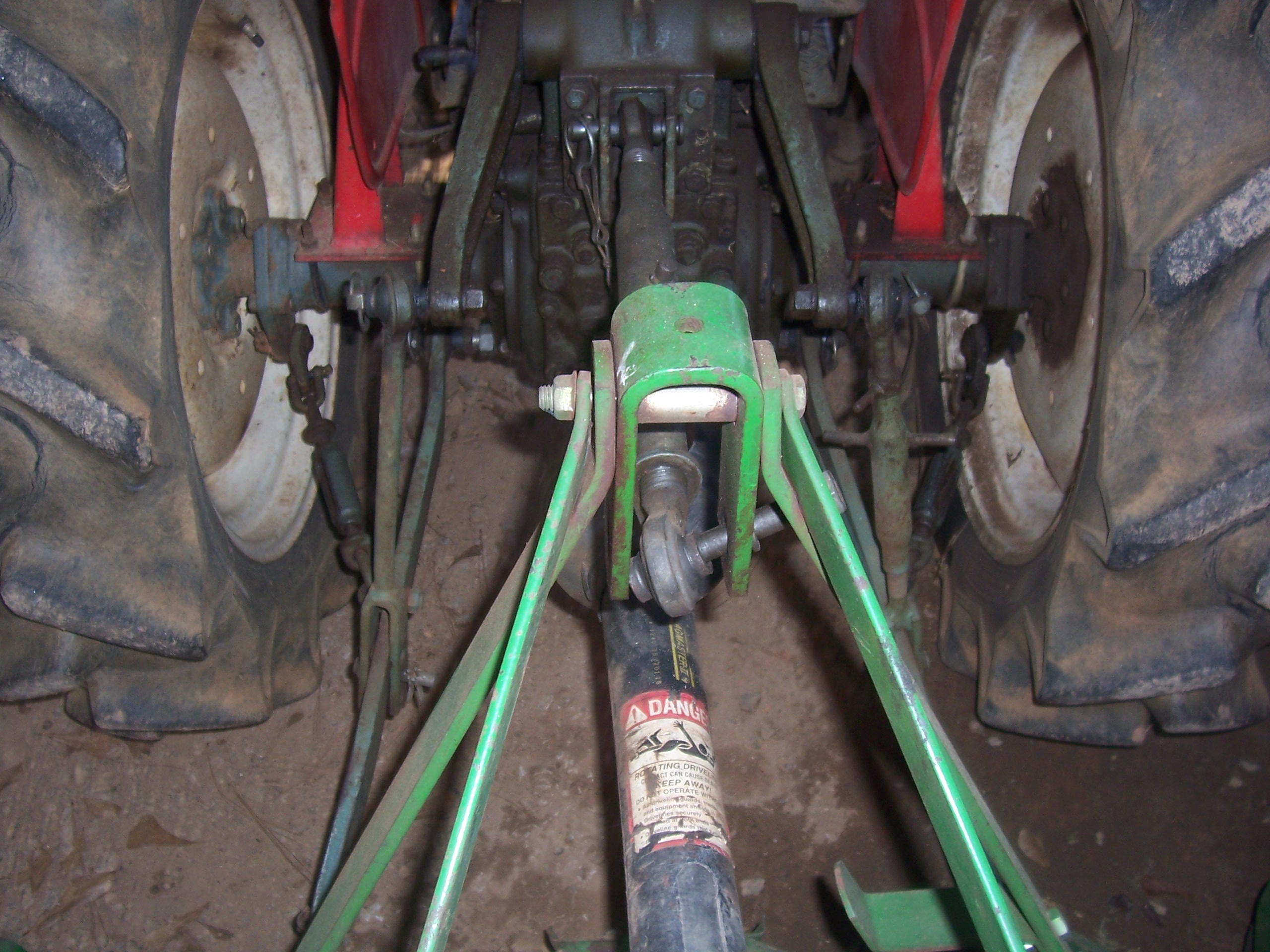

My old style Overrun had a pin you had to line up and punch out. PITA! If I had to ever remove it anytime now I'd replace it. The RS1400 came from Fredricks and it was the last one they had. Hard to come bye back then. I was told By my local dealer I better go get it. I had Drive shaft problems on it also. Had to shorten the Org. they Gave me. Didn't take a day or so for them to send me another and told me to keep the old one. Another Member may still have the old one. I put a major Ghetto rig on it. They may still be using it. Think he cleaned it up since It did have a bearing problem also? Welding was Ugly no doubt but Hey!! it worked. ;)

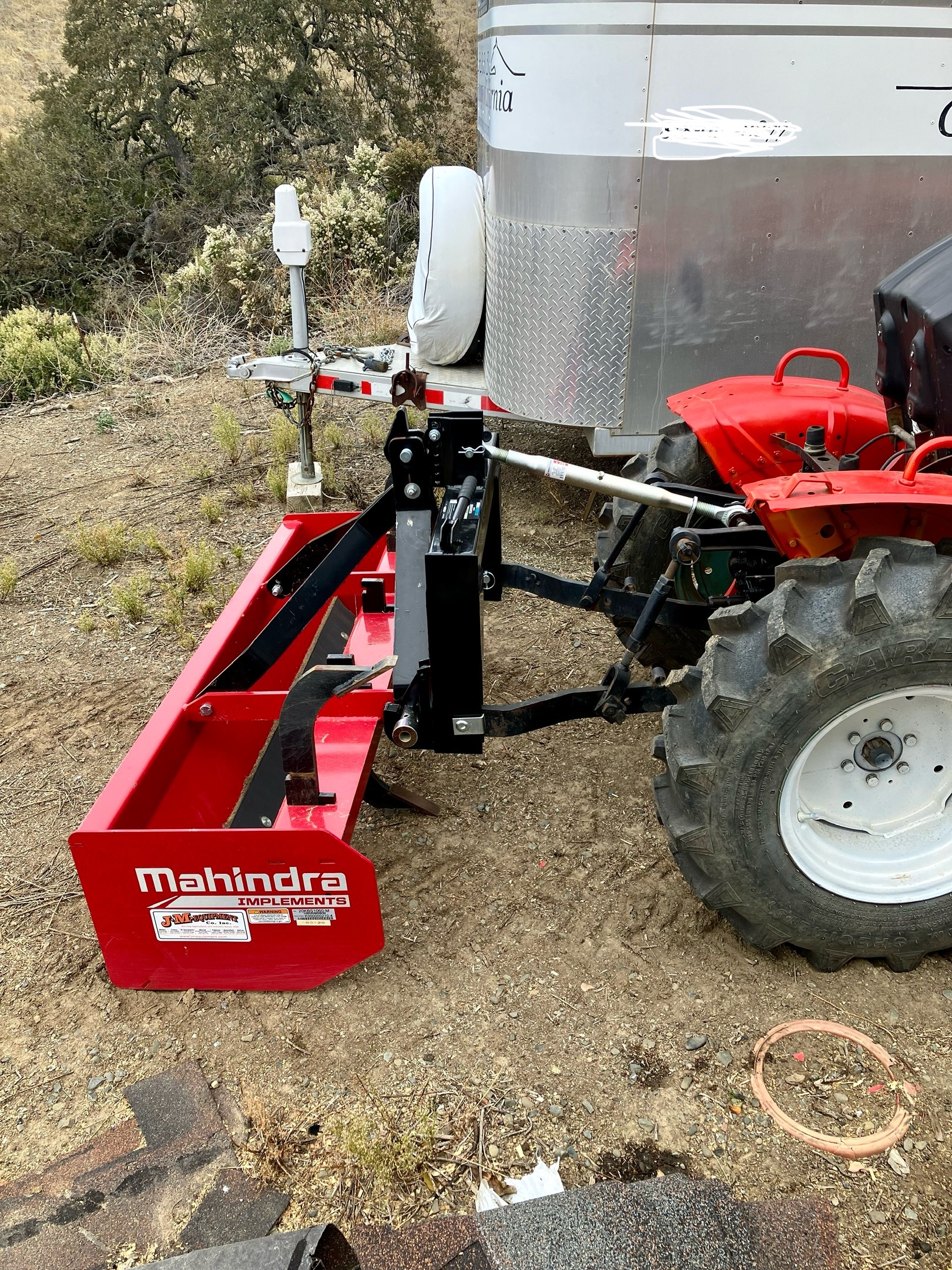

I spent part of Sunday getting the QH and box blade adjusted. All my dragging attachments have bushings installed, so I had to buy another QH.
Wife hadn’t used her account recently, so HF sent her a 30% off coupon. $113 out the door.
Kinda like the extra weight on the back with such a heavy loader bucket. Pulled the 5 ft box blade around pretty good on a hard pan field. Very rarely use the box blade on the Mahindra.
#46
Did you need to use a farm jack or reverse pipe clamp to widen the opening by 1/4 to 3/8 inch? Mine was a tad under size like others had mentioned. It was a quick fix of 5mins and all was good.
My BB can't use the QH due to the top-link hook interface on the BB. I rarely use it now as the straight blade can do all sorts of things.

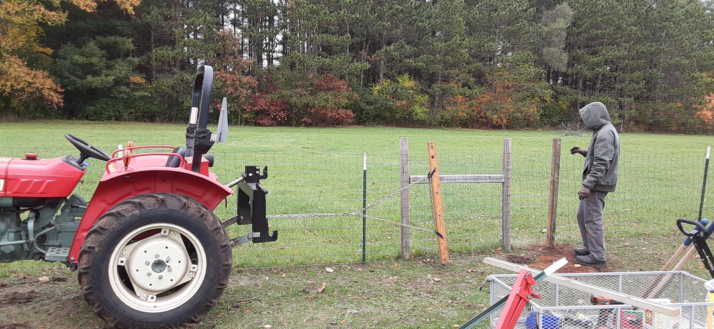

When the weather isn't so cold out, the next project for the quick-hitch will be this. All I need is a 30-gallon plastic barrel. Those are $8 on CL out here. (y)
The 30-gallon fits like a glove for the quick hitch. This should be about 240-lbs of rear ballast.
