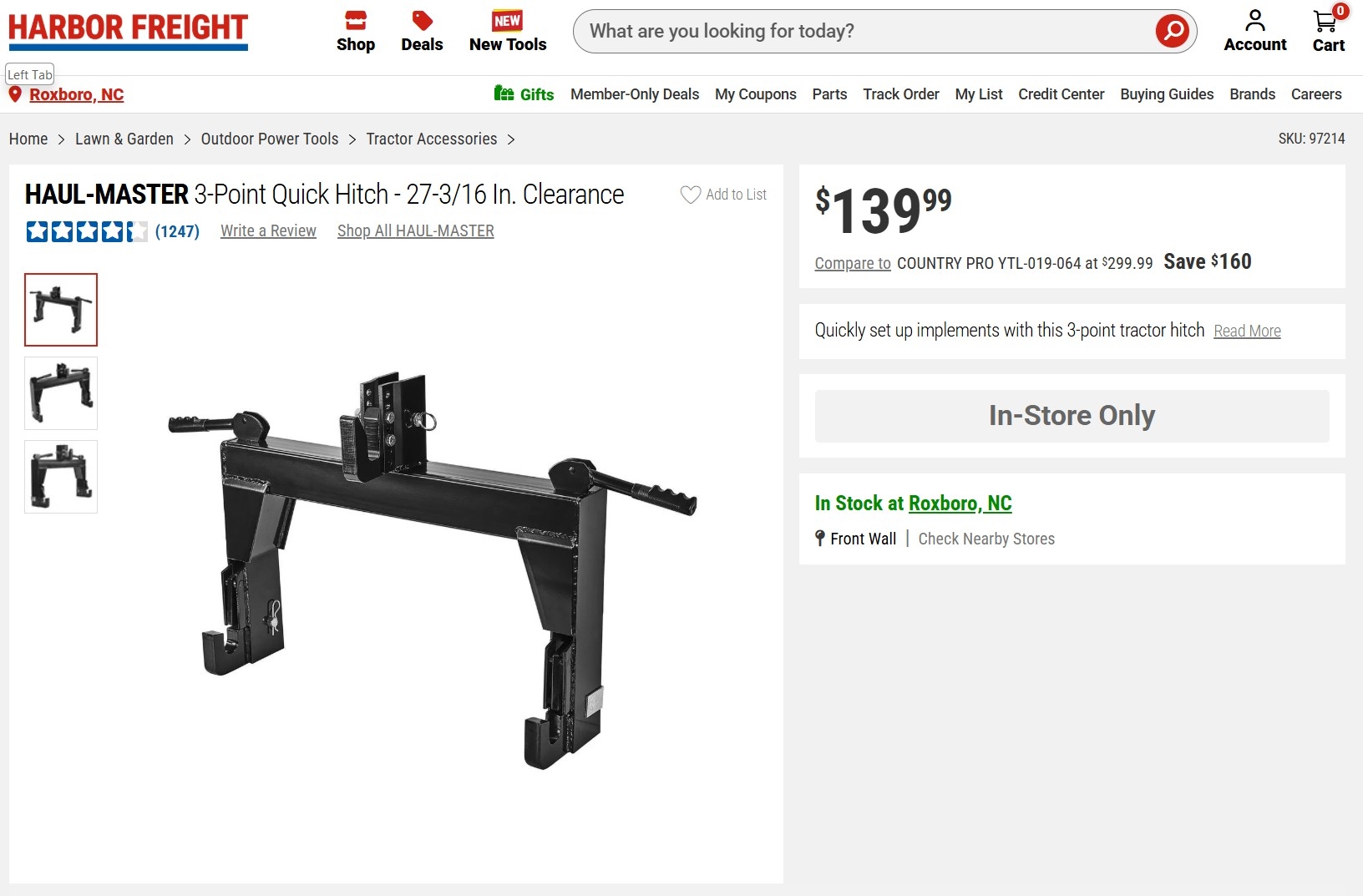

Of course the Harbor Freight one exists, but as already mentioned not that great a bargain at this price.

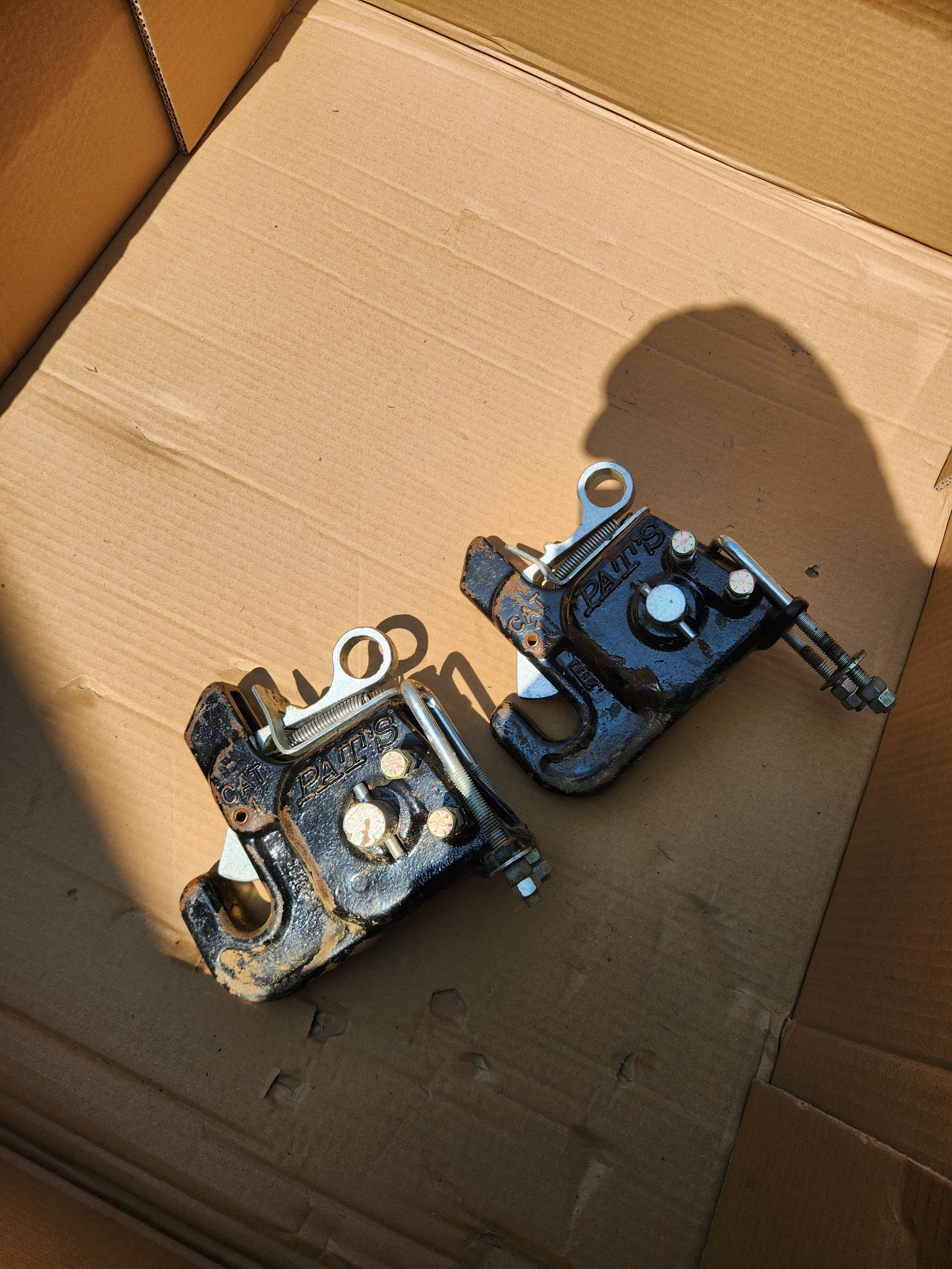

I bought the HF for $99 but discovered it didn't fit some of my older (favorite) attachments. Sold on CL fast and got the Cat 2 Pat's QH. Been very happy with it. The MX drag links adjust easily to any size. Usually I just line one up side and move the other. Takes less than a minute, no tools.
Both lock plate springs broke after a few years of hard use. They broke right at the end so I just bent down another loop and reattached em while I waited for replacement springs to arrive... which I never put on so I have spares.
Pats has worked good for me. I bought a used set here for my old internet challenged friend. He's happy too. I think Euro ends are better but require modification of the tractor arms. If I ever toss the Pat's I would go with the Euro ends just to keep the option to connect to varying width attachments. And the PTO accessibility

My neighbor has the Pat's single 3-point QH add-ons for his Ford 1500 with CAT-1. He's not all that impressed with it. These have a loose fit on his machine and wiggle too much. He has to hop off the tractor push them a little upwards and back up slowly hoping they will not droop and miss the connection. There is also a little play side-to-side. The Pat system fits most of the American made brands just fine, those brands made in Asia, like the Japan tractors, those are not ASAE standards, those are JIS standards that are close . . . So you need to know this before ordering Pat's system.

Pats fits my Kubota and my friends JD just fine. Enjoy the adjustable width for various new and older attachments I use in Cat 1 and 2. PTO shaft connection much easier to access without a QH. To each their own. Just saying Pat's works for some people. Even with Japanese tractors.

During my research, I also learned about PAT'S QUICK HITCH and also a bx stabilizer kit. Any advice about these devices would also be appreciated.

I haven't used those Pat's type lower couplers, and don't think I ever would, as the standard full frame type QH's work plenty well for me. Do note that most QH's rely on a cat.2 pin size with cat.1 spacing on your implements. This means you'll be buying cat.1 implements, but bushing them up to cat.2 pins. Not a big deal, the bushings cost something like $35 per implement, and it's a once-and-done installation.
