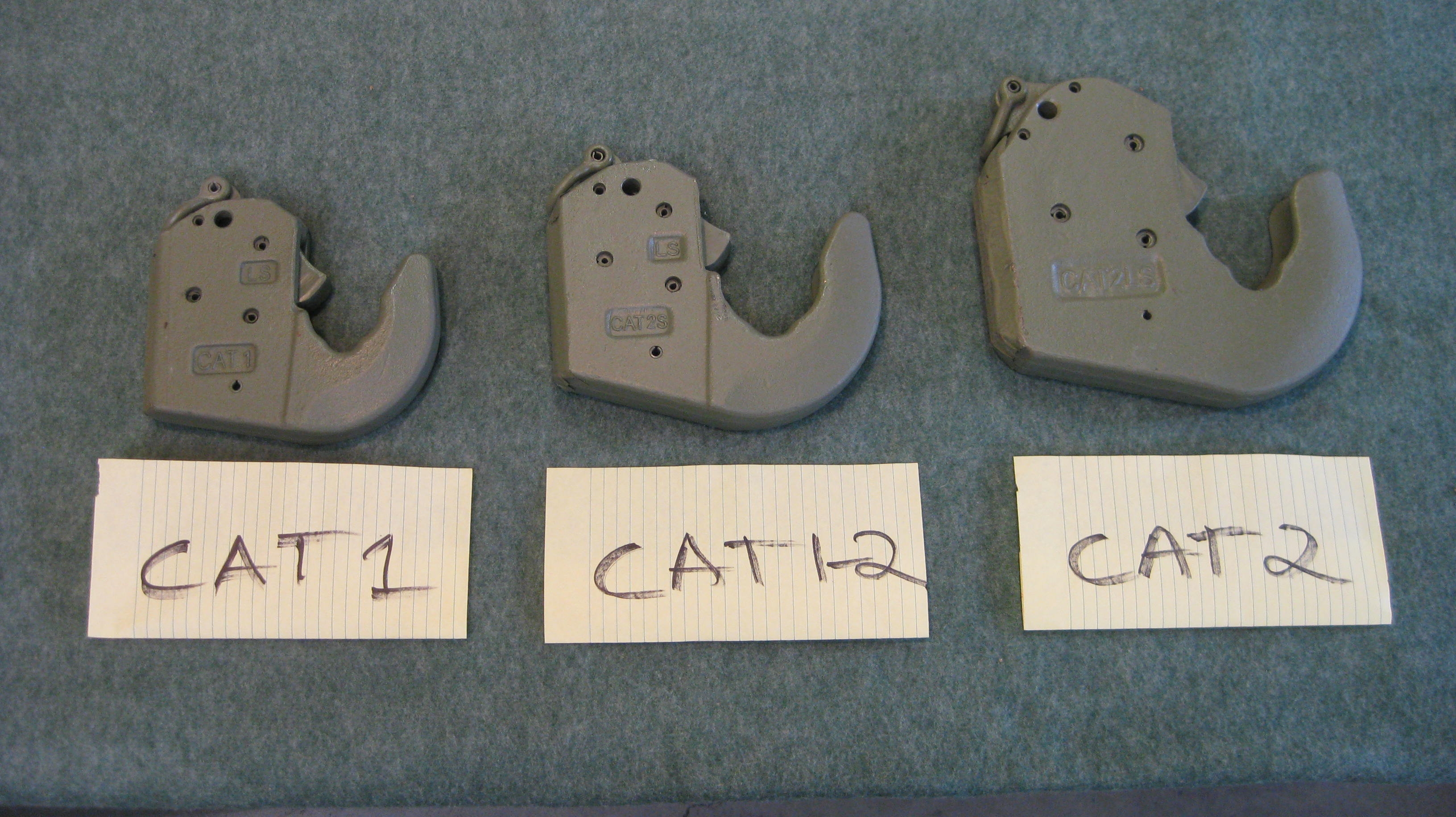

I think I may go with the hydrualic top link and the see how much of a headache hooking up is and then go from there. I really want the top link first.
Really digging the idea of the Euro hooks, though.
The issue with going with the top link first is that you don't know how much additional length you need. If you go with Pat's, the connection point is extended 3 3/4". The Euro hooks extend 2". So your typical top link for your std 3pt is going to be different for any of the 3 scenarios. Plus do you want a Euro hook on the top link also?
All things to consider. :unsure:
