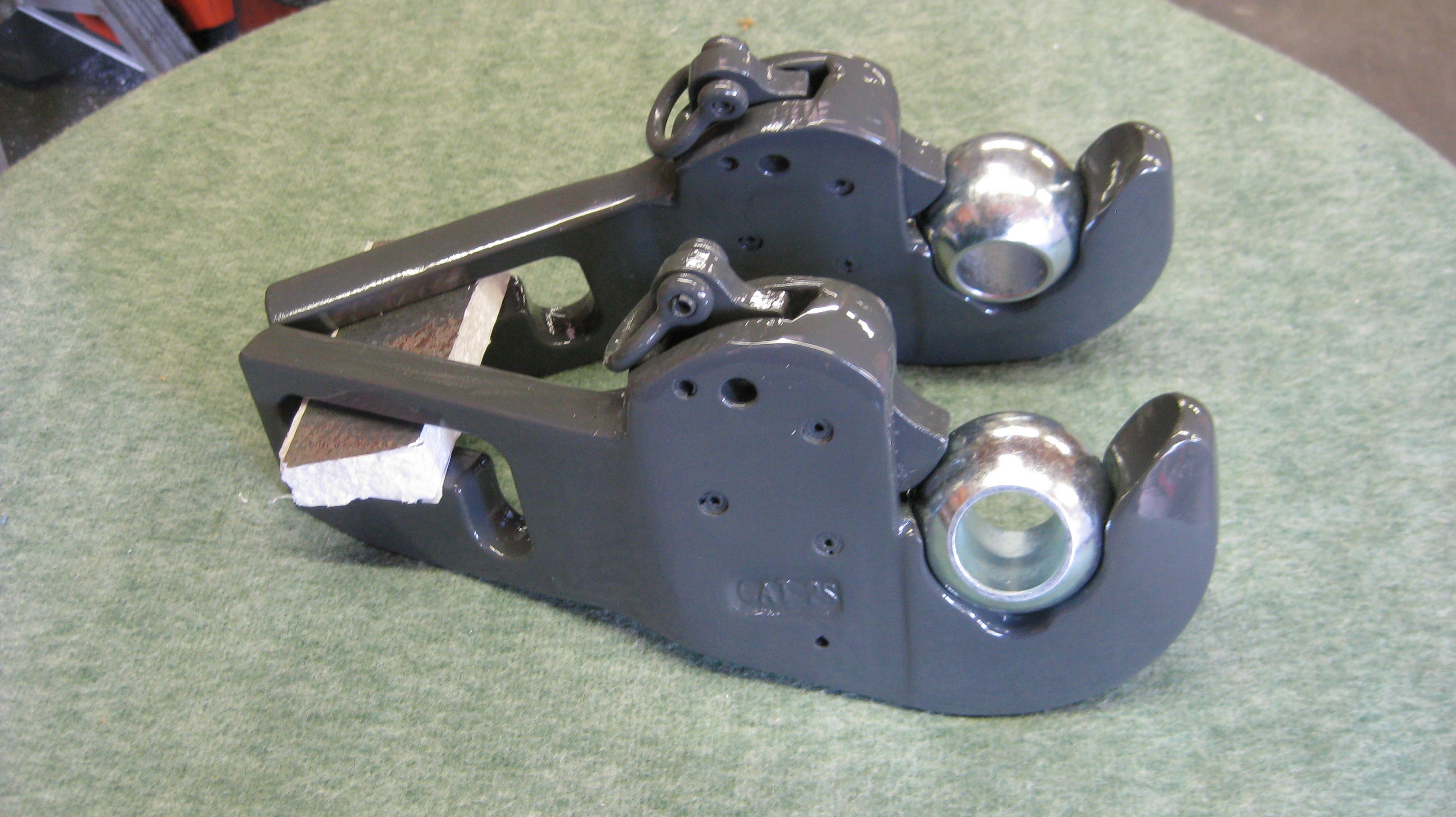

3 common sizes. cat 1, cat 1-2, cat 2. Even cat 3 & 4 available.
My recommendation is cat 1 for under 3000lb lift capacity. Cat 1-2 for 3000lb-5000lb capacity and cat 2 for over 5000lb 3pt lift capacity.
Do the fabriction yourself and save some money, or ship the draft link pieces and pay to have the fabrication done.
Just an alternative to be considered.

Not too many complaints about the Euro hooks. Nothing like the Pat's anyway.
I’ve been considering Euro hooks.
Seems like it’d be the best of both worlds.
I can weld, so that’s an option.

You won't regret it, that's for sure. Well worth the money and time invested to install those.

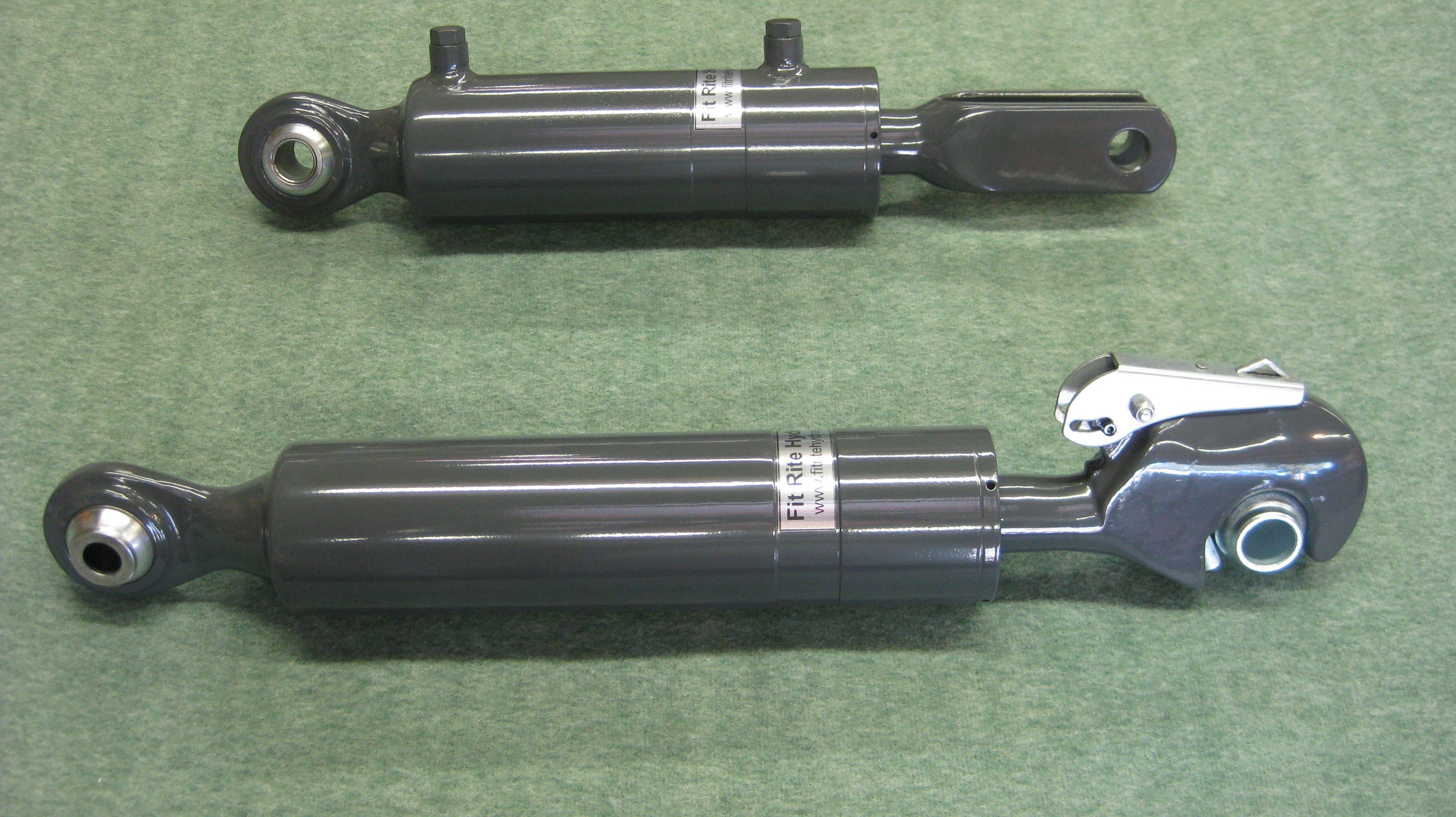

I think I may go with the hydrualic top link and the see how much of a headache hooking up is and then go from there. I really want the top link first.
Really digging the idea of the Euro hooks, though.
What I like about the combination of hydraulic top and tilt and telescoping lift arms is that the implement can be sitting on uneven ground and the hook up is easy with all of the possible hitch position movements.

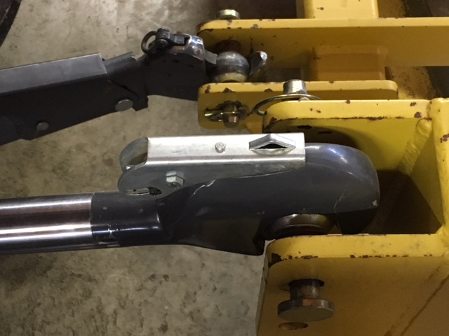

The issue with going with the top link first is that you don't know how much additional length you need. If you go with Pat's, the connection point is extended 3 3/4". The Euro hooks extend 2". So your typical top link for your std 3pt is going to be different for any of the 3 scenarios. Plus do you want a Euro hook on the top link also?
All things to consider. :unsure:
