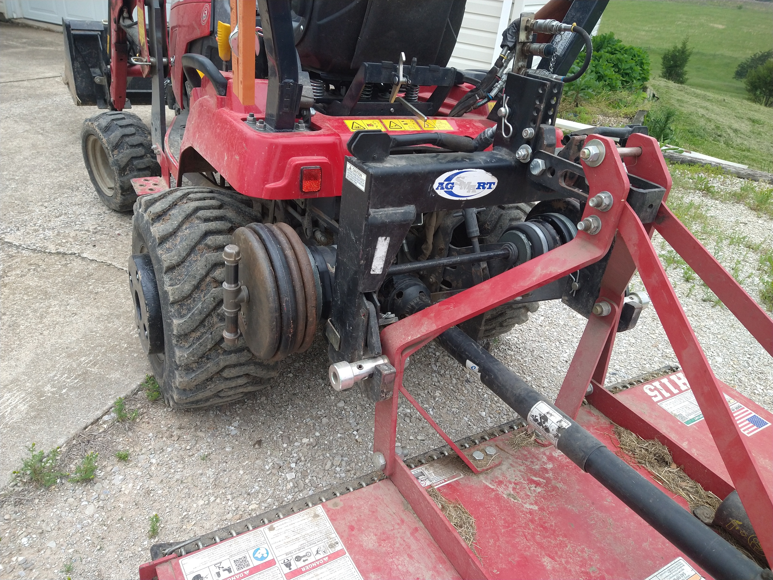

I have the AGSMART made by SMA https://www.smalink.com/p/873-hf141101/19660 made in USA quick hitch on my SCUT for over 3 years, it's been excellent, came with one set of lower bushings, it uses bolts for the upper pin adjustment (once set, I've never moved it!), just got a SPAREXor my CUT that I haven't used yet, also came with lower bushings, has pins for the upper hook made in UK, both bought from my local Massey Ferguson dealer ... I try really hard not to buy from china!
If you buy the bushing kit(s) from @kennyd he includes the 1-2 & 2-3 bushings for the top pin ... Or you can cut a section on schedule 40 black iron pipe ... I've done both on different attachments.

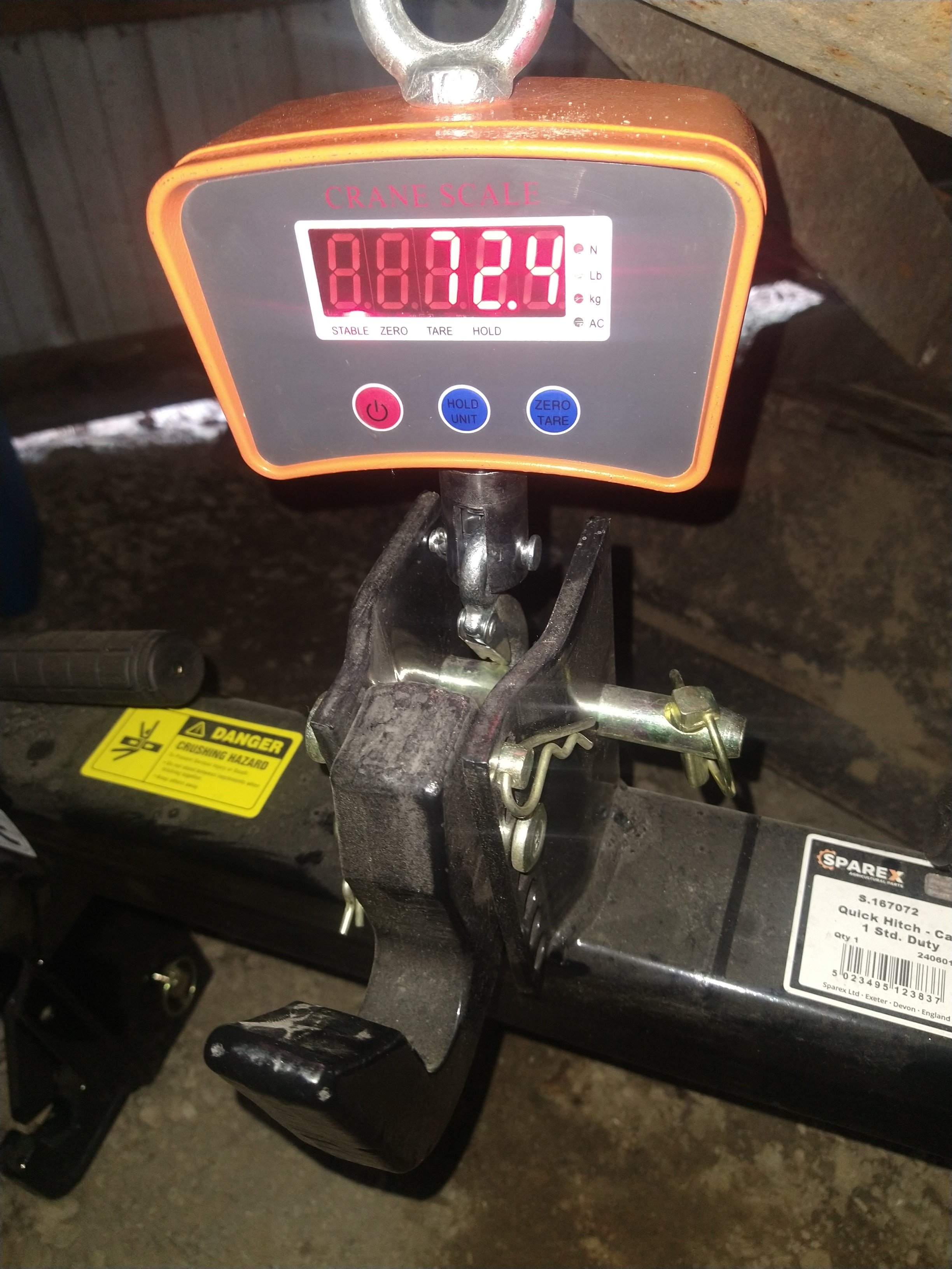

The SPAREX I just picked up was $253.14 I don't have to pay sales tax ... Don't remember the other one ... Actually had to look at my CC statement! 😂
I don't know why, and didn't ask, so I don't know why my dealer had a different manufacturer ... Possibly was back in spring of 2022 with supply chain issues, he just got what he could for me ...
/ A new month, a new Quick-Hitch thread. #14
Both of mine also came with that extra connector that the one on the end next to the imatch had ... I've never used it.
The SpeeCo E he mentions still has the big top hook, so the regular CAT 1 top pin is still gonna be loose in it ...
Mine are close to those weights ... My other one is slightly less than my new one ... My thinking is heavier is better ...
