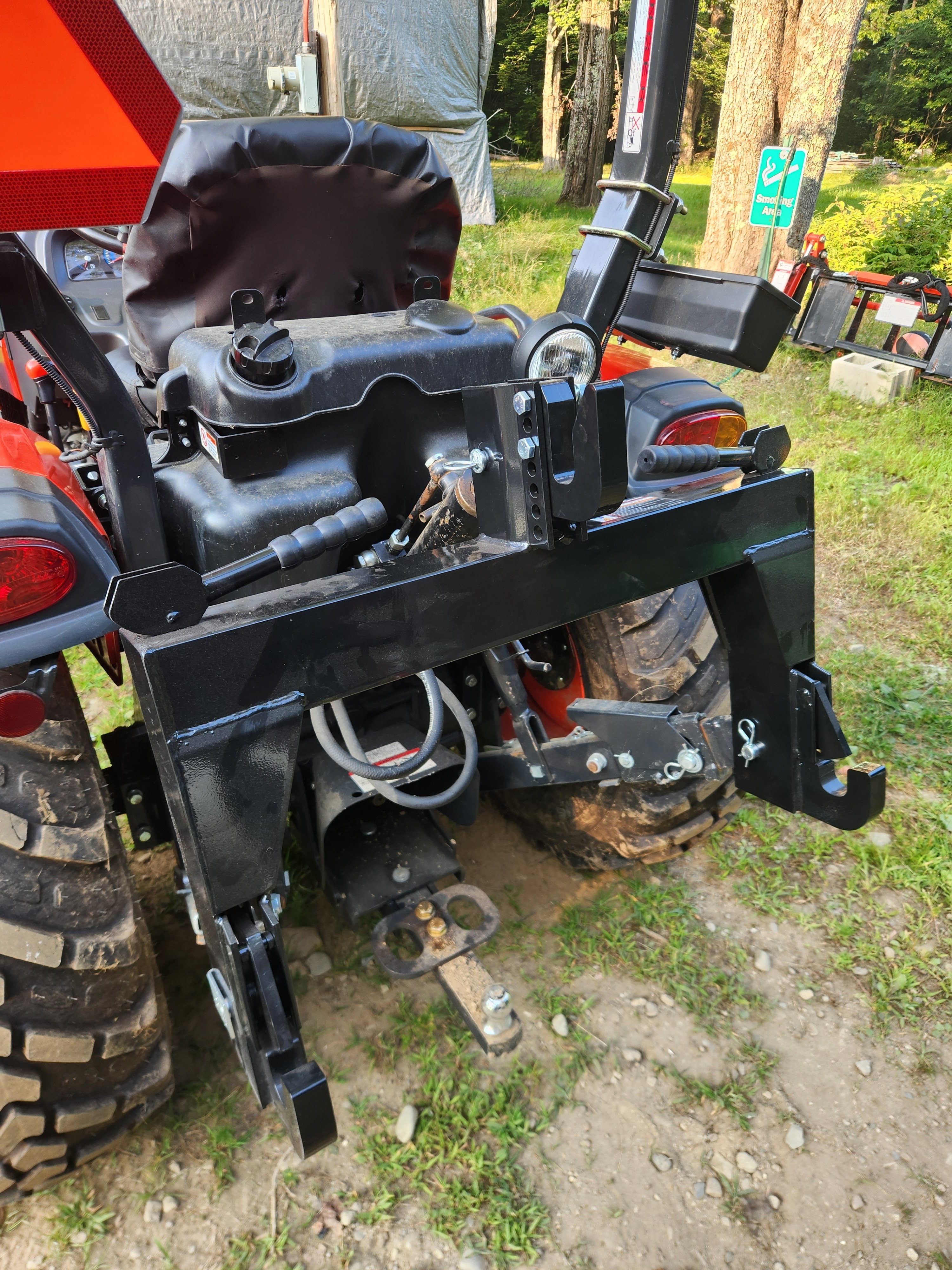

Well, I just picked up the Harbor Freight for $99, only to renew my membership for two years and immediately spend my savings.
No worries, still saved that money in some form.
I won't be installing it until the replacement hook arrives from KBOH. Of course that won't arrive until after I actually order it.

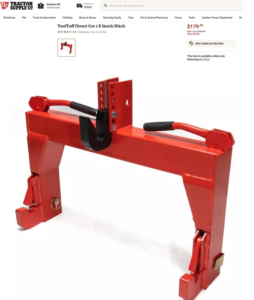

Just joining in the latest quick hitch thread I could find, about to put one on the Christmas list. This is for my MF 1723EB and after extensive internet research, here are my findings. Want one with the true CAT 1 pin size that needs no bushings.
Of course the Harbor Freight one exists, but as already mentioned not that great a bargain at this price.
At Tractor Supply we have the Tool Tuff which appears to be a SpeeCo clone that requires no bushings.
And a newcomer from Amazon is the Cammoo which is getting good YT reviews. Seems like the best bargain for what it includes, but does NOT have the extended top hook like the Tool Tuff includes. I'm giving this one a shot.

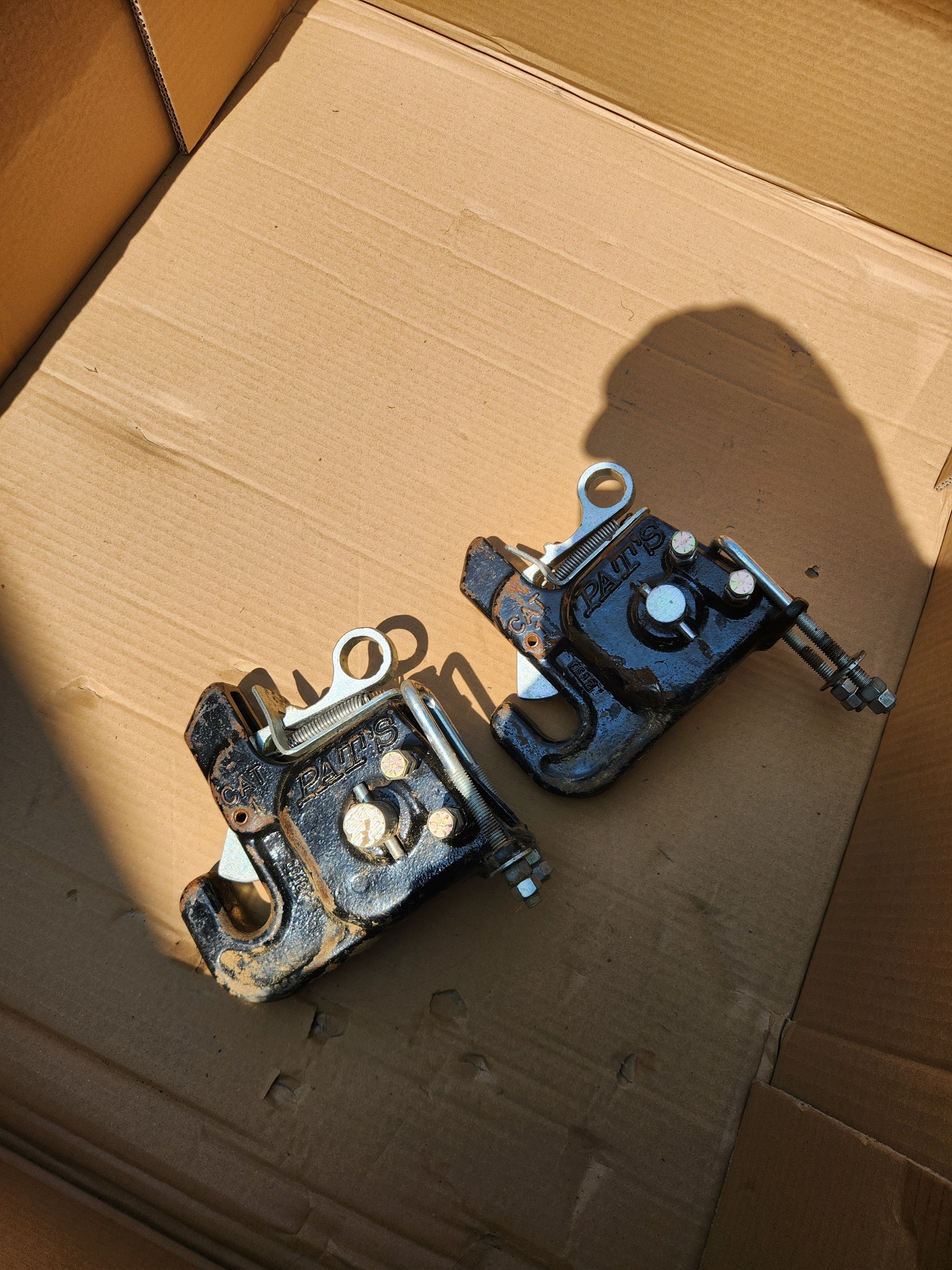

I bought the HF for $99 but discovered it didn't fit some of my older (favorite) attachments. Sold on CL fast and got the Cat 2 Pat's QH. Been very happy with it. The MX drag links adjust easily to any size. Usually I just line one up side and move the other. Takes less than a minute, no tools.
Both lock plate springs broke after a few years of hard use. They broke right at the end so I just bent down another loop and reattached em while I waited for replacement springs to arrive... which I never put on so I have spares.
Pats has worked good for me. I bought a used set here for my old internet challenged friend. He's happy too. I think Euro ends are better but require modification of the tractor arms. If I ever toss the Pat's I would go with the Euro ends just to keep the option to connect to varying width attachments. And the PTO accessibility

Pats fits my Kubota and my friends JD just fine. Enjoy the adjustable width for various new and older attachments I use in Cat 1 and 2. PTO shaft connection much easier to access without a QH. To each their own. Just saying Pat's works for some people. Even with Japanese tractors.
