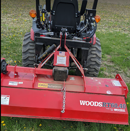

I bought a cheap QH from Vevor and it was complete junk. I was kind of in a pinch, doing a job swapping implements a lot, and went to HF and got one back in the spring.
I was pleasantly surprised how well it was built for the money. Have used it a good 35 hours and it is doing great on several different implements.

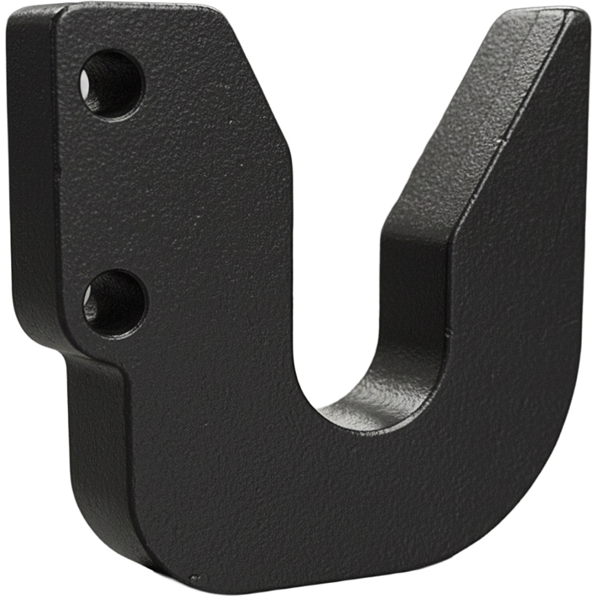

If you need a new top hook you can get one from amazon
for about $50. Someone said the top hook does not stand
out far enough to hook up.

Link to my post with photos showing the original and the Speeco stand-out hook.
Note the difference between the two right photos.
I have a couple of implements with the top pin set way back from the edge, so the pin wouldn't engage with the QH top hook. Buying the Speeco replacement hook solved the problem.
Not bad. Only $30+shipping. From your link in the other thread.
The Boltonhooks.com is $42, yet it goes out further. (y)
Accessories for Imported Quick Hitches - BoltOnHooks LLC
Now, one can reduce the length of the top-link to tilt the QH and the top hooking being further out. WHY? This title will then allow everything to be aligned once again.
