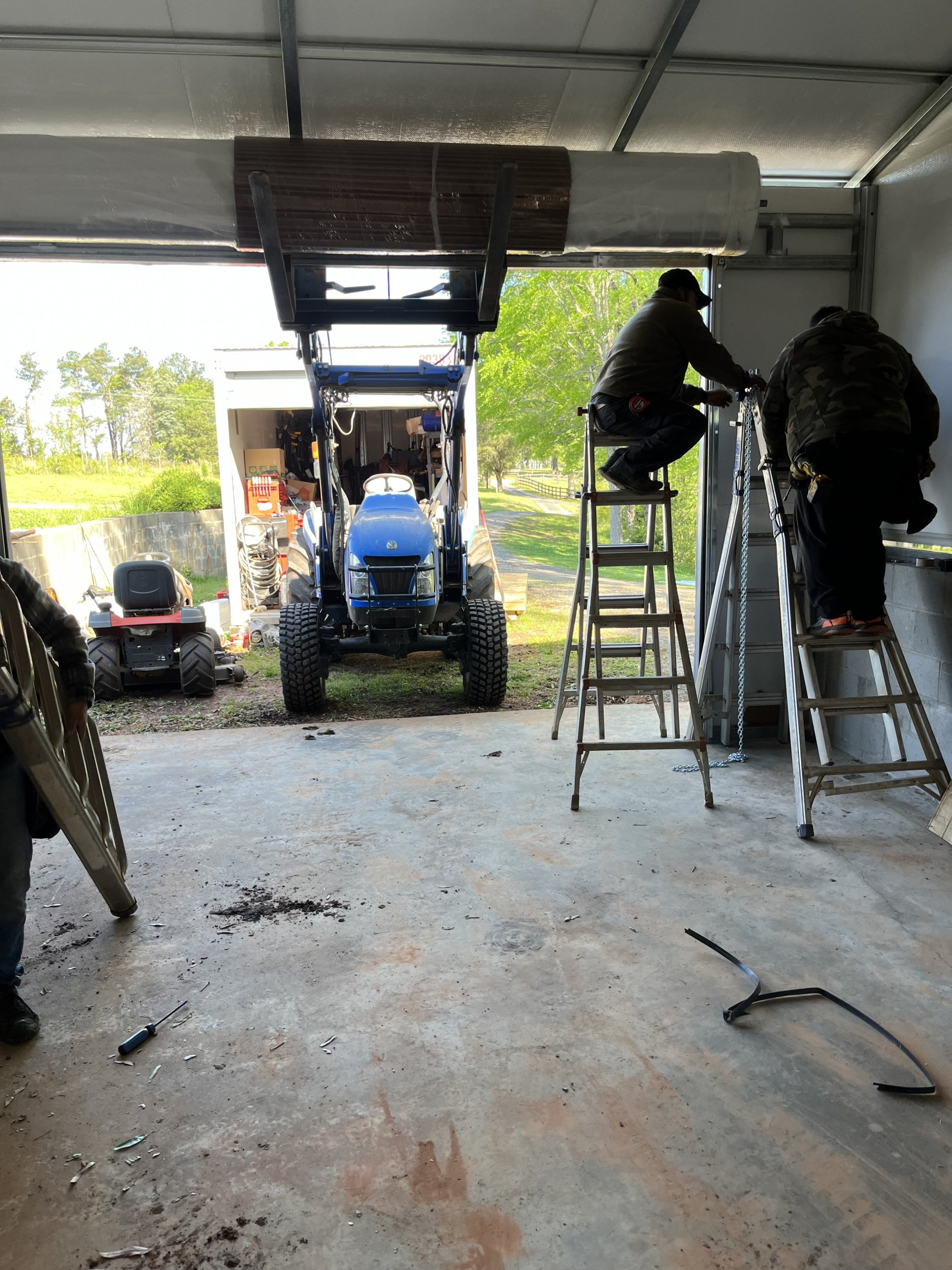

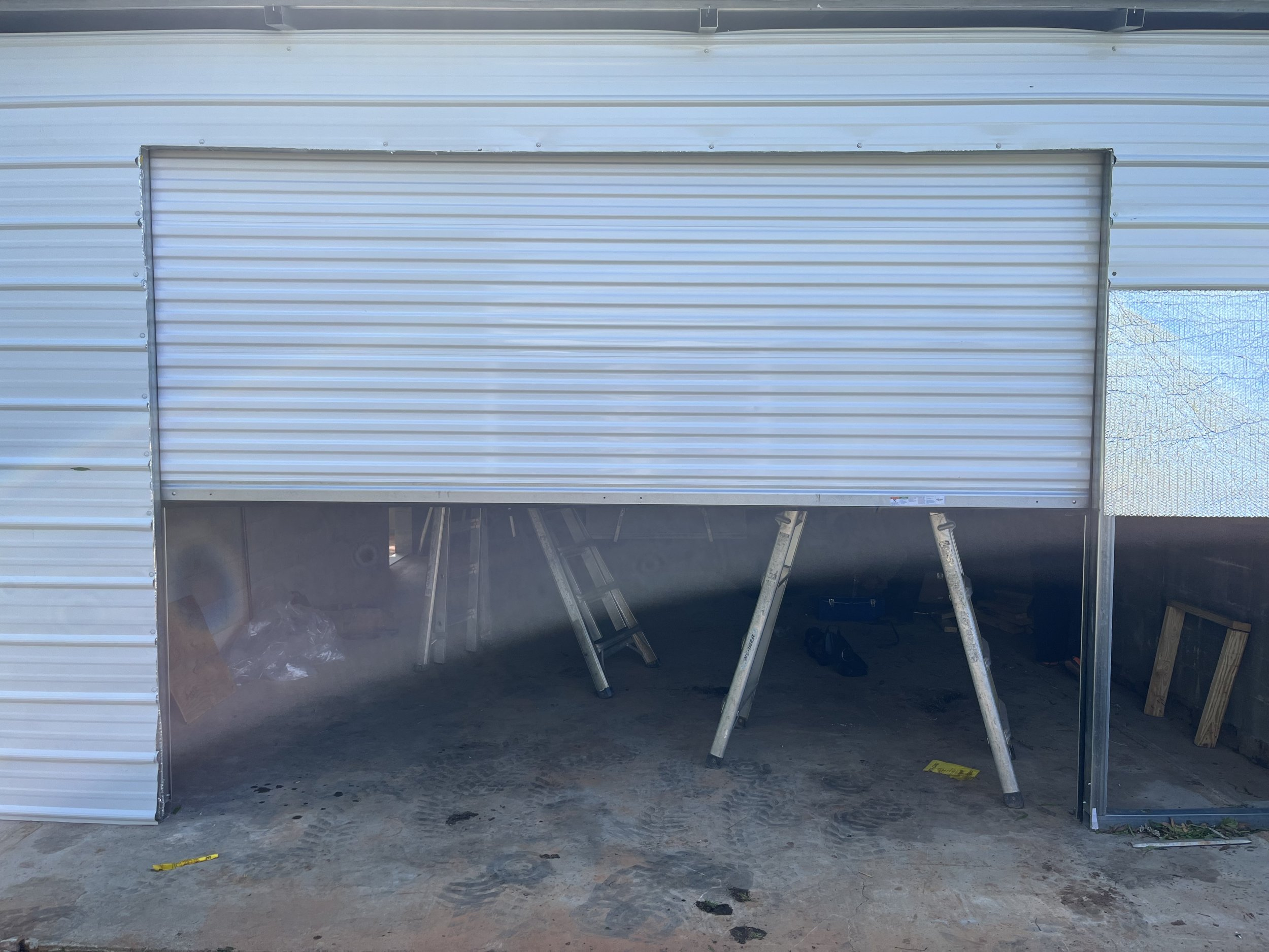

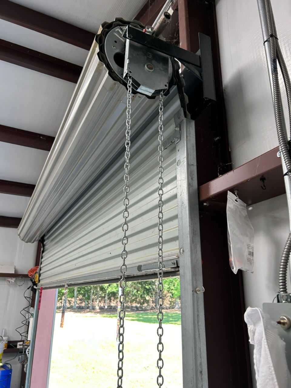

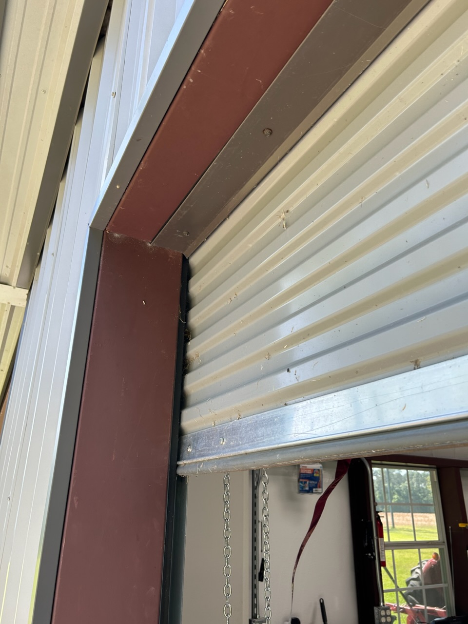

Thought I’d share some photos of my 8’x12” wide door. It was supplied by the building manufacturer as a $1000 or $1200 option in 2017. Only thing I find is Made in Canada stamped in the drum ends.
I am pleased with the door except I would like to somehow seal around the top and sides a bit better. Blowing rain doesn’t enter but insects and air does. I have considered the brush kit sold on Amazon. So if anyone has experience with the brushes I’d like to hear comments. Thanks.

View attachment 796396View attachment 796397View attachment 796398View attachment 796399
This is typical brush/retainer for what you want to do.
There’s multiple retainer and brush lengths.
Retainer gets screwed to jambs and header and brush touches the door

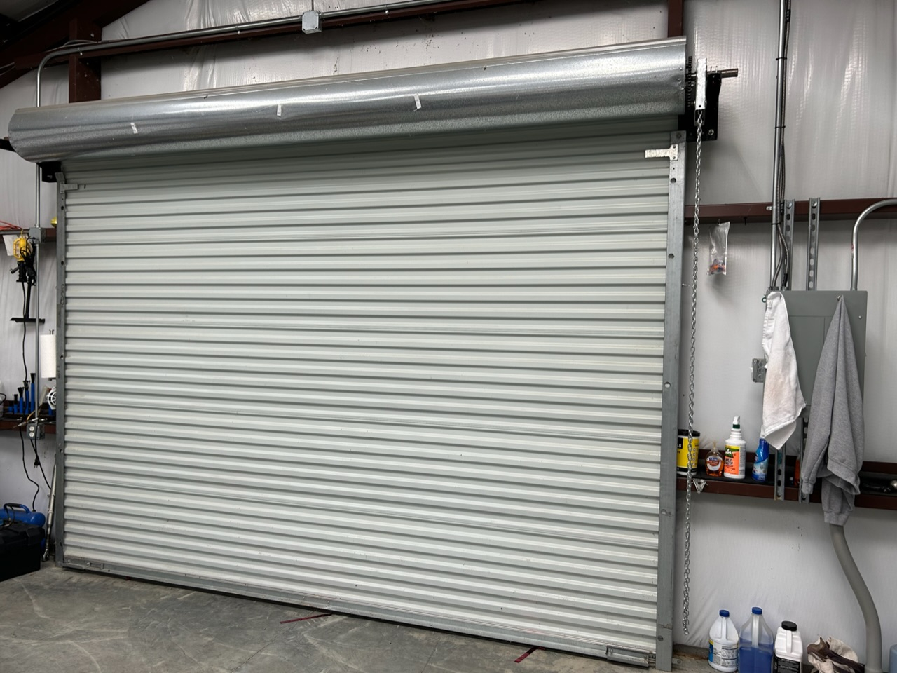

I have some experience with those doors. The first thing is the wind rating is only as good as the columns you attach them to. I used DBCI brand and they are OK. They work like others but for high use a Janus would probably be better since the weak spot on DBCI doors is the rubber strip on the edge of the curtain. I installed all the doors in my self storage facility and the ones also shown in my home shop. The 12x12 is on my woodshop and the 14x14 is on my auto/machine shop. That is the one with the Genie commercial operator. It is easy with a forklift

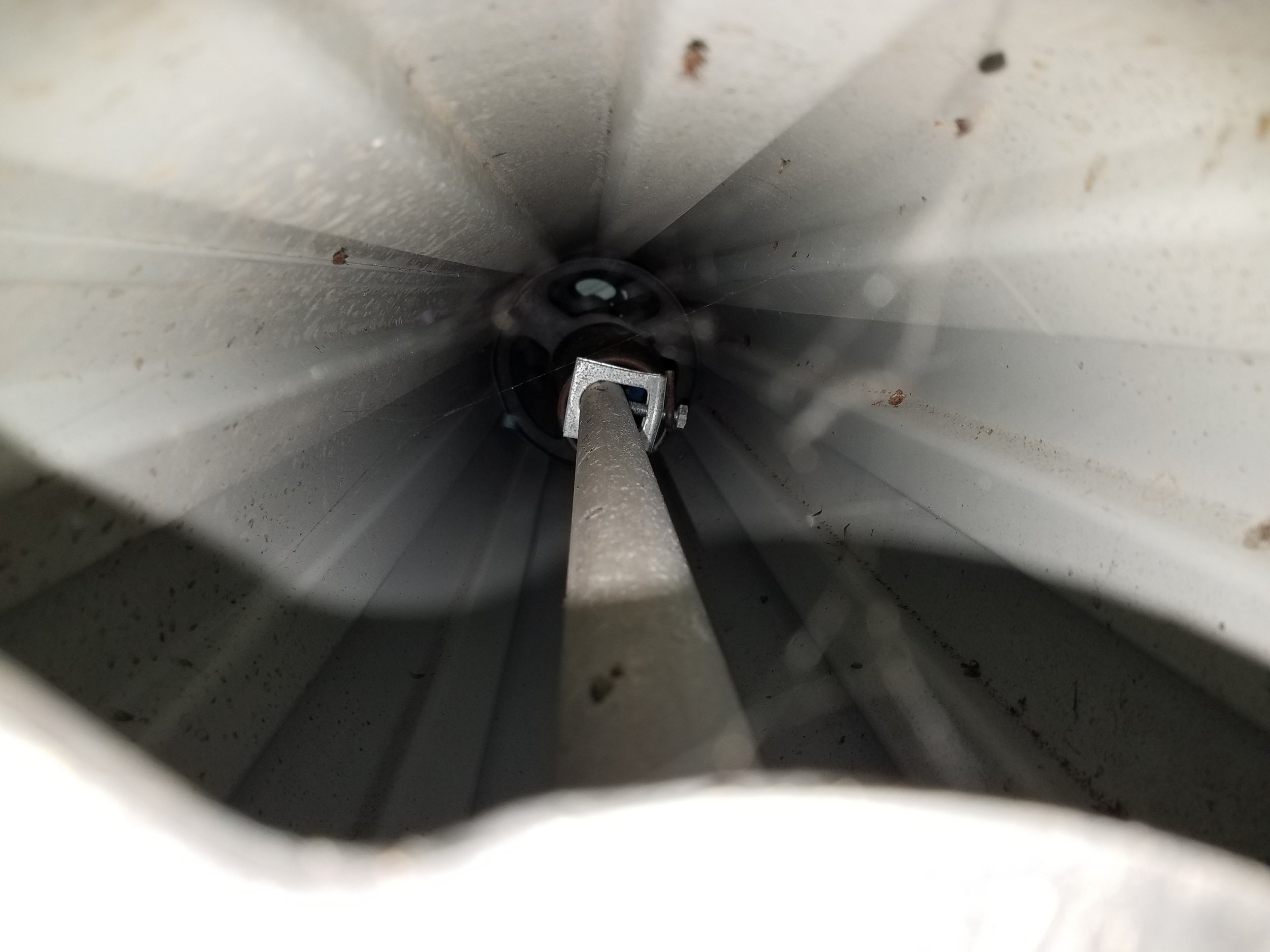

I have what I believe is a sheet door. Is there any way to adjust the tension to make it go up a bit easier. If I don't push it up the final foot and a half it wants to drop back down. I doesn't have the cams (?) on the end to put the bar in to adjust like the fancier ones. If you need a better picture of the door I can get you one when I get home. Thanks and sorry to hijack the thread.

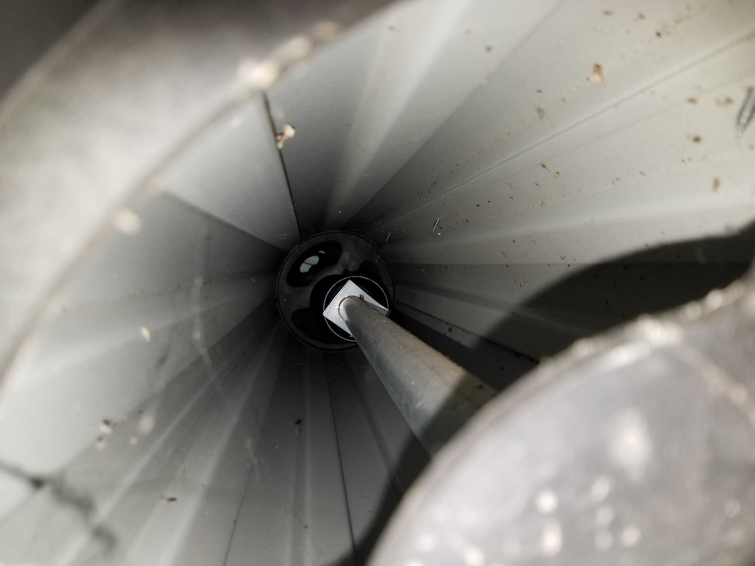

I’d need a picture of each end of the “drum” on the interior

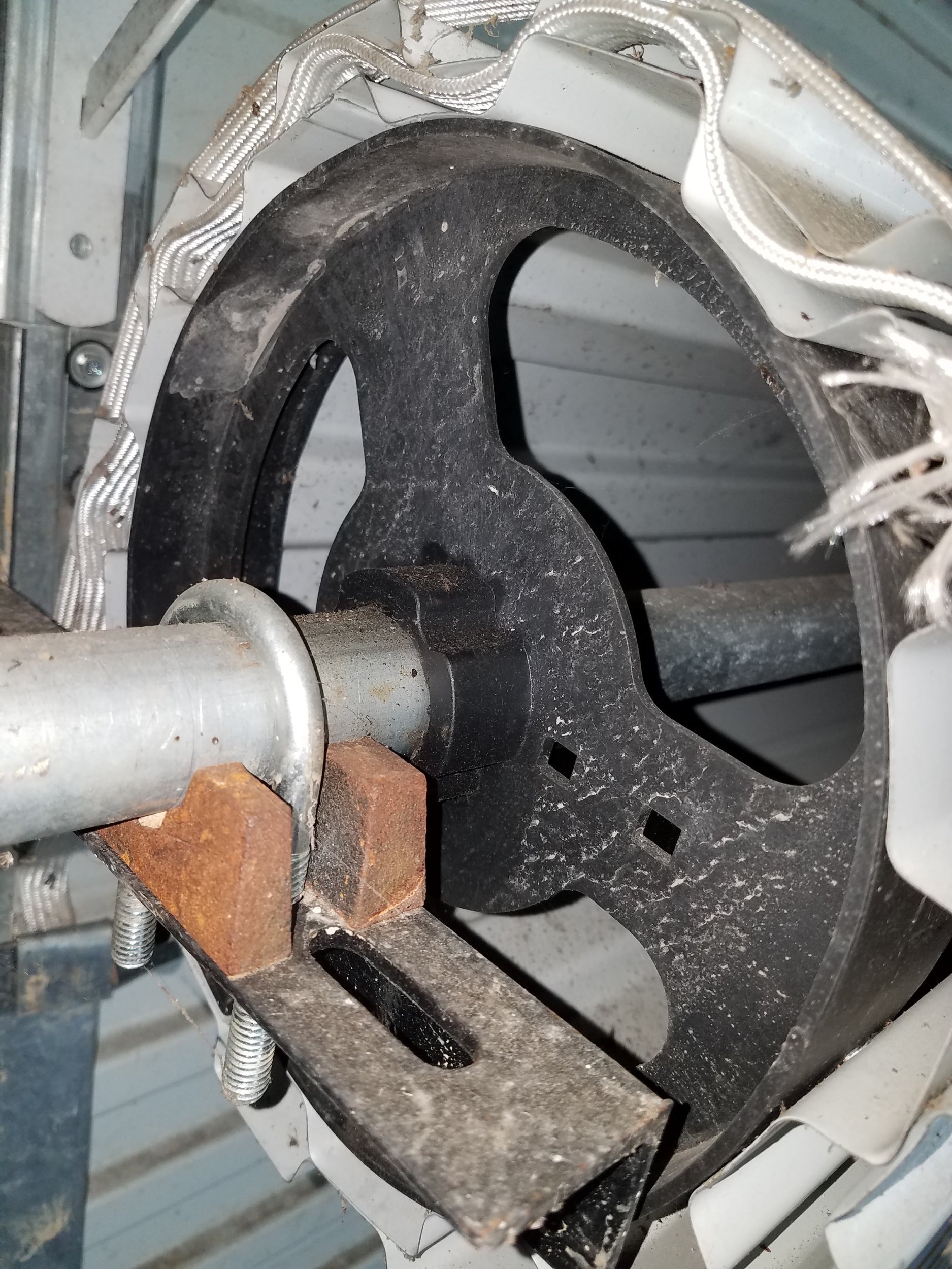

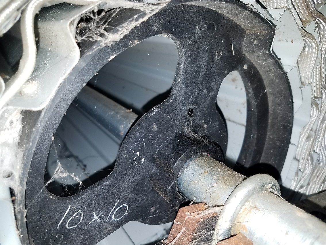

1st two are left side. 2nd two are right side. Facing the door from the inside.

View attachment 799188View attachment 799189View attachment 799190View attachment 799191
The “saddles” appear the same on both sides?
On that style we would open the door all the way, (usually have to remove the stops) put a ratchet strap to hold the roll tight and roll the door “closed” direction one additional turn.
Release the ratchet strap, pull door back down in the tracks and reinstall the stops.

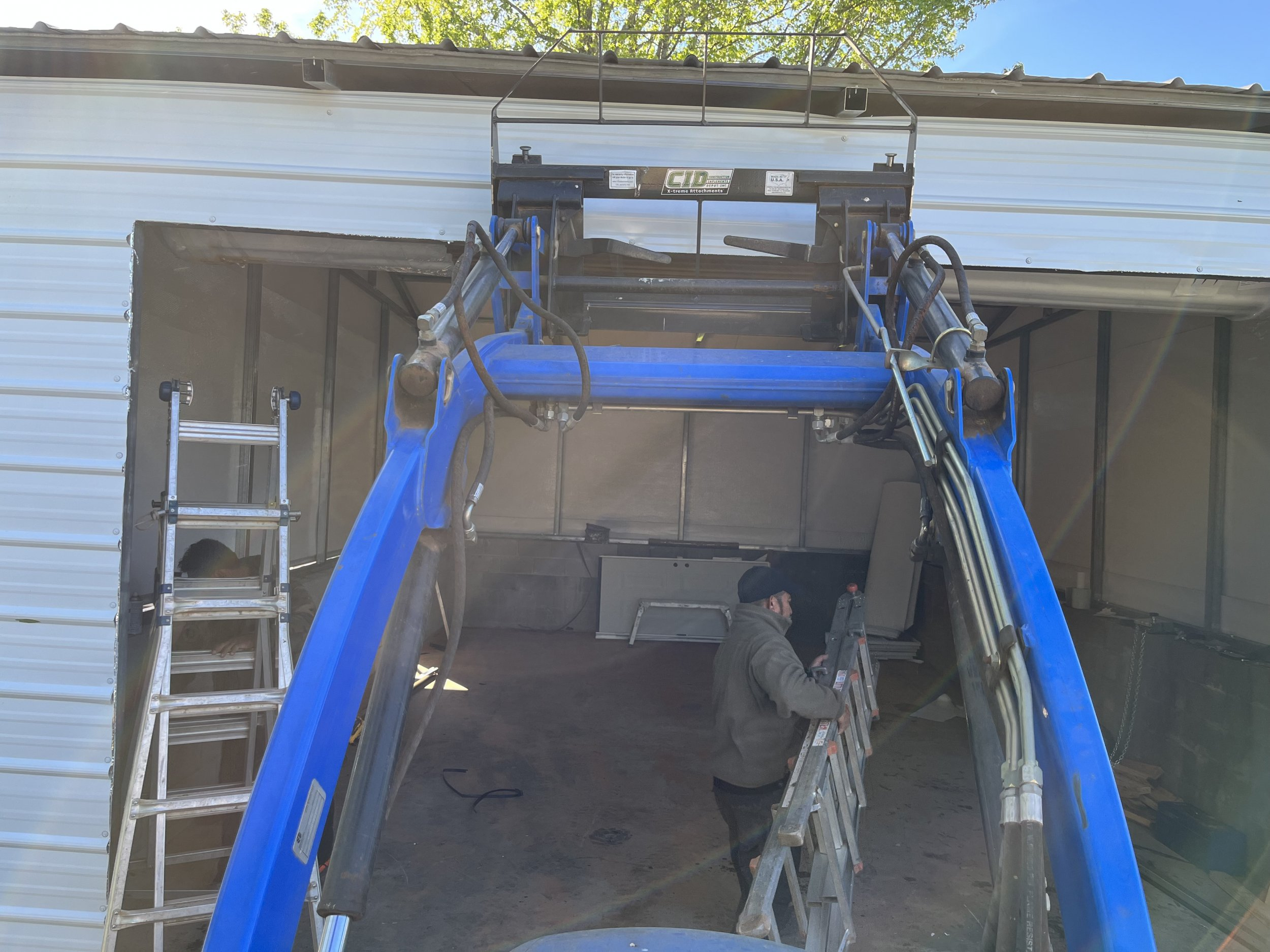

Installed them myself.
Off topic, but curiosity get the better of me - did you build the building around the shipping container? Or are they able to slip it into an opening that size - with "ease?' And, of course, would they be able to remove it as well?
