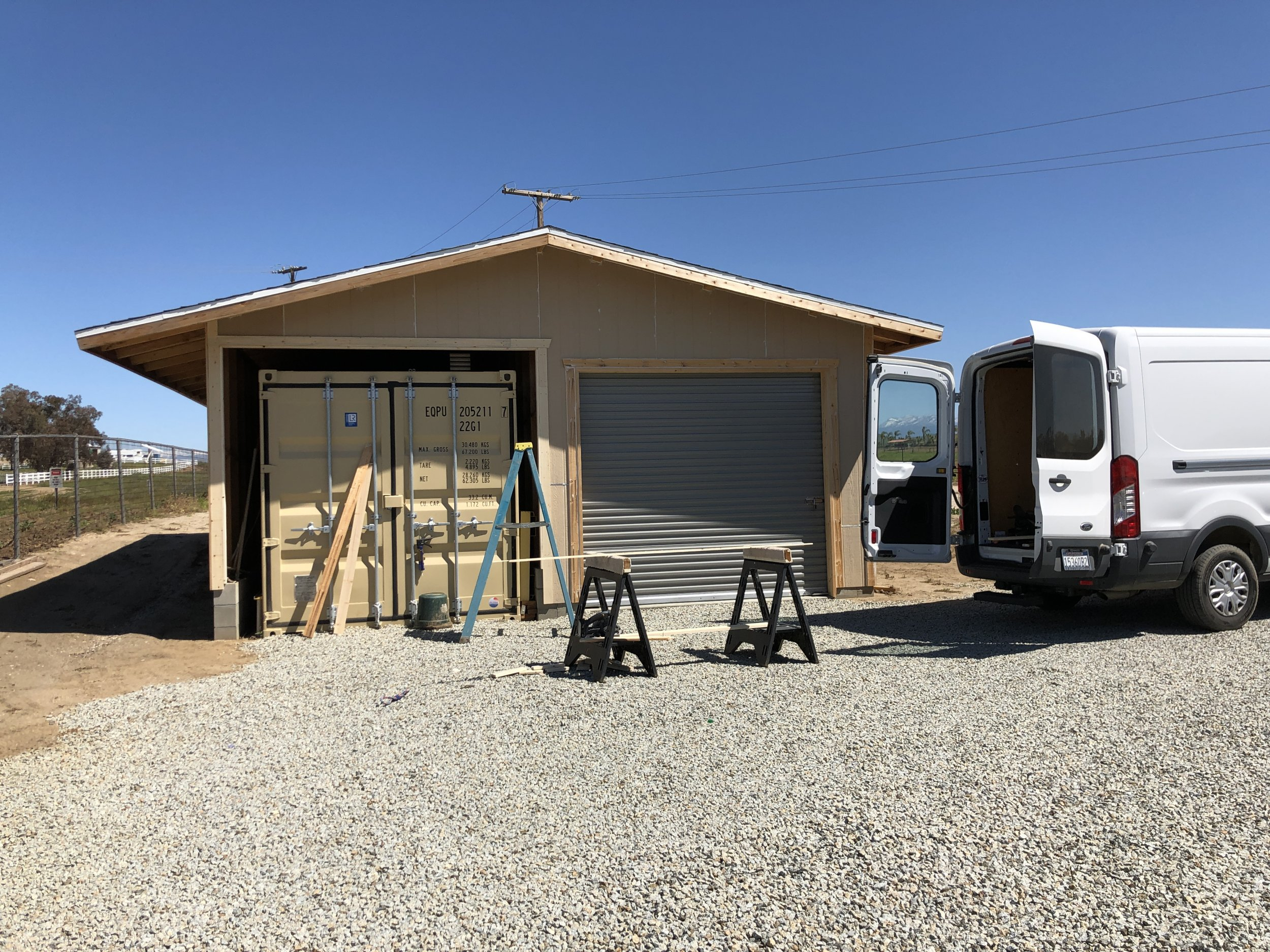

Bought 2 different doors online. Good experiences both.

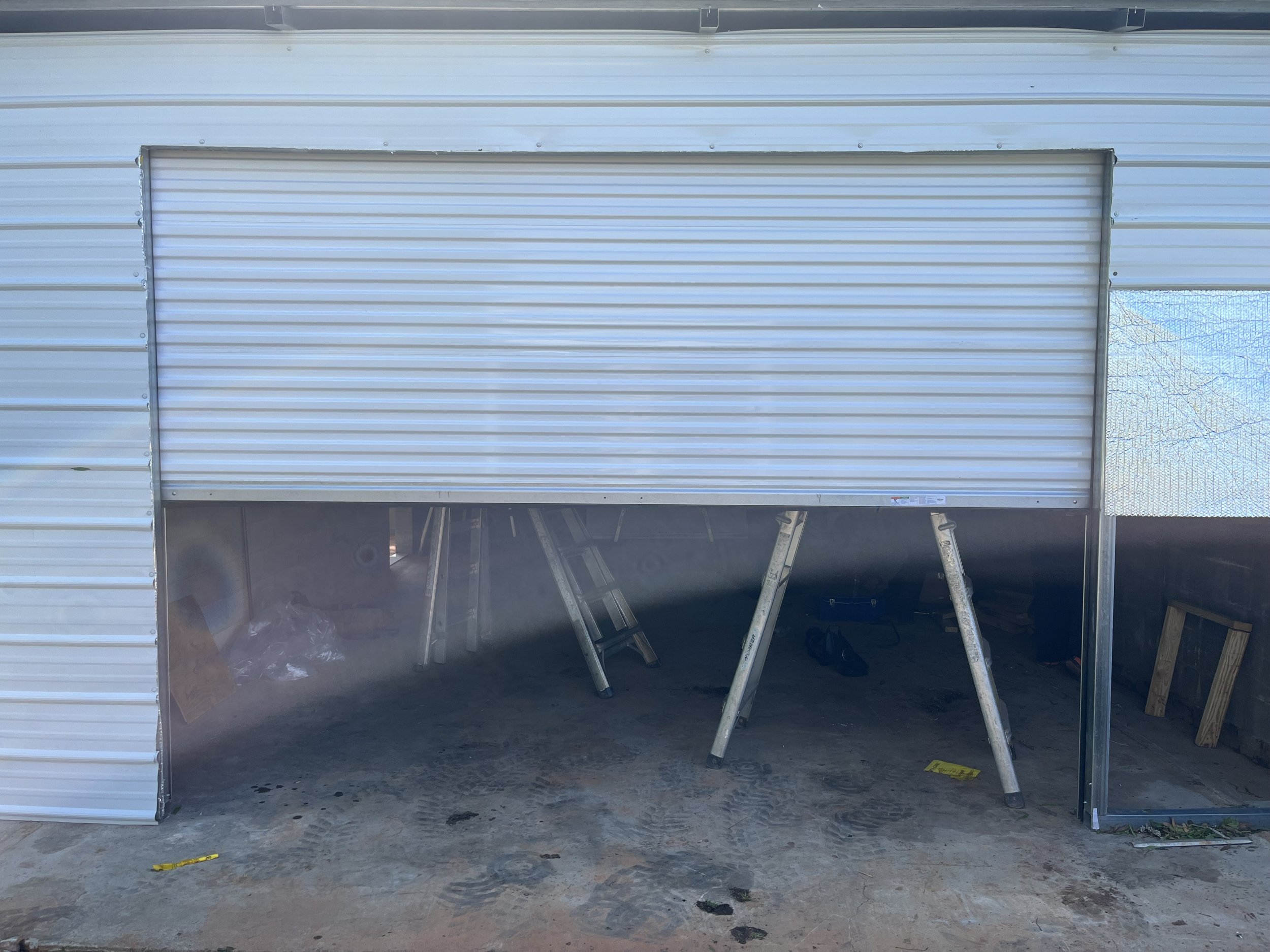

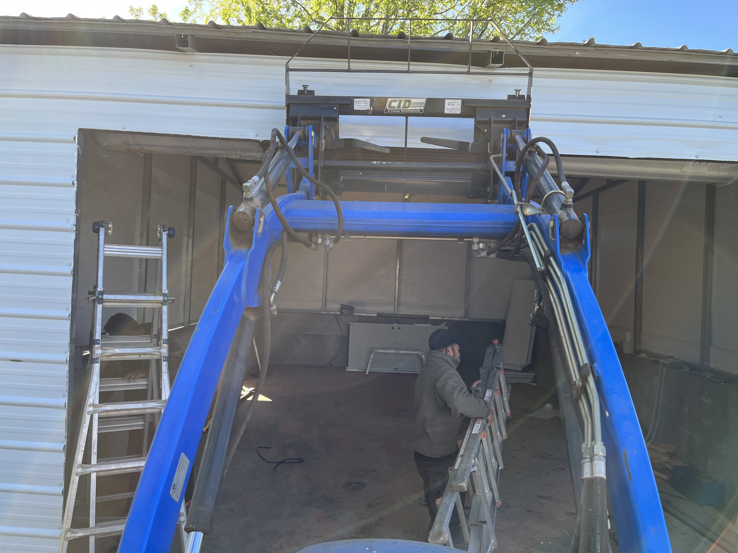

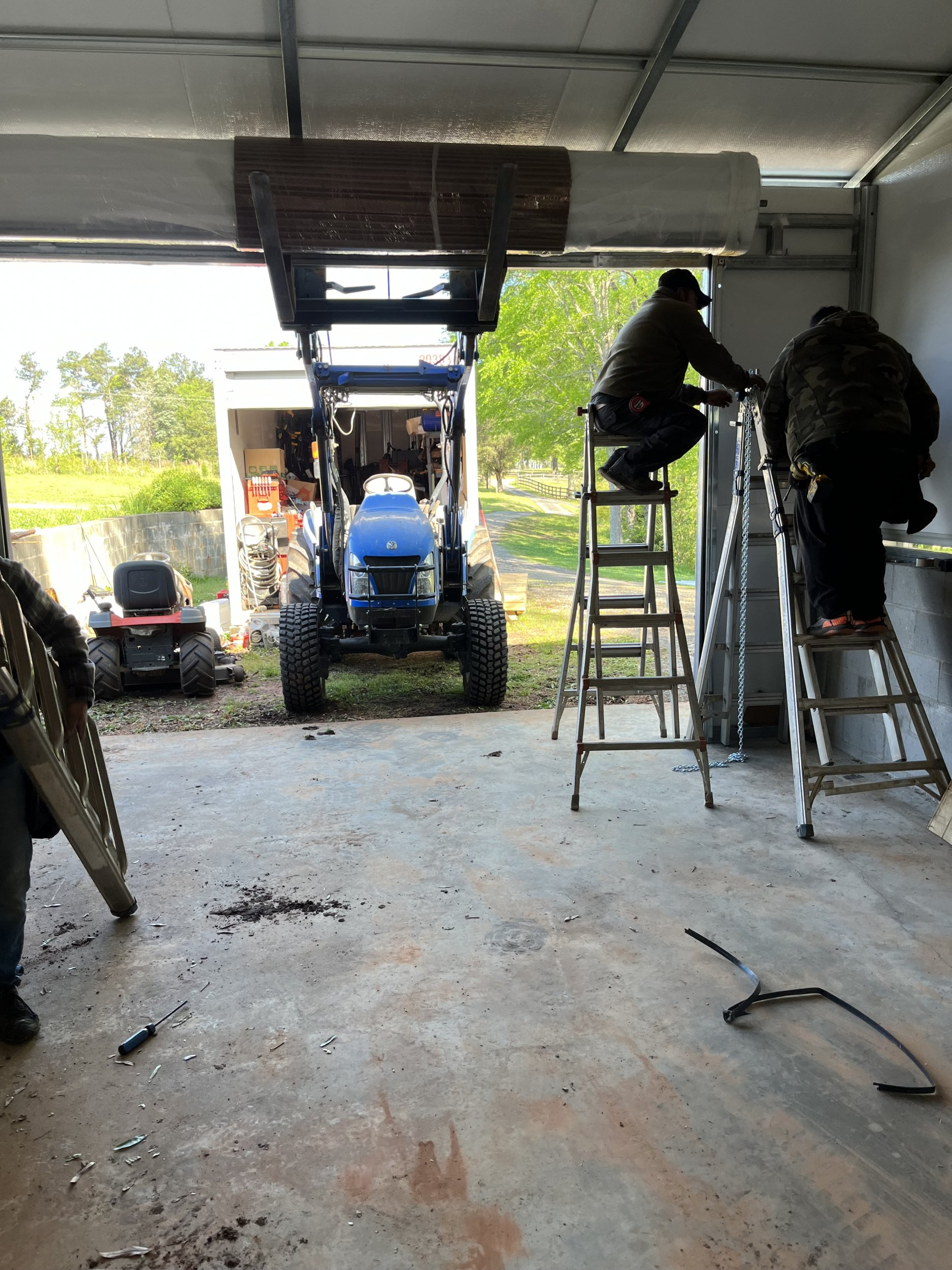

I just had one installed in our new garage from Janus 12’ wide by 102” tall that’s insulated and I like it. Shipped the packaged door was 525 pounds and almost 14’ wide.
Garage build link

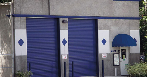

Coiling doors come in a few flavors
Trac rite
Janus
These are considered “sheet doors”
They are one continuous piece
Light gauge
Not typically available insulated
Self storage warehouses love them!!!
Some manufacturers do have the motor built into the drum.
They aren’t too bad as long as cycle count per hour is low.
Then we have rolling steel doors
(My typical world)
Cornell
Overhead door
Wayne dalton
Raynor
Sky’s the limit on price/size
Really for commercial/industrial use
R values up too approx 10
Motor or hand chain operated (depending on size)
They door require more substantial structure to mount to as compared to sheet doors
10x10 sheet door takes 2 experienced guys about 45 mins to install once in the building.
10x10 coiling door takes 2 experienced guys about 3 hrs to install once in the building.
Any other questions feel free to ask!
