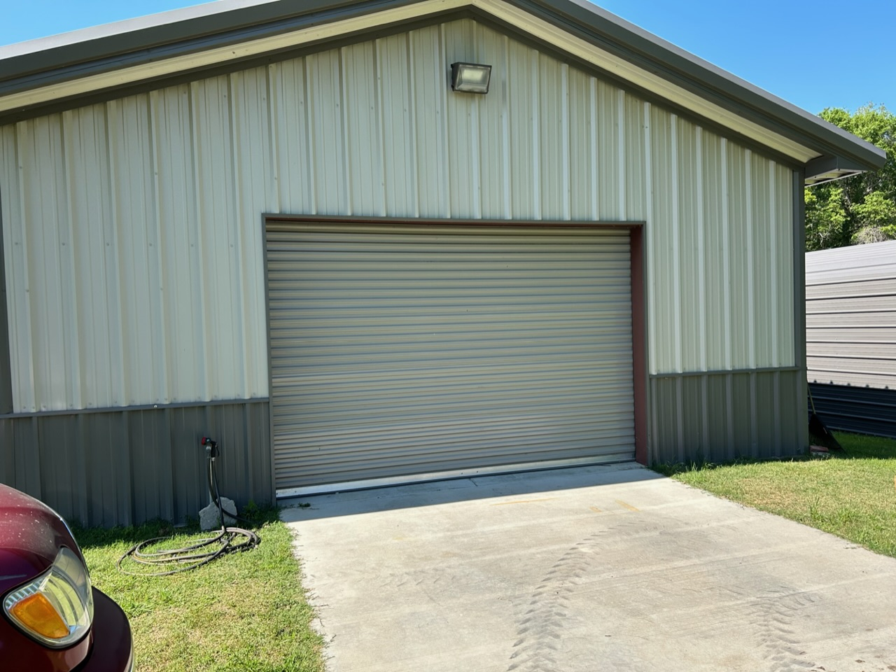

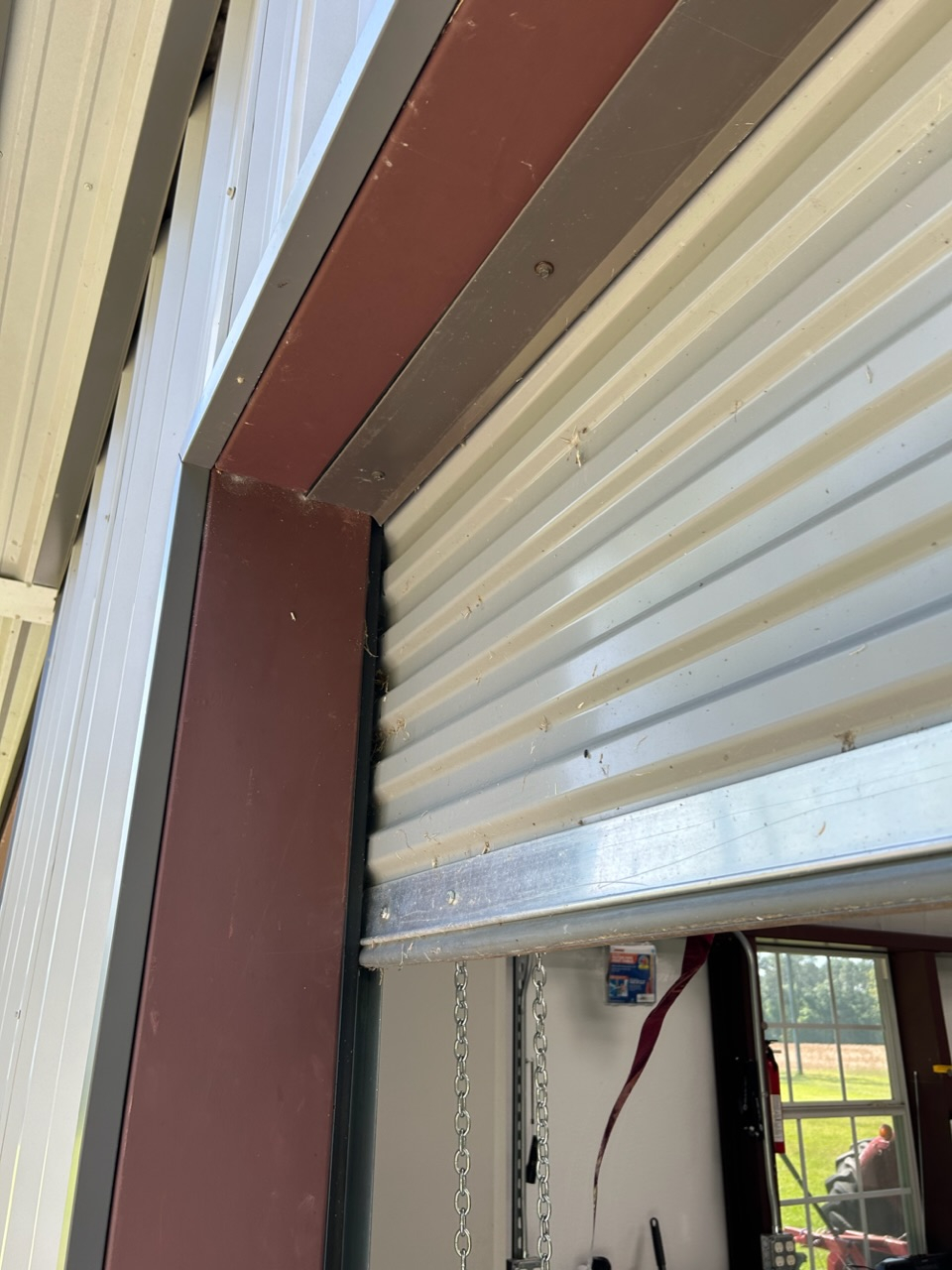

Thought I’d share some photos of my 8’x12” wide door. It was supplied by the building manufacturer as a $1000 or $1200 option in 2017. Only thing I find is Made in Canada stamped in the drum ends.
I am pleased with the door except I would like to somehow seal around the top and sides a bit better. Blowing rain doesn’t enter but insects and air does. I have considered the brush kit sold on Amazon. So if anyone has experience with the brushes I’d like to hear comments. Thanks.
OP, sorry for horning in on your post. :giggle:
View attachment 796396View attachment 796397View attachment 796398View attachment 796399
This is typical brush/retainer for what you want to do.
There’s multiple retainer and brush lengths.
Retainer gets screwed to jambs and header and brush touches the door

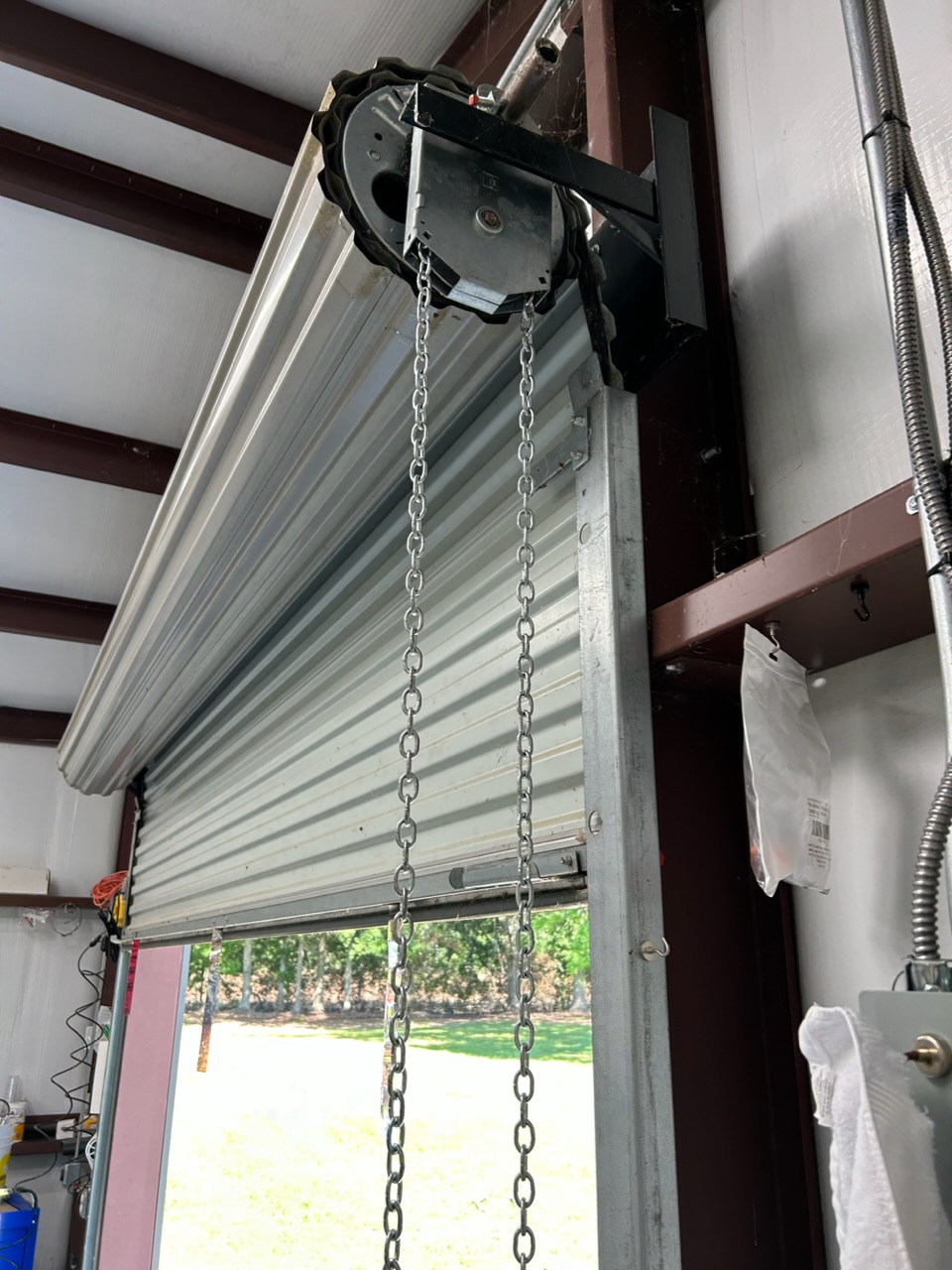

Any commercial door company should be able to provide all you need. Chain drive will be cheaper but can only operate from one side. Electric could be rigged to operate from both sides.

Door edges are closed off with a "brush seal". Keeps out bugs, dust and birds (which would otherwise go around the edges to build nests where it is warmer and more protected than in some random tree. They also poop all over everything inside the building).
Brush seal mounts with structural self tapping screws driven by a VSR drill. Trim to length first, check that there isn't anything behind where the screws will go (wiring, etc.).
You also want a brush seal for the top of the door. Check for other gaps around the door, you may want to put some flashing over any gaps you find.
Brush seals are not very expensive if you shop around, but prices I found were all over the map. Easy to install, and CURED the problem.

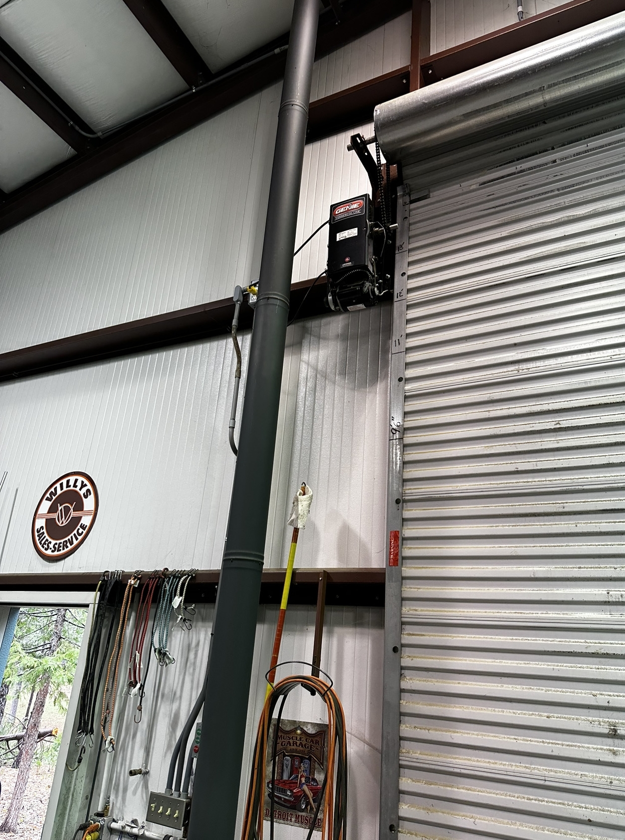

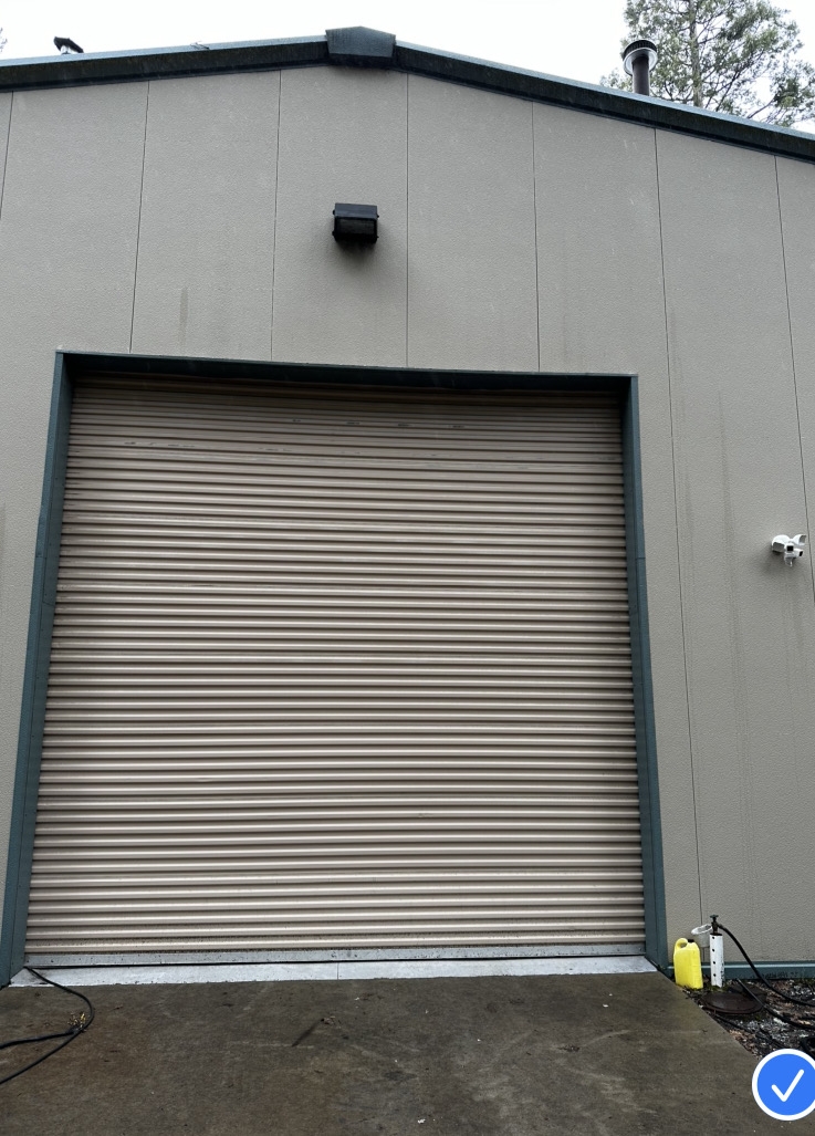

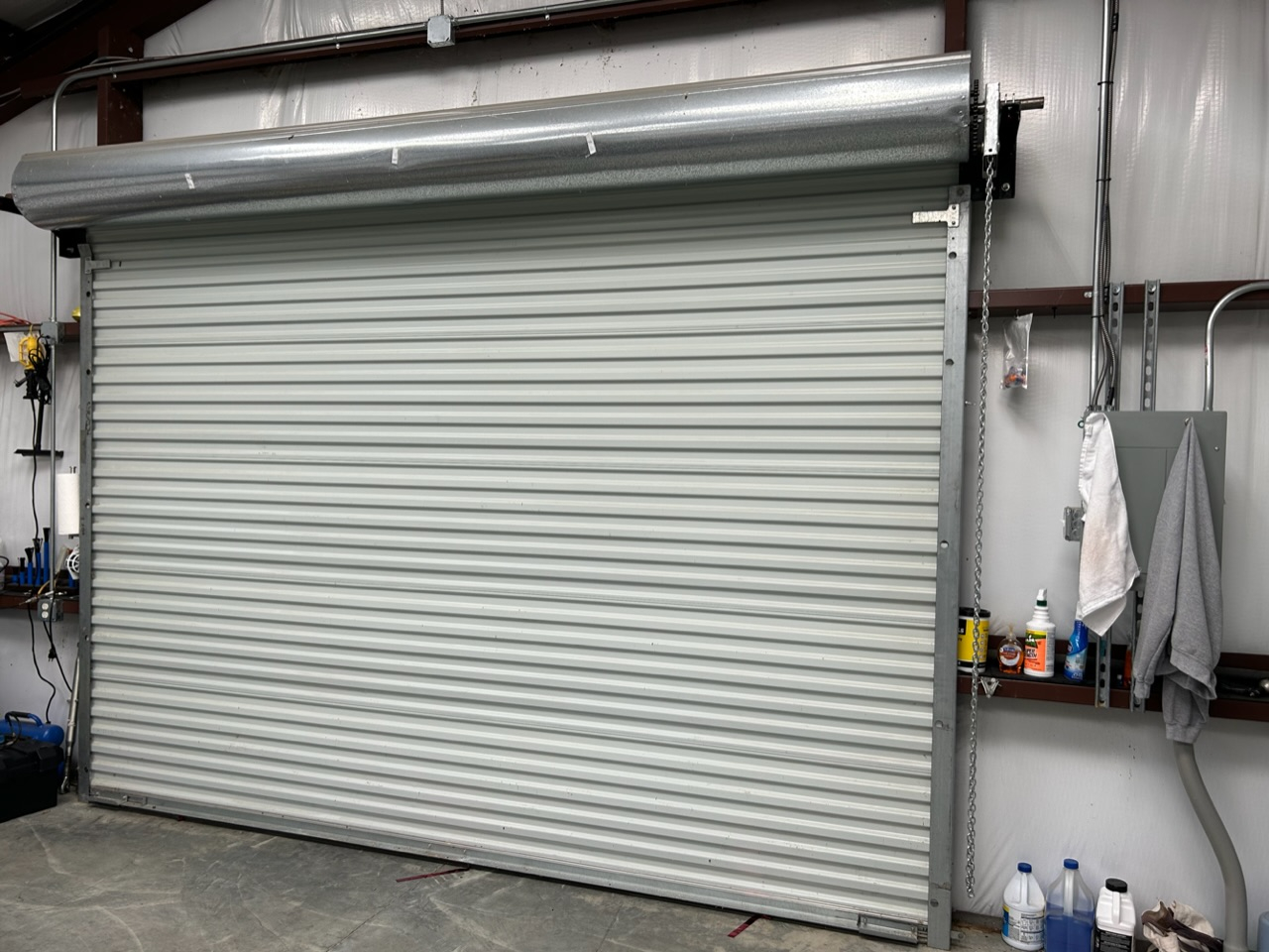

I have some experience with those doors. The first thing is the wind rating is only as good as the columns you attach them to. I used DBCI brand and they are OK. They work like others but for high use a Janus would probably be better since the weak spot on DBCI doors is the rubber strip on the edge of the curtain. I installed all the doors in my self storage facility and the ones also shown in my home shop. The 12x12 is on my woodshop and the 14x14 is on my auto/machine shop. That is the one with the Genie commercial operator. It is easy with a forklift
