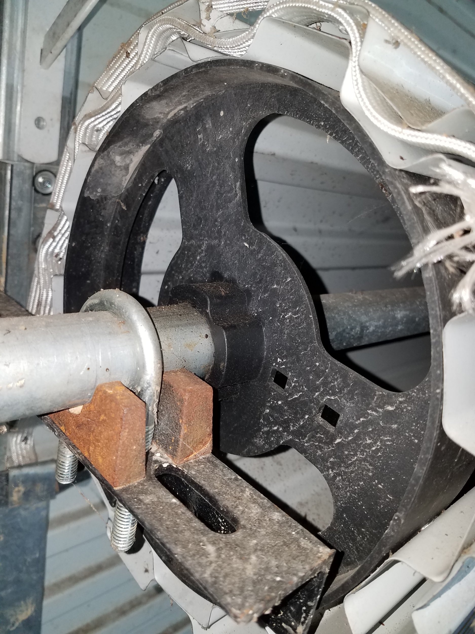

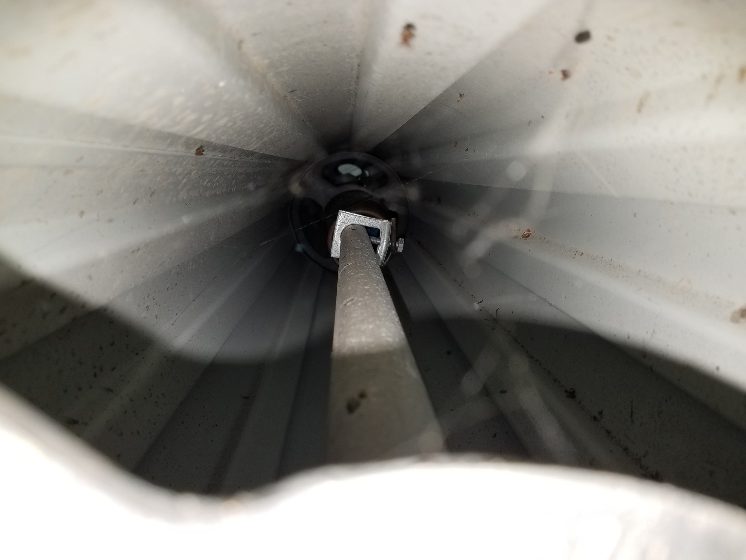

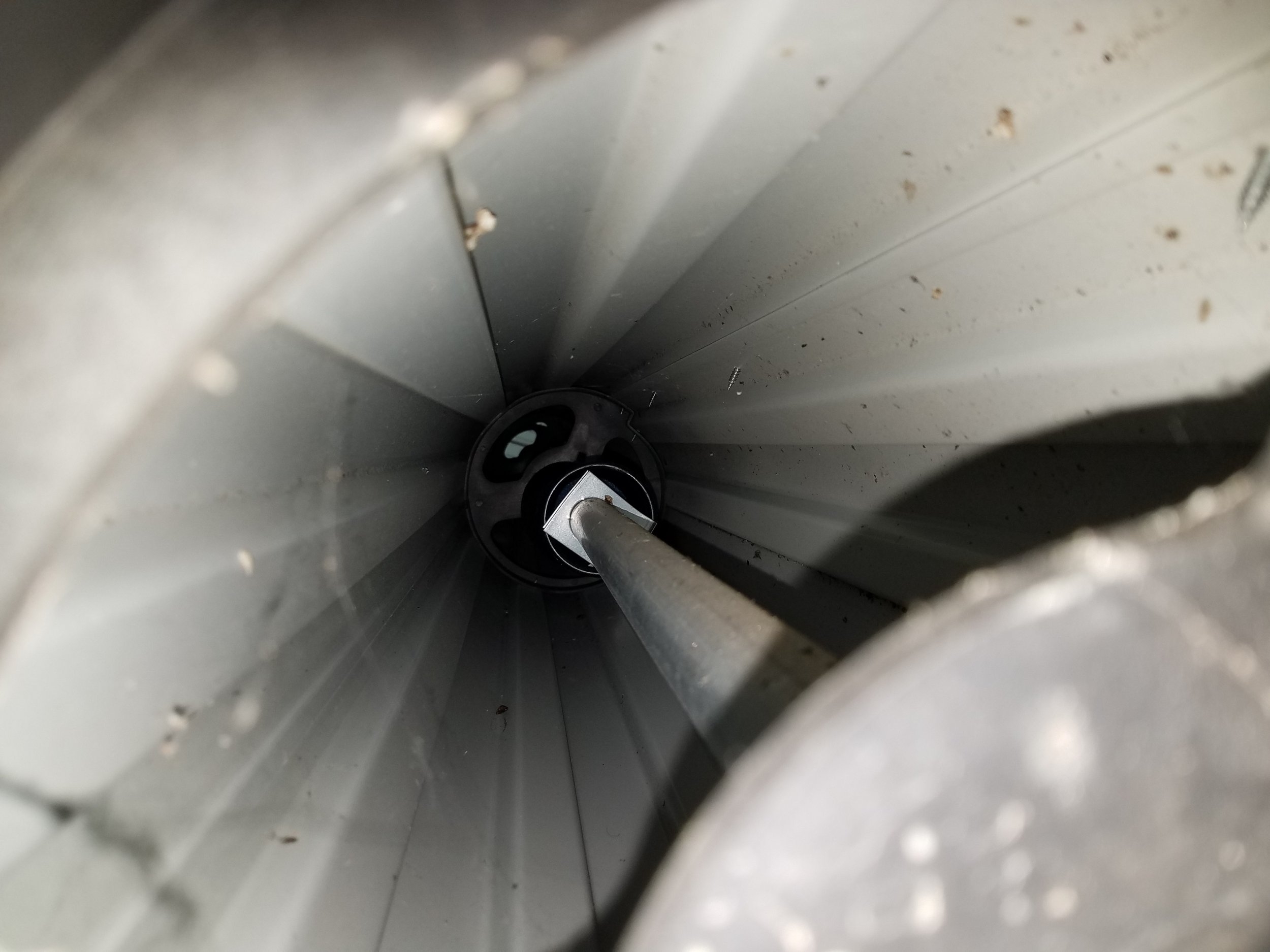

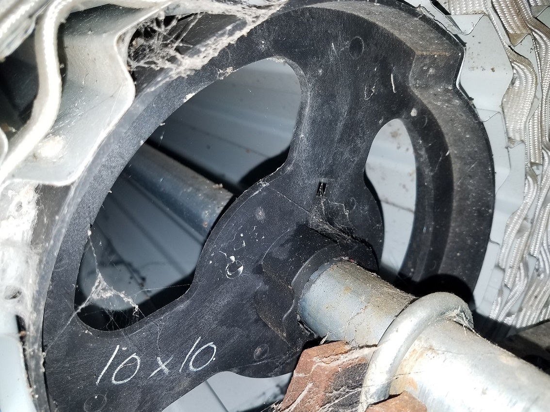

I have what I believe is a sheet door. Is there any way to adjust the tension to make it go up a bit easier. If I don't push it up the final foot and a half it wants to drop back down. I doesn't have the cams (?) on the end to put the bar in to adjust like the fancier ones. If you need a better picture of the door I can get you one when I get home. Thanks and sorry to hijack the thread.
I’d need a picture of each end of the “drum” on the interior
1st two are left side. 2nd two are right side. Facing the door from the inside.

The “saddles” appear the same on both sides?
On that style we would open the door all the way, (usually have to remove the stops) put a ratchet strap to hold the roll tight and roll the door “closed” direction one additional turn.
Release the ratchet strap, pull door back down in the tracks and reinstall the stops.

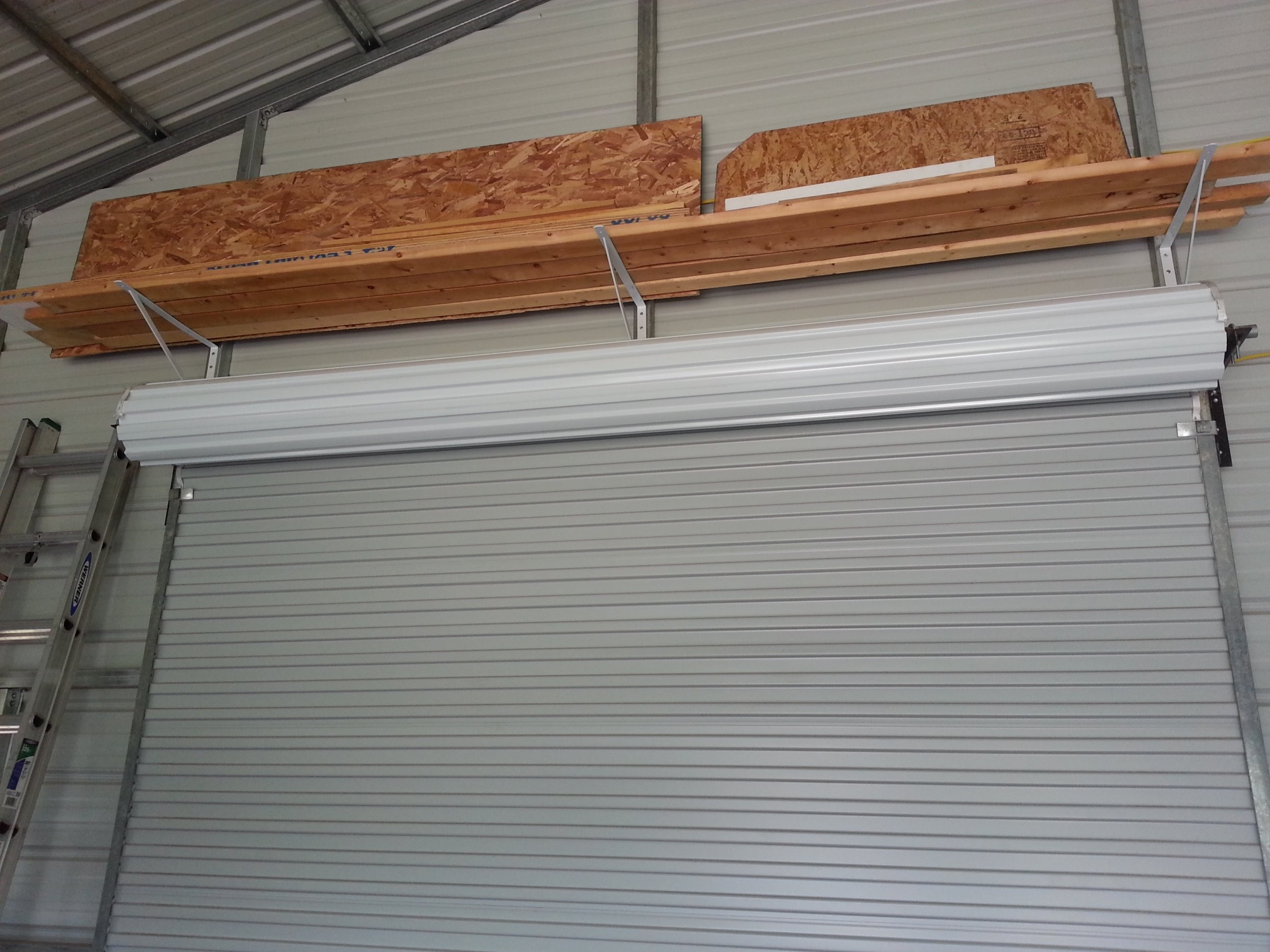

Installed them myself.
Off topic, but curiosity get the better of me - did you build the building around the shipping container? Or are they able to slip it into an opening that size - with "ease?' And, of course, would they be able to remove it as well?
