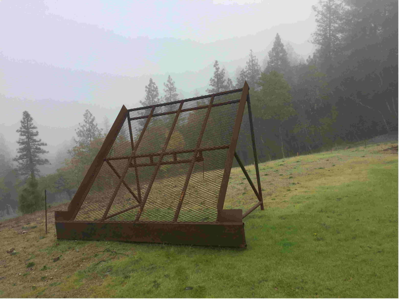

I have a large screen (maybe 6' x 8'), made from steel tubing and expanded metal which I have used very successfully to perform much the same function.
Essentially the screen is set at a 45 degree angle and I dump a rock/dirt/sand mixture on it. Rock doesn't go thru, dirt/sand does go thru. No moving parts and it is much faster than the implement shown.
To get all of the fines separated from the rock I need to screen twice, but that is still faster than the video.
And, there is a second use for the screen. By dumping alternating loads of compost/dirt on the screen I can "mix" the materials. I say "mix" because what it is really doing is producing alternating layers of the different materials, but scooping this up with the loader and moving it to a final location will produce a very good mixture.
I will try to get pix tomorrow, but I suspect that trommel is very overpriced compared to a simple screen.

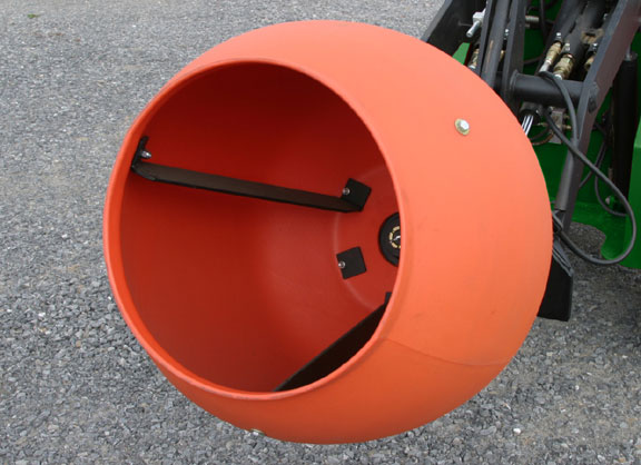

They do make a cement mixer, but I think it would require a little cutting.

OK here is an image of my screen. The size of the screen is actually 8' x 8', I used two 4' x 8' pieces of expanded metal side by side. It is elevated about 12" to allow material to build up as it is separated.
This is not going to be as efficient in collecting all of the fines as the trommel, but for the price and simplicity, I can screen the rocks several times to improve separation efficiency.
The structure below the horizontal bar behind the screen allows me to pick up the entire assembly with the FEL and move it around.
I reduced the pixel count of the image for faster loading. Zoom in to see the details of the expanded metal.
