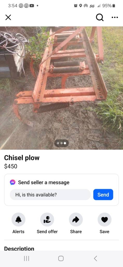

I’ve definitely wanted a chisel/APP for some time now.
The 1100 dollar one I mentioned is the crop king sold by Agri Supply. Seems like an OK unit, but I dunno how rugged.
Looked around and I can find some pretty big chisel plows around but they’re 8-9 footers. Think my ol girl might not like that. But I suppose I can use the torch and make em a 7’ 3 pointer.

So, that APP is almost the same as what I got, although mine is an older Massey/Ford/deerborn/who knows. It does a good job, and actually is better heavy duty, as long as A, you going at a medium slow speed, and allow the springs to trip and reset; and B, you don't turn to sharp with then down. Replacement complete tine assemblies, with springs, rippers, and tips are like $111, so not cheap, but if you do need to replace 1, it's not the end of the world.
It should pull those rocks up towards the surface, for gathering, piling, ect.

How's the existing vegetation? Lot of tree roots, crop residual, briars,? The APP does a good job on roots upto about 1.5", but when you get much bigger than that, it's not the tool for the job. It's not going to turn virgin soil to crop land in a single pass either, you will likely need 2 passes E to W and then 2 passes N to S (or at angles).
So, it will absolutely gather roots, and vegetation, that you may need to pull out and burn, and as pointed out, it doesn't chop like a disc (although IMO a disc doesn't chop veg as well as some think).
