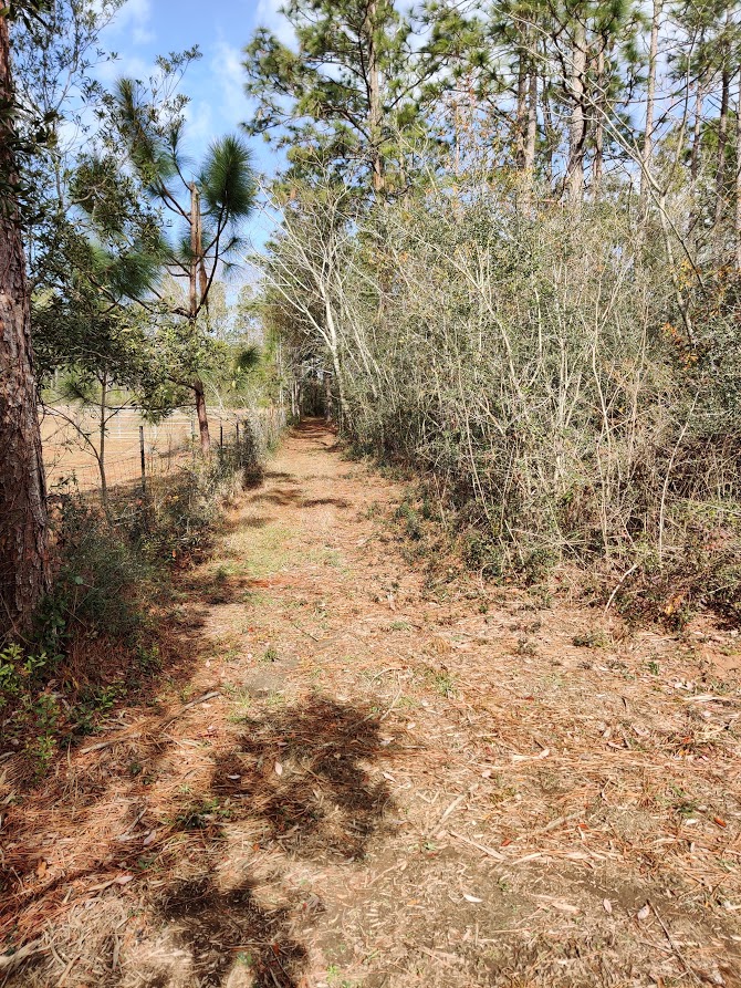

Tried all of those things and they didn’t help much. Works decent as long as there is no leaves on the ground, but it won’t cut through the leaf layer if there is one. Just rolls on top of them.

The land is already cleared. I just need to break up the ground to bare dirt in a ring around the edge of the plot so that fire can’t cross it.

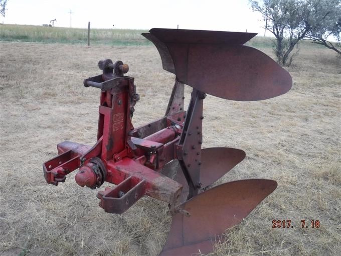

Posts 27 & 28 sound like something worth trying. A mouldboard (called turning plow here) can make a mess if not careful and experienced and you are limited to a straight path.

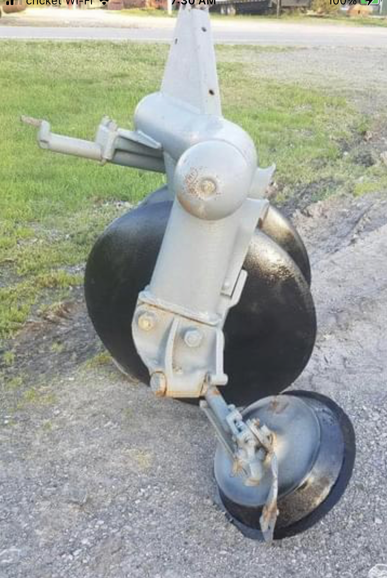

Any thoughts on the 2 blade Ferguson disk plow?
/ What Attachment for Making Fire Breaks? #31
Me? I have no experience with a disc plow. Its been years since using a turning plow too. We had a MF 55 rollover plow pulled by a MF 135 for a few years on 10-20 acres. If you try either type I suggest going no deeper than necessary to bury the trash, particularly on the first and last passes. With the turning you create furrow/ditch and then a hump. The rollover was a godsend from a standard plow.

I did take a look at a middle buster and those are around $150. I may just go that route. A couple passes wide with a middle buster would be about the same as a 2 bottom plow for my purposes. And I would be going in an oval shape, so the traditional plow might not be good for making turns.
If it's within your budget go for it. There would be three bearings to look out for but they won't be expensive to replace. 2 on the discs and another on the furrow wheel. I don't know any thing about these but to me it looks like there should be some kind of depth adjustment for the furrow wheel. Maybe someone who knows can speak to that. If there is a model number you could go to a Massey parts website and look it up.
