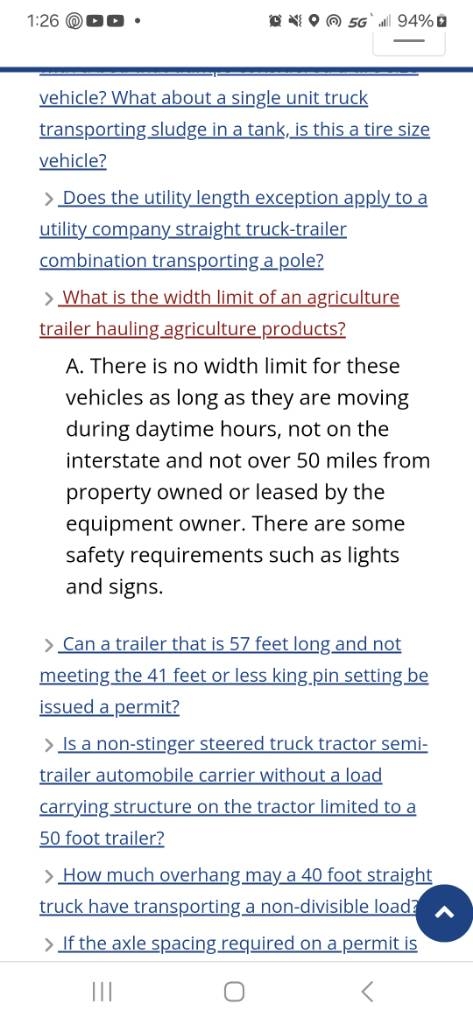

In some states, unless you're engaged in agriculture as a primary income, you cannot legally take a tractor on the road. That opens all sorts of insurance liability issues.
