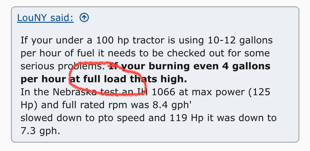

It would be interesting to track the fuel burn.
I never think of mpg when I fill a tractor tank ;-)
   / How far is too far for driving tractor on the road? #64
Most machines hold between 6 and 12 hours of fuel at operating RPM, so after 4 hours on the road, our OP would most likely want to fill up before doing the food plot work, and coming back home. So, maybe 6 gallons per trip? Don't think thar really changes the equation. Wear on front tires and front axle seals would worry me; that's a Lot of vibrations
My tractor get a bit over an hour of work done per gallon, best I can tell, though I've never used a whole tank doing max-hp work. So, I'd say at least a gallon per hour.
My guess is that 43 miles would take at least 4 hours - probably 5 including a break or two, possibly 5.5, but let's say 4 hours of tractor-equivalent. The 45 is probably a little more thirsty than my 35, but I'll leave it at 1 gallon per hour. So that 43 miles, in 4 hours, is about 10mpg.
At $3.50/gal, the trip would be ~$14 each way in fuel.
Also the trip would be nearly 1/10 each way of an engine oil change, count that in the time & expense cost of the trip.
It's quite possible that the extra tire wear wouldn't be the most expensive part of the trip, to be honest.
