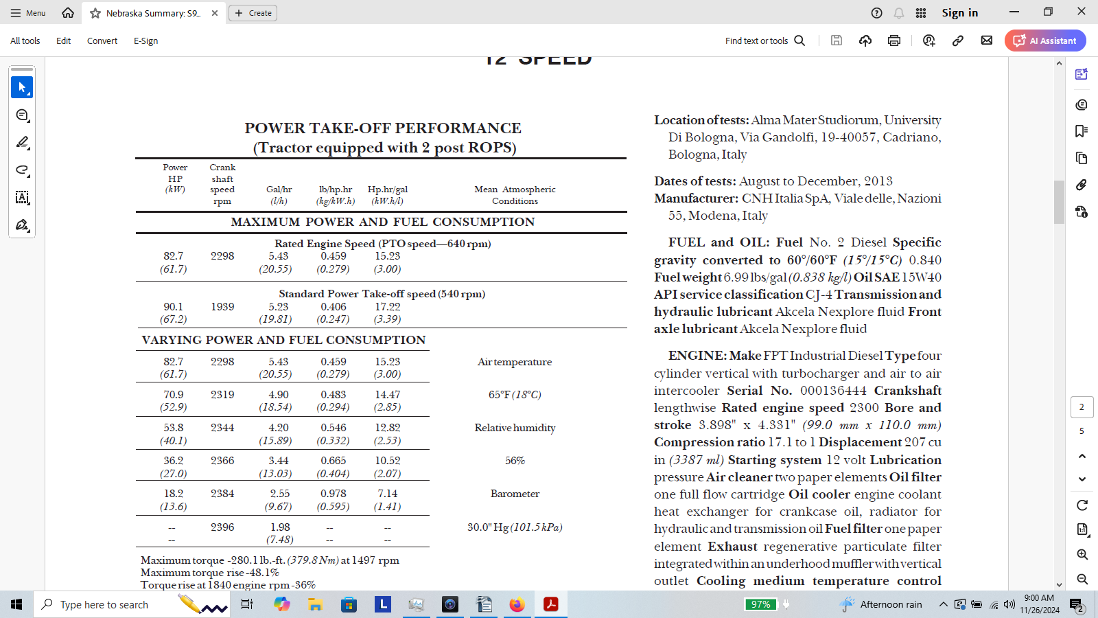

Well a rainy morning so I did a bit of digging, yes 4 gph on an 80 pto hp tractor would be good, I should have said much over 5 gph.
This a NH T4-95 fuel and hp data table.
As far as I know Nebraska only test USA made tractors over 40 hp, I have never seen a Nebraska test on a Korean tractor.
