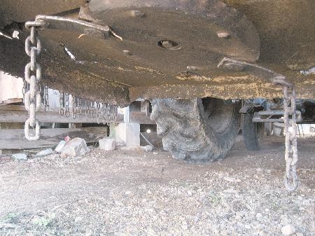

I lived in the high desert for 20 yrs. Half of that time I had MF 30 for road maintenance. You can't mow rocky acreage without first removing the rocks. That is a tall order. I know, I just did that to 5 acres next door so I could keep it cut for an absent neighbor. The alternative is to create fire breaks.
   / Desert grassland - clearing rocks and maintaining dirt drive
Does the chain flail not throw rocks like a blade? I don't recognize the item you're dragging behind in the picture.

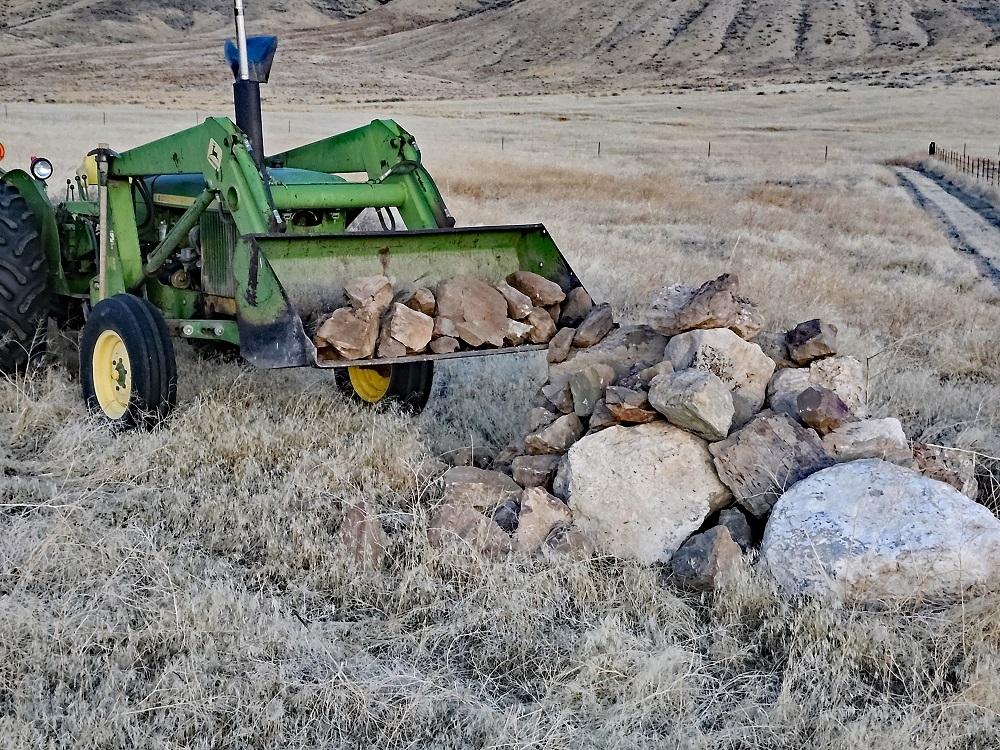

   / Desert grassland - clearing rocks and maintaining dirt drive #4
Good luck! I've been living on the same place here in Nevada for the past 30 years. Every year I'm pulling more mower-destroying rocks out of the ground. It is a never-ending process.

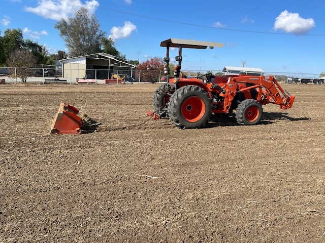

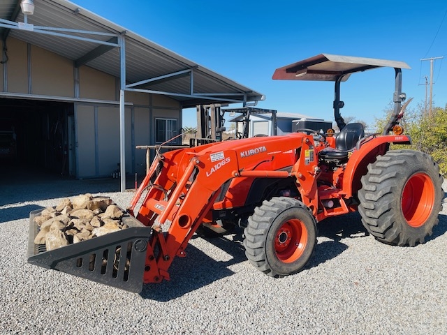

What attachment(s) are you using to pull and/or rake the rocks?

Get a decent dump trailer and to pull with your tractor and hire some help to pick the rocks.

Heavy box blade to crown your driveway so it doesn't wash out, and you also could use it to find the high rocks by just skimming the ground with it. If I find a big rock I just hook it out with one of the scarifiers leaving most of the grass undamaged.
