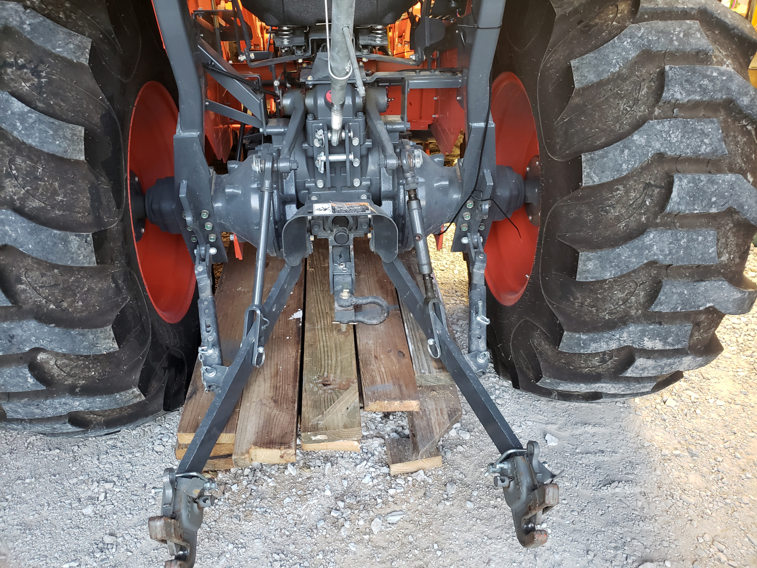

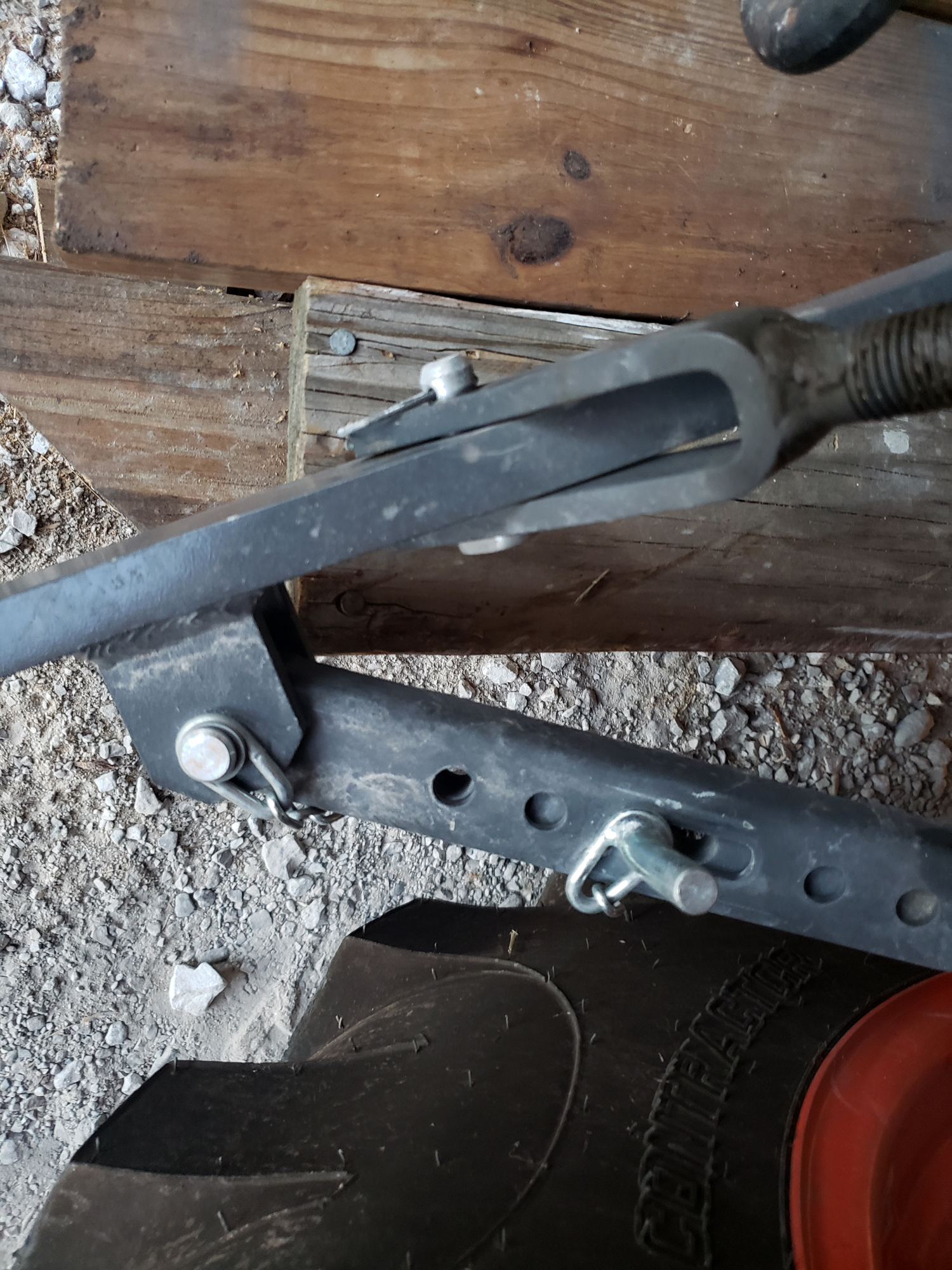

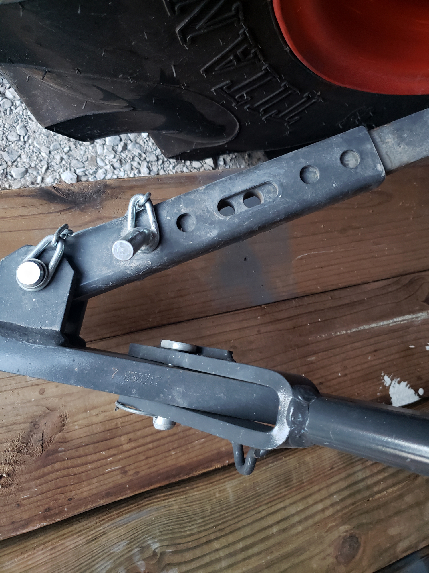

A couple of pictures of the 3 pt lift arms might be helpful. But regardless of the reason. If the lift arms are rubbing the tires, OPERATING it like that is NOT an option.. Might even be dangerous. Unless I misunderstand, I would not operate with 3 pt lift arms rubbing tires. And you mentioned using a box blade. It it is a LP 1272, it weights 404 pounds. (a light implement) But that weight flopping around with arms hitting the tires. Something needs to be changed so you can operate safely. Best Wishes, Larry
/ kubota L3901 use #22
L3901 owner here. Adjust the sway links. I’m old school and preferred the turnbuckle type. All kubota have whines. I have 135 hours in in 8 months and have only had a regen of the dpf 2 times first at 61 hours and the second at about 125 I run wide open all the time and don’t use it for 5 minutes and shut it down that’s what plugs up the dpf
