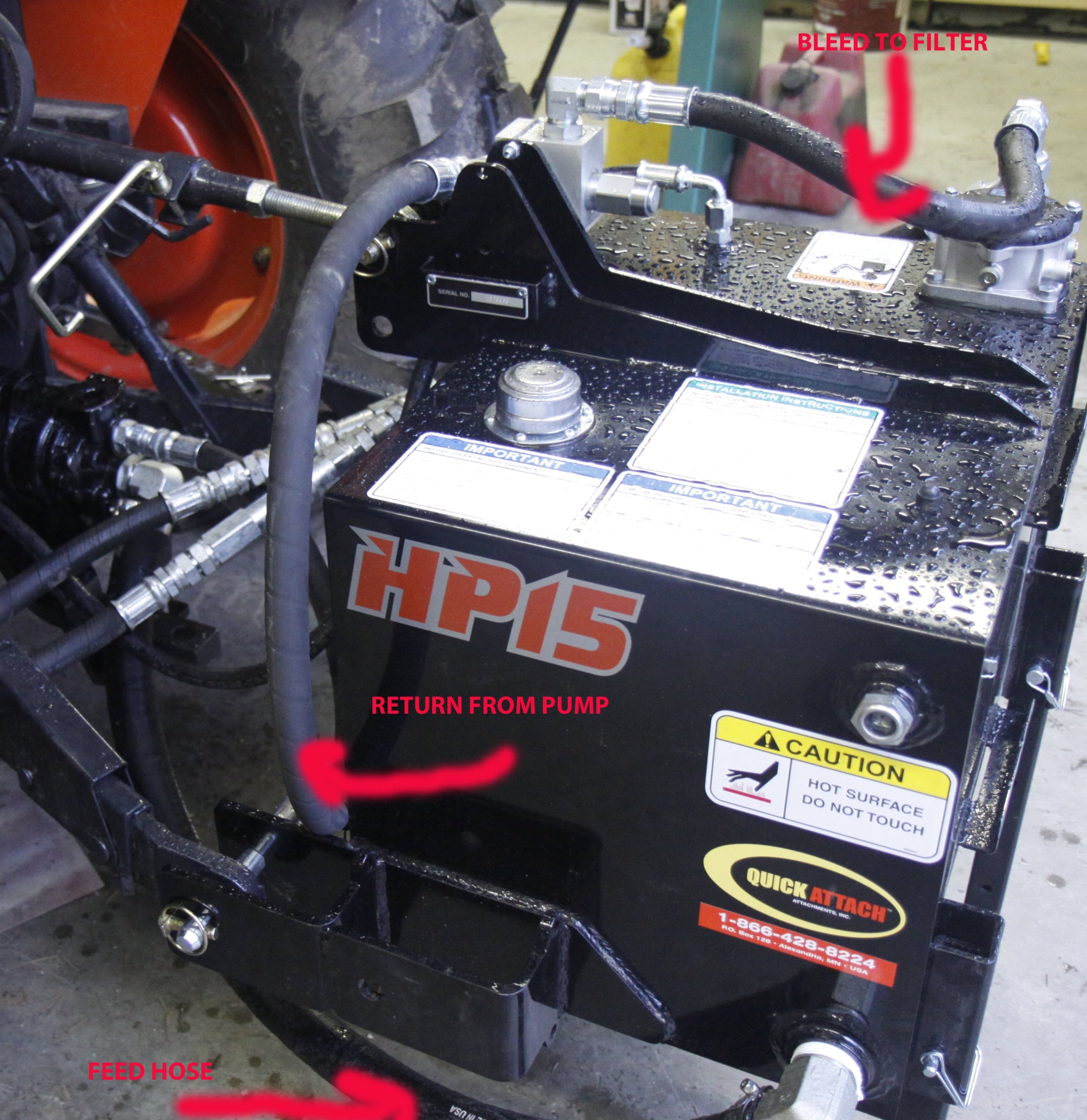

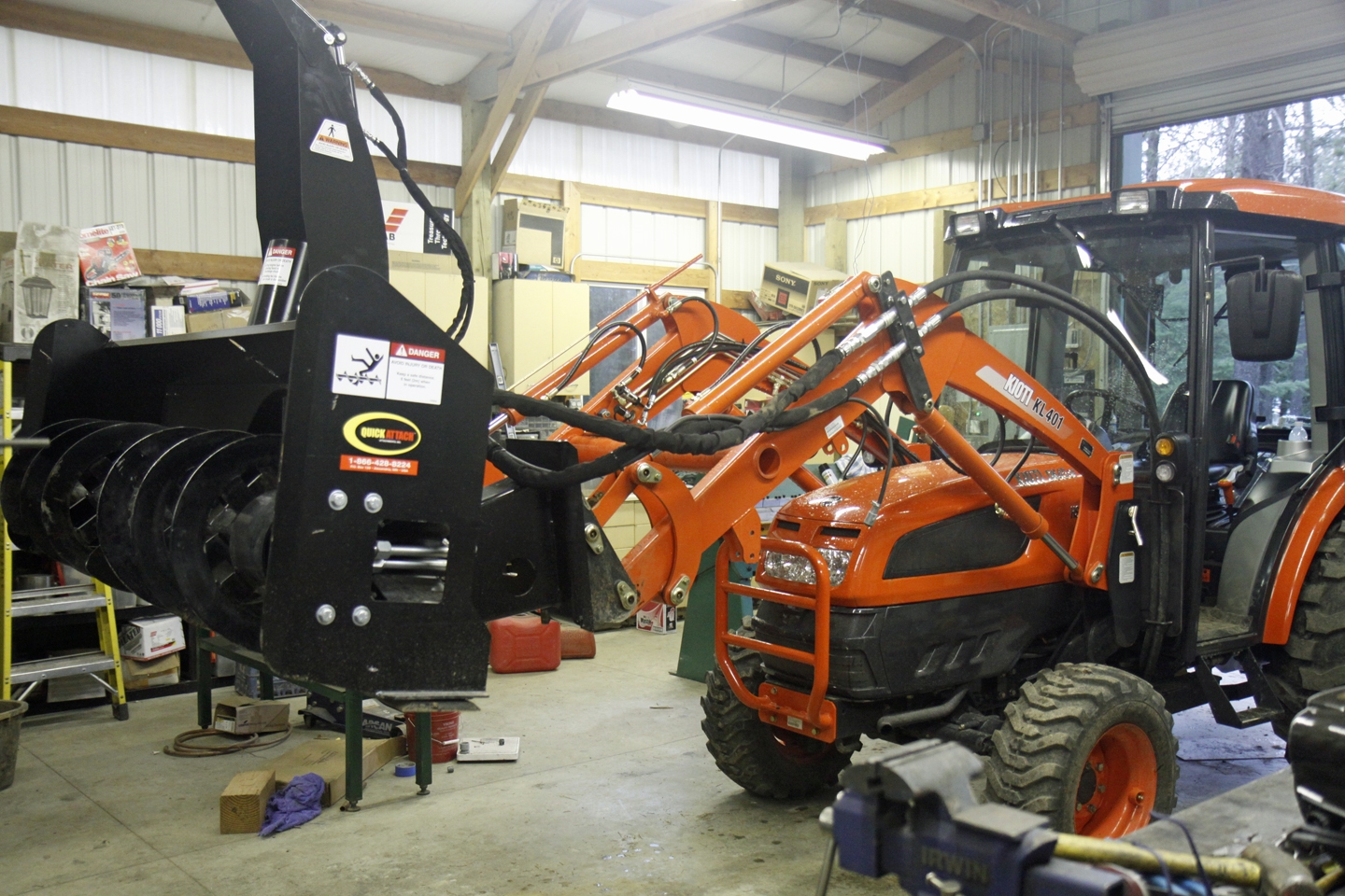

Problem is the flow and the pressure . That port is for things like blades, grapples, etc. A blower takes a lot more pressure and flow, and needs a reservoir to help keep fluid cool, as it really heats up. I would not want that hot fluid running thru my tractor hydraulics.
my rear mount hydraulic tank holds 25 gallons of fluid separate from tractor system. It runs at 3,000 psi vs tractors 2,000 psi. Mine runs at 15 gpm but I only have a 45 hp tractor. it also uses 1" diameter hoses for increase flow. For a 60 hp tractor they recommend 24 gpm @3,000 psi for the size blower you need.
they also recommend a hydraulic cooler circuit, but i never needed it because i monitor my tank temp and it’s never gotten into danger zone. Mind you if I used system in summer to power things like brooms or front augers, I’d need the cooler.
other option. Do they offer a front pto option on your tractor? Than you could use a frame mount unit. Lose use of loader and harder to install in winter, but cheaper.

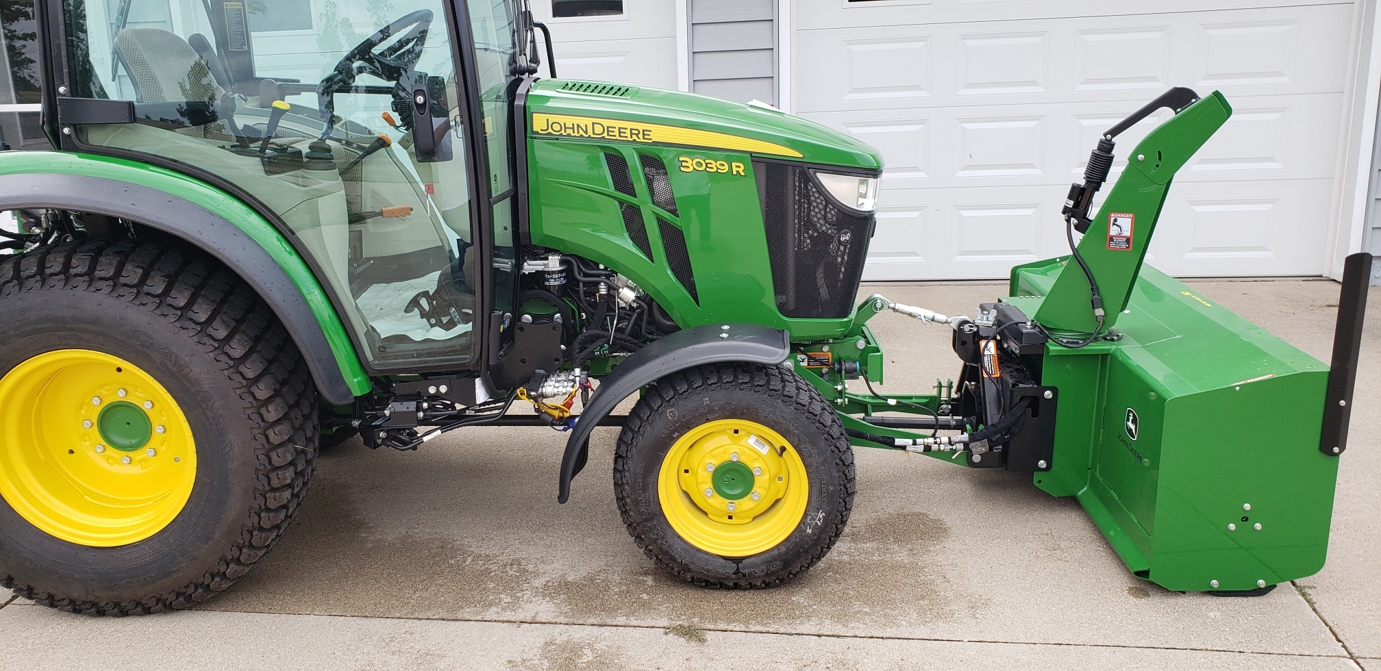

I have 31 pto hp powering a 24" tall by 60" wide snowblower. It does great until I get to the wind-packed 24" deep drift. It might be 40 foot long and that is when I wish I would have bought the next bigger sized tractor.
Front mount is the way to go. (y)
