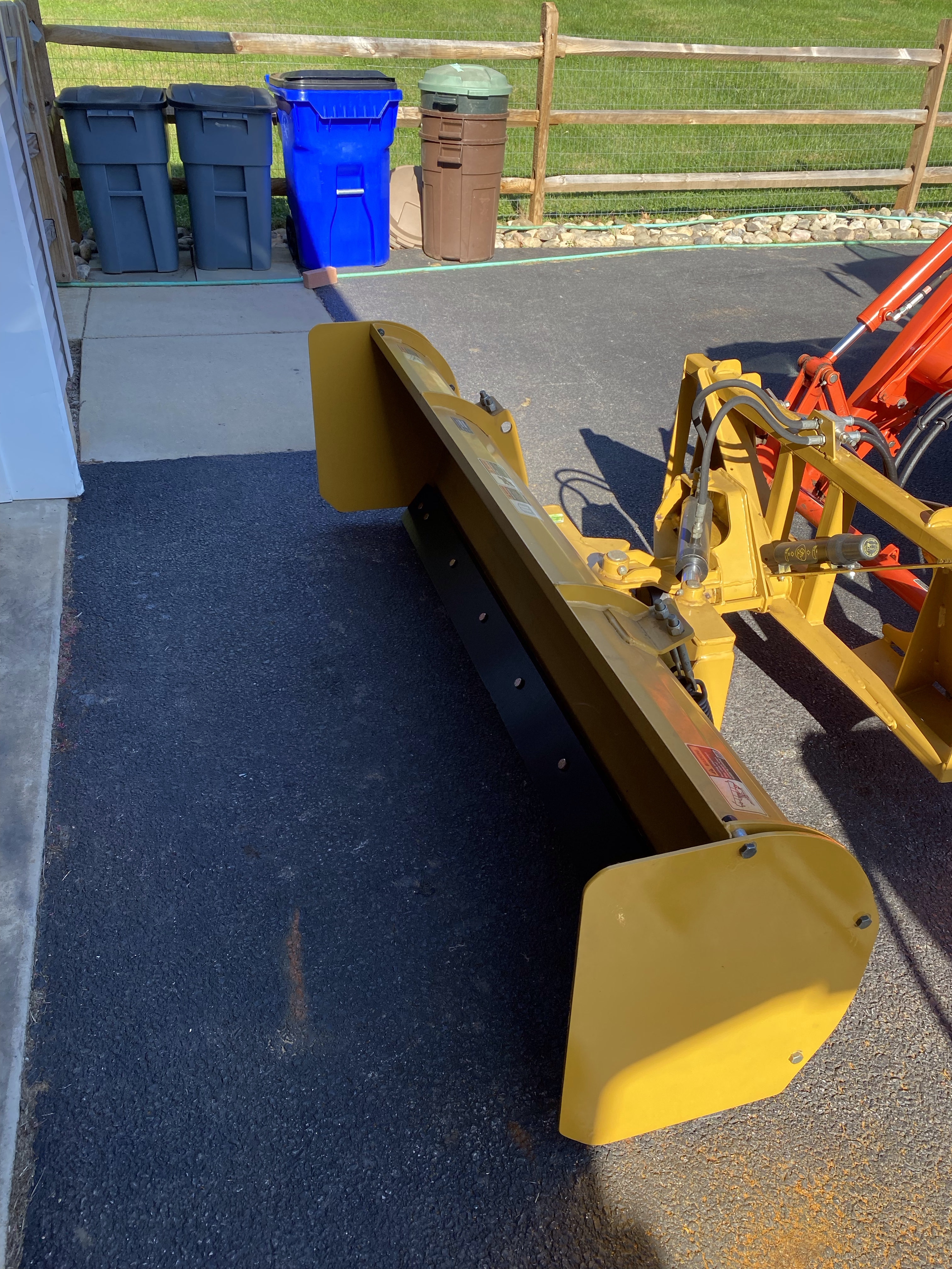

I plow with an HLA 2000 7' SSQA blade, and it works great. I do around 15-20 long residential drives in my immediate area.
I can see both sides of the blade from the cab, and it's on the heavy side at 535 lbs. It scrapes packed snow as good as any other blade will, plus I can put the tractor weight on it if necessary. It gets a little squirrelly when the front end weight is on the blade though... no traction / steering.
I run it 99% of the time with an UHMW Polyethylene edge and fabricated side wings.

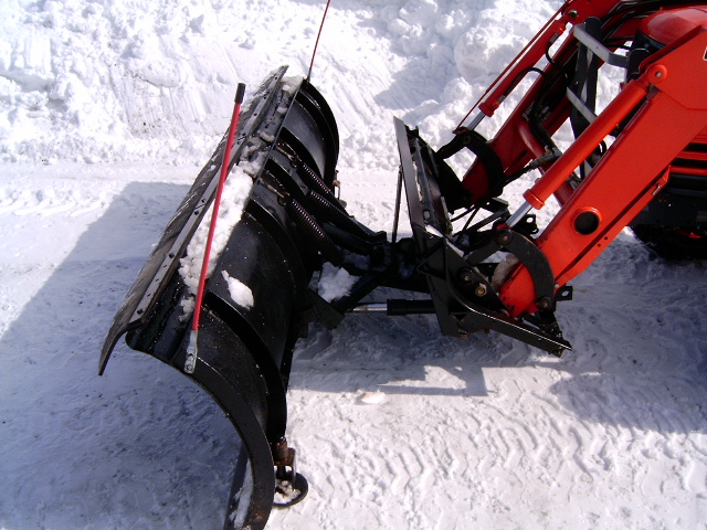

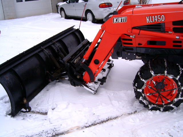

I've been running a loader mounted snow plow on my tractor for decades
I have power angle, but no tilt function.

Wouldn't "TILT" be rolling the SSQA plate back and forth with the loader curl function? That changes the angle-of-attack slightly of your blade.
/ SSQA Snow/dirt plow blades #14
The original poster mentioned he want a tilt function, I can only assume he meant side to side tilt.
That was my take also, but I wasn't sure what the term would be. My blade "tilts" left and right a few inches, but not operator controlled. It follows the contour.
