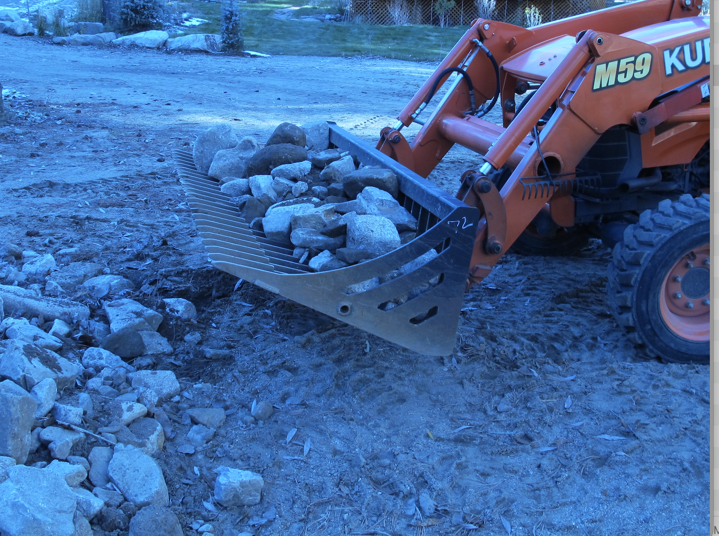

With the box blade and ripper, you have half the implements you need on your TLB.
The other tool is a rock bucket to pick up the rocks and leave the dirt behind.
Get one the same width as your dirt bucket, but with long rounded tines in front.
Houle and Bradco make the best ones. They are all SSQA, so will fit your B21 TLB.
You may have to shorten the width.

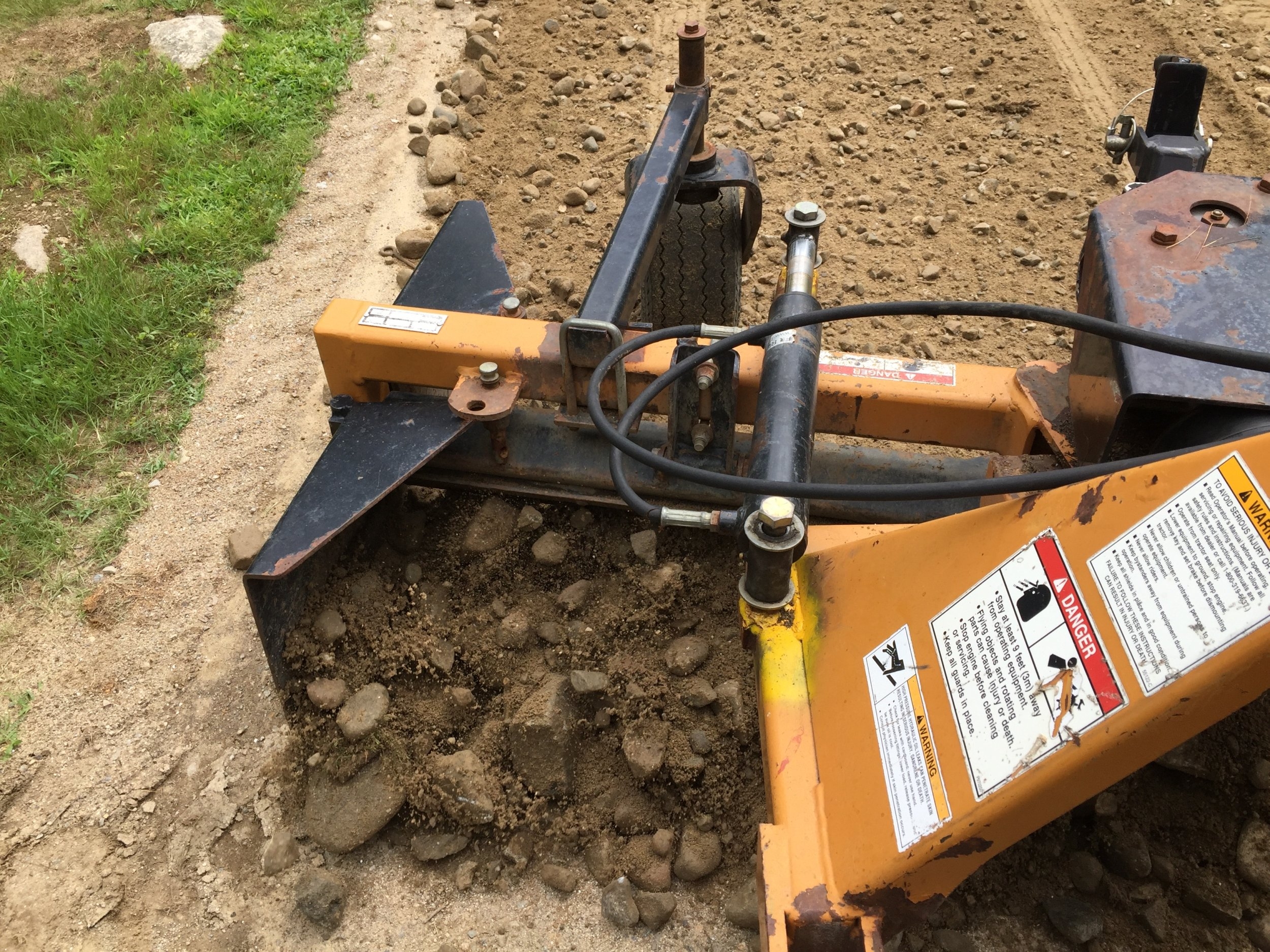

What model box blade do you have?
Do you understand the principle of using the rear blade of your box blade, as a "gauge wheel" and keeping your top link in float?
The rocks will still be a PIA no matter what, but if there is enough dirt to fill the box completely, and then use your rear blade as a gauge wheel of sorts, you should be able to make some progress with the tools you already have.
I know this pic shows smooth dirt and not what you are dealing with, but just an example. In this pic, the box is completely full (even if a lot of rocks pile up). If you can keep it full, the weight and amount of dirt in there will help the box blade leave a smoother finish. In this pic, my top link is in float, and I adjust the “cut” of the front blade simply by raising/lowering the 3 point hitch in small amounts. This will open up (or close) a small gap under the front blade, allowing only the fines to filter underneath the front blade, while the rear blade packs it down and rides on a level surface.
Using the top link in float like this will solve 90% of your problems related to pitching motion of the box blade when your tractor goes over a bunch of bumps/dips.
It's a Woods BSS54.
"Top link in Float" threw me for a moment as I know of no specific control for that. But apparently in this case it is just fully lowering the implement, so it "floats". Makes sense?
Keeping the box "full-ish" works well also when dealing with "looser-er" material. But hitting rocks, root remains, or old stumps is a near constant issue. There seem to be an unending supply of those. Will experiement a bit more trying to dig deeper. But, I am limited by traction and horsepower. And Cojones, maybe.

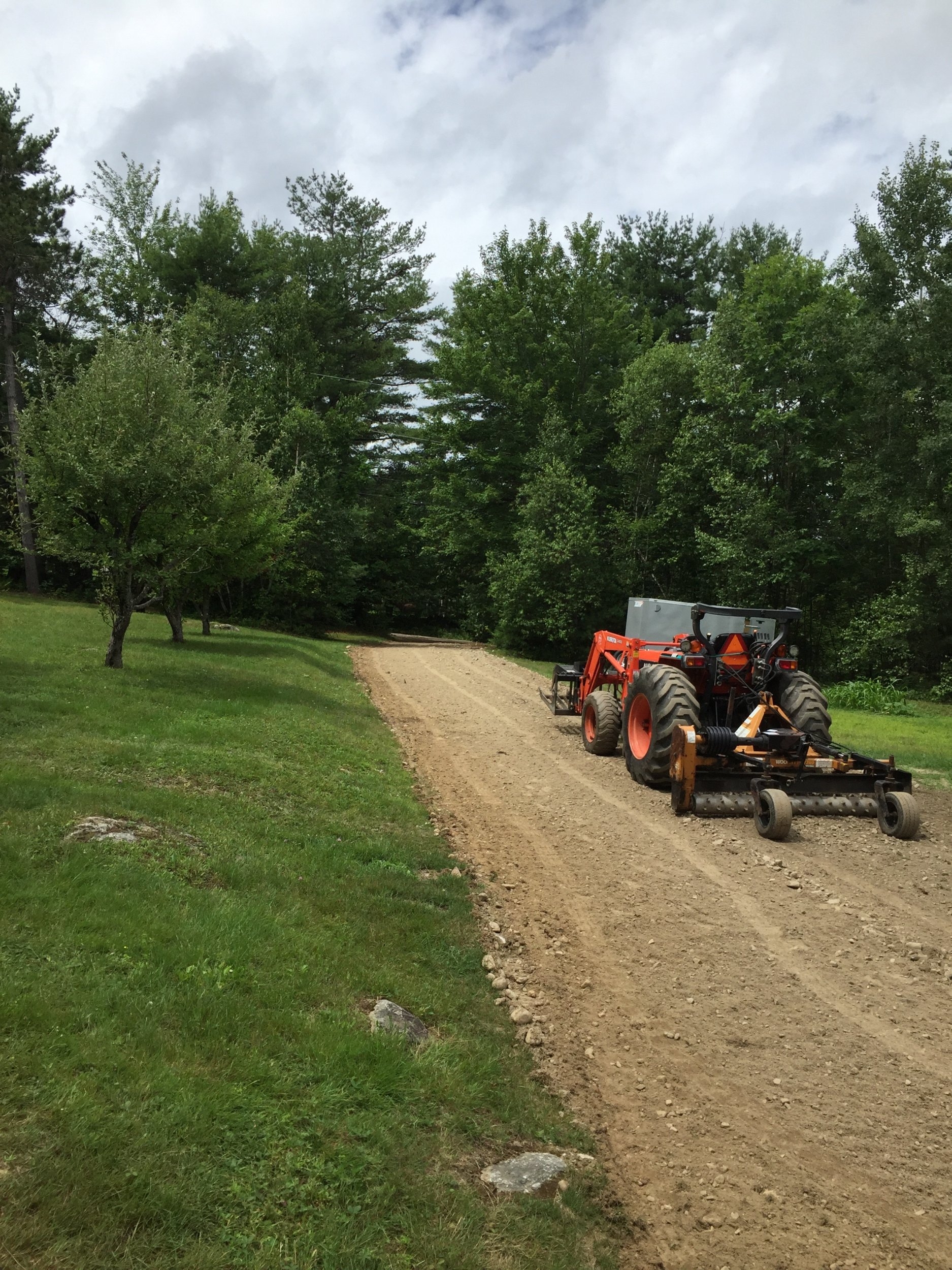

I have rocky clay and sandy soil depending upon the location... but lots of rocks. I reclaimed the neighbors field last year to make it suitable for mowing.
The rocks in these soils are in endless supply. Sinking rippers in is just asking for more rock to come up. What is done is done.
So now you have lots of rocks 3-12 inches. You are going to have to hand pick and load the big ones. Then you can start raking the 6" minus rocks into rows by angling the rake and going kinda slow. This is called windrowing. You can keep pushing the windrow until it gets too big and then just start fresh and begin another row. I would not use gauge wheels but a steady hand on the top and tilt to see what works best. Don't try to get all done in one pass. When you get the majority of rocks gathered, I use a rock bucket to collect windrows. Do it again, and again if needed. Take your time its a big job
That's what I have been learning. And now I know at least one definition of "windrowring".
Cute what you did with the angle control of your rake. I can control that manually.
Been hand picking the bigger ones. I can use the workout.
Going slowly is the most difficult part for me. "Relaxing while working" has not been my forte. But, I can be trained. Eventually.

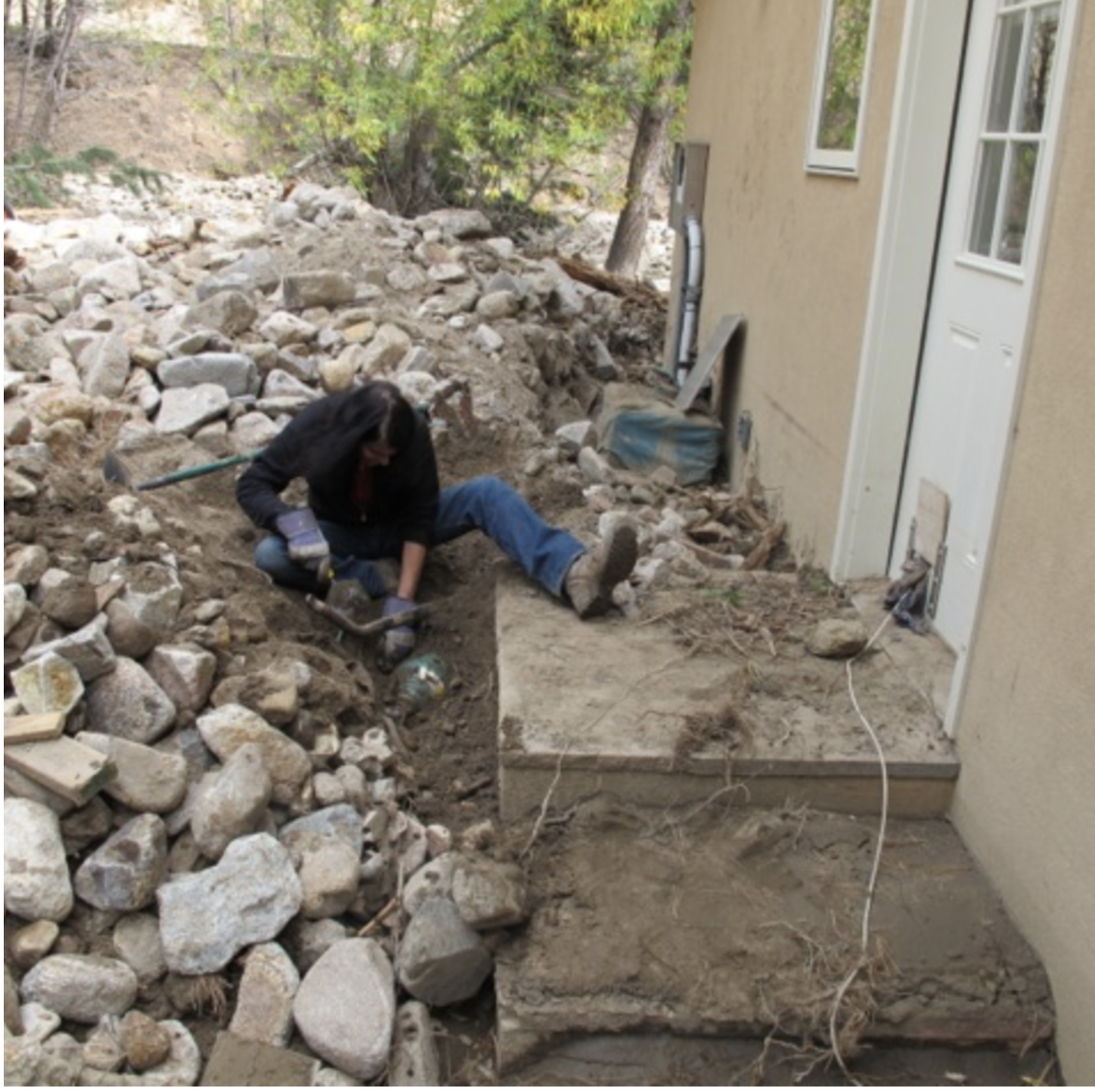

Wow. What a mess. Hopefully you have some soil beneath those rocks.
If you look real closely at the photo you can see what we thought was soil between some rocks and on the steps. At least in my ignorance I thought it was usable soil, but it turns out to be a mixture of sand and powdered rock. Now I see in that old photo that the rocks are so clean and smooth I know now that I should have figured out what I was looking at... but I didn't at the time.
The washed sand and rock dust is worse than complely sterile. Even after the rocks were removed and topsoil plus fertilizer mixed in, that rock dust "soil" just does not grow anything well. Not yet...and it's been ten years.
BTW, can you see what she is digging up? It's our oxy/acetylene torch set....
rScotty
Wow, what a job. Do you live in Thompson Canyon? I remember some bad floods there about 12 years ago.
