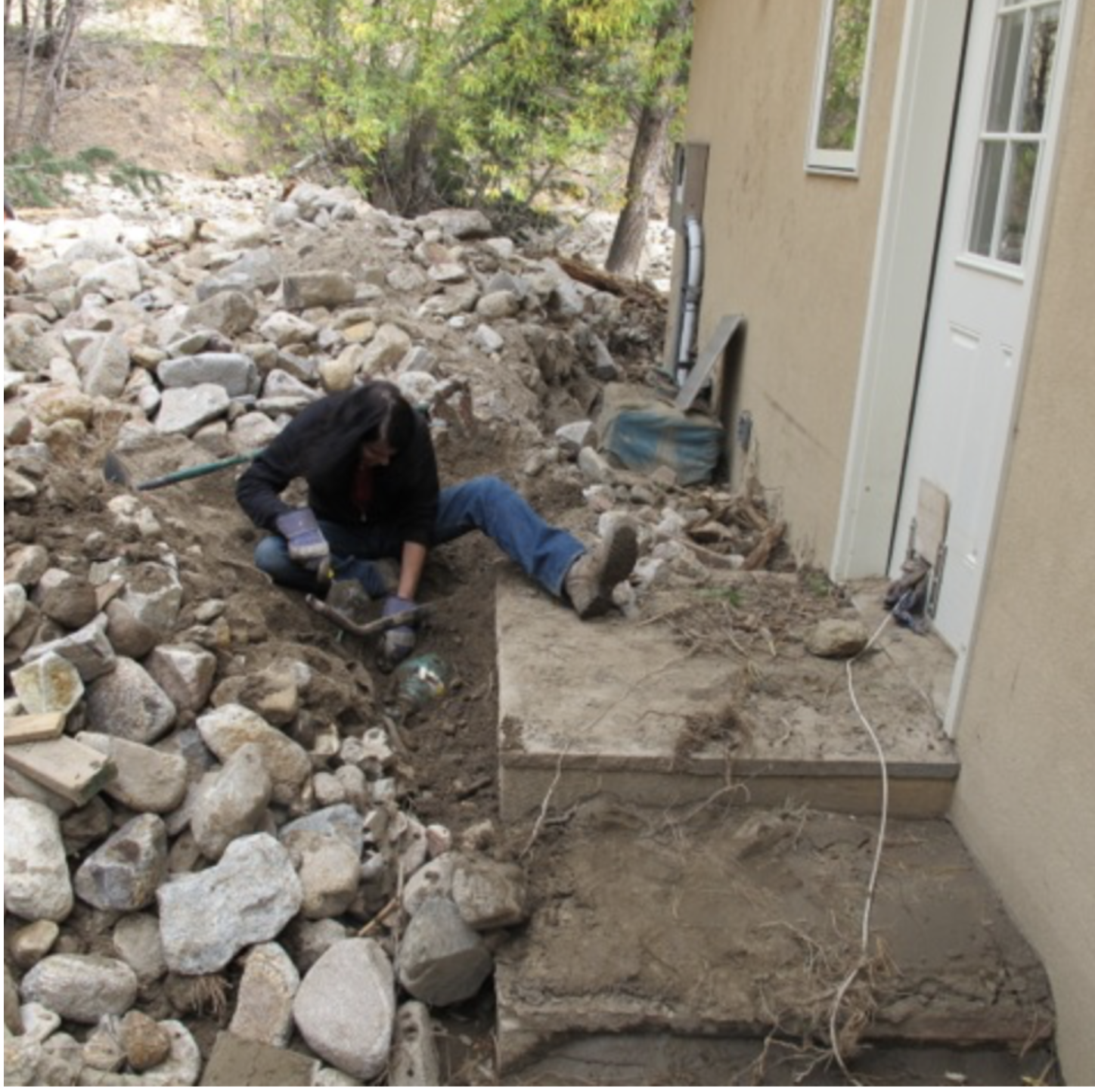

If you look real closely at the photo you can see what we thought was soil between some rocks and on the steps. At least in my ignorance I thought it was usable soil, but it turns out to be a mixture of sand and powdered rock. Now I see in that old photo that the rocks are so clean and smooth I know now that I should have figured out what I was looking at... but I didn't at the time.
The washed sand and rock dust is worse than complely sterile. Even after the rocks were removed and topsoil plus fertilizer mixed in, that rock dust "soil" just does not grow anything well. Not yet...and it's been ten years.
BTW, can you see what she is digging up? It's our oxy/acetylene torch set....
rScotty
WOW. Flood or "slide"? How did the house make out?
Barn & house did fine. Little damage. Well sealed windows and doors plus a full foundation down into bedrock. It's all typical belt and suspenders overbuilding.
Several houses, one tractor, and a lot of propane tanks bounced off the barn and house as they floated by. We did have to repair some outside trim.

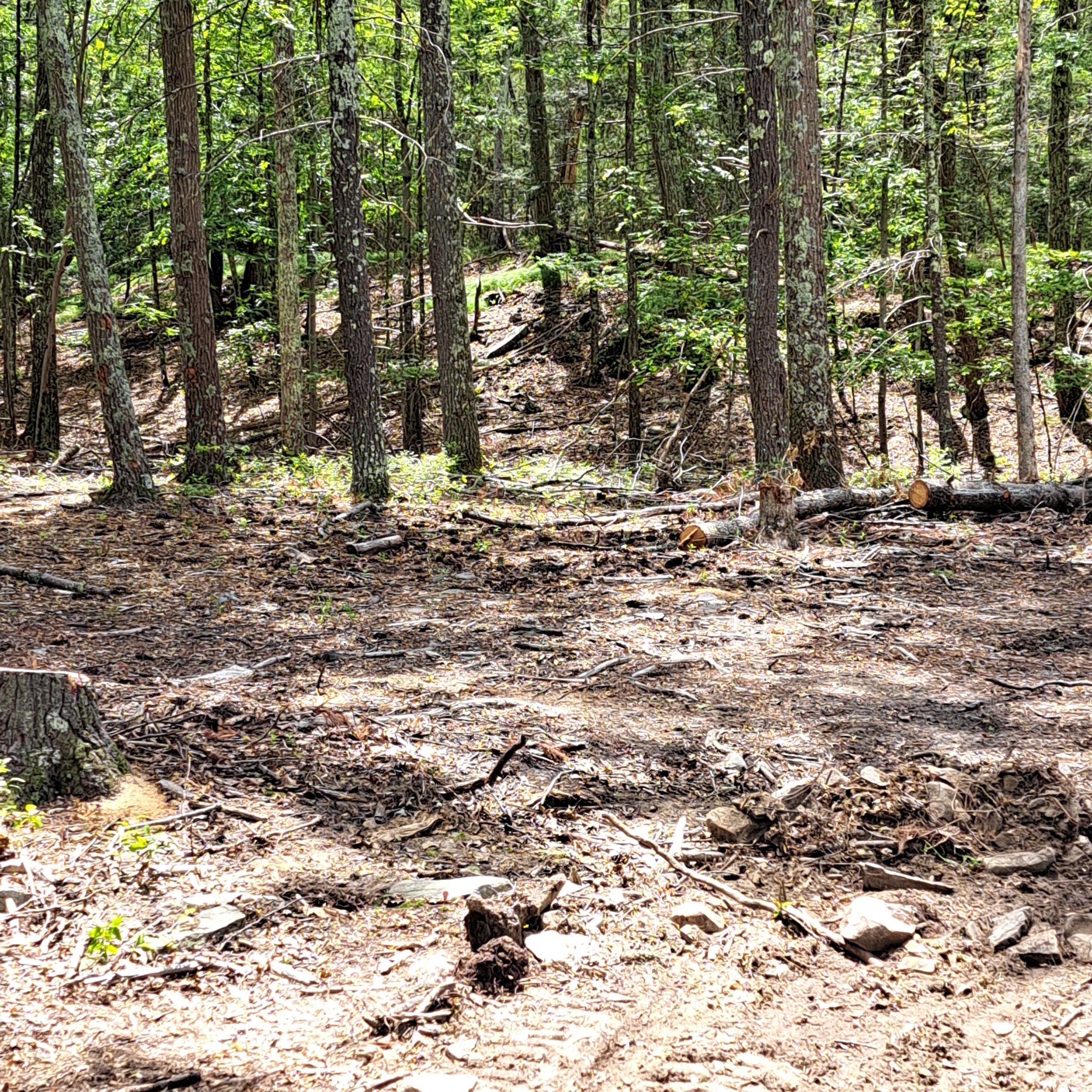

If you mentioned how big an area you're working, I missed it.
Have you tried scooping your 4 in 1 bucket somewhat full of rocks/soil, cracking open the bucket just enough to retain the smallest rocks you want to remove, and rattling the bucket so the dirt falls thru the crack at the bottom? Dry dirt would help.
   / Box Blade and Rock Rake (a.k.a. york rake?) not really doing the job. Operator lacking skills?
#37
Roughly 30 x 60 I guess. For now. Still a lot of trees to clear out.
I did think of that and it might work now that I've torn up enough for it to dry out. But a couple inches down it is still dark and damp. Earlier also mentioned making a "basket" to fit in the bucket, to open it wider.
Pricing SSQA conversion kit and various attachments is bringing me down a bit. But, I have been known to get over sticker shock pretty quickly. But only for toys. Materials still give me neck strain.
Probably a good thing some 90+ weather is forecast this week. That should put a hold on my foolishness and let me rethink things in air conditioned comfort. And total sobriety. Well, that may be optional.

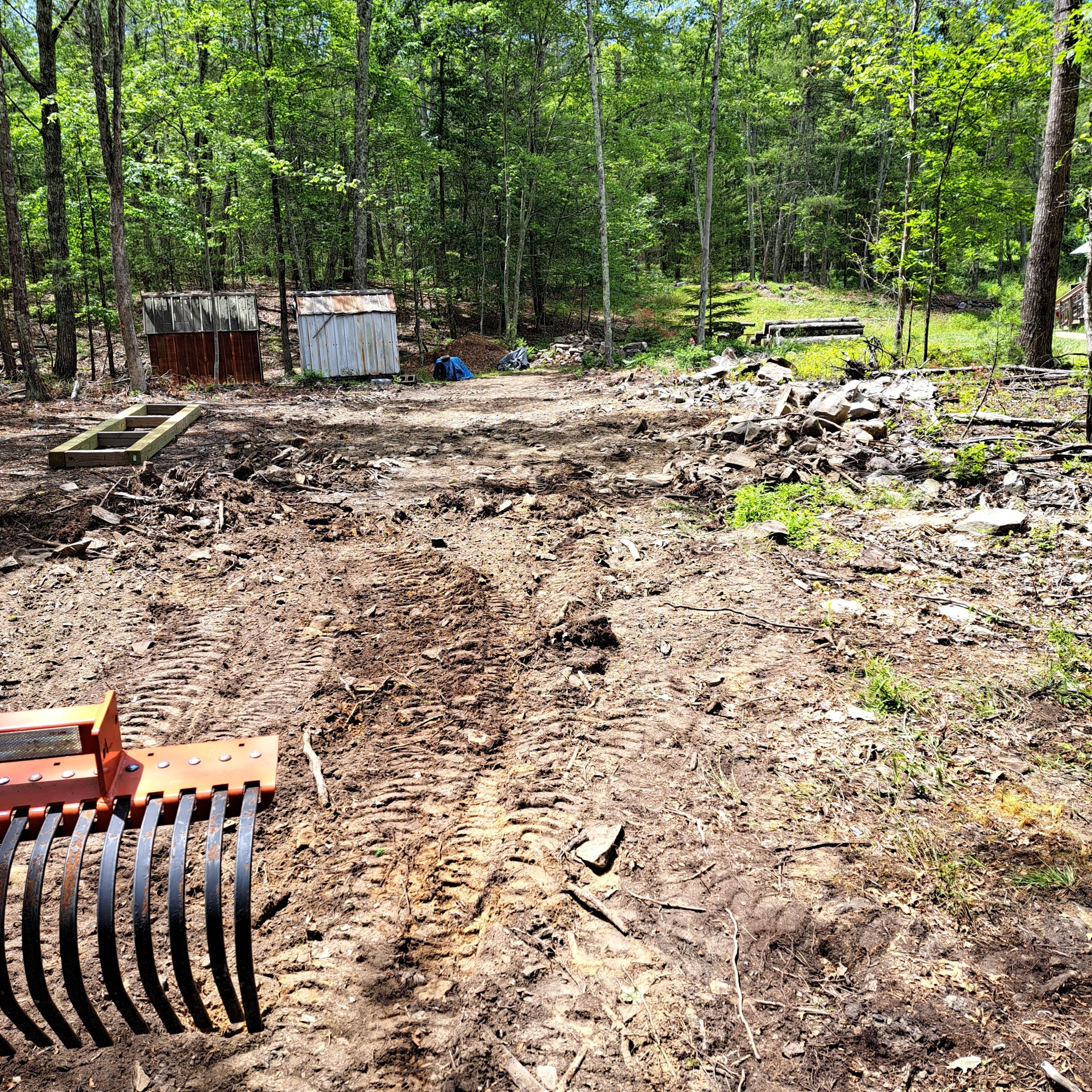

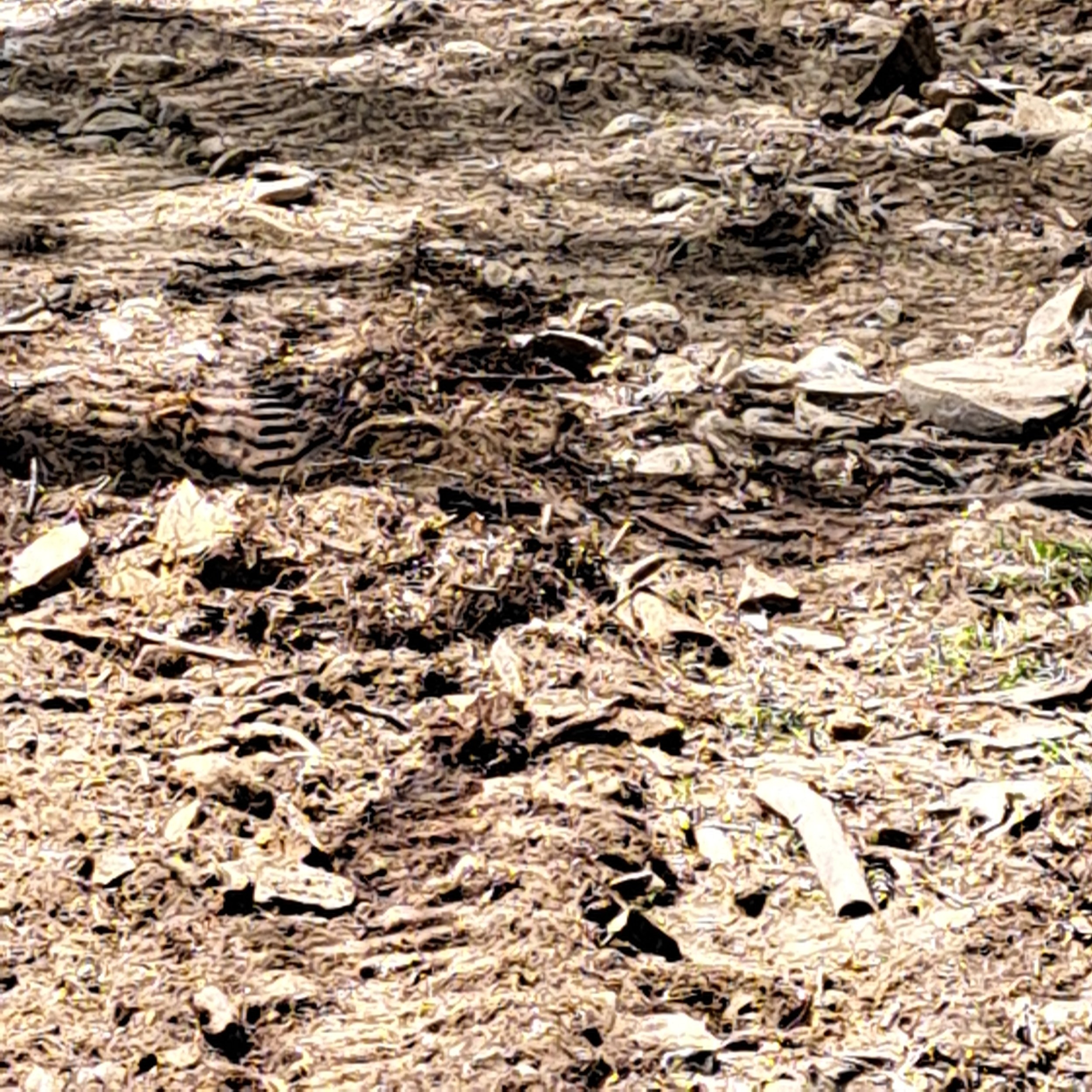

Someone asked for some pictures/

I think you would be amazed at what a power rake could do for you. My local dealership rents them out for $150/day. If you were closer to me I would let you try mine and see for yourself...
Using your front end loader to move the big rocks, and the power rake to move the small rocks, you would likely have a very nice finish in that area.
However, based on your photos, it does "look" like repetitive passes with you landscape rake could give you acceptable results. Pictures may not be doing it justice however, so it's easy for me to say as an armchair expert!
